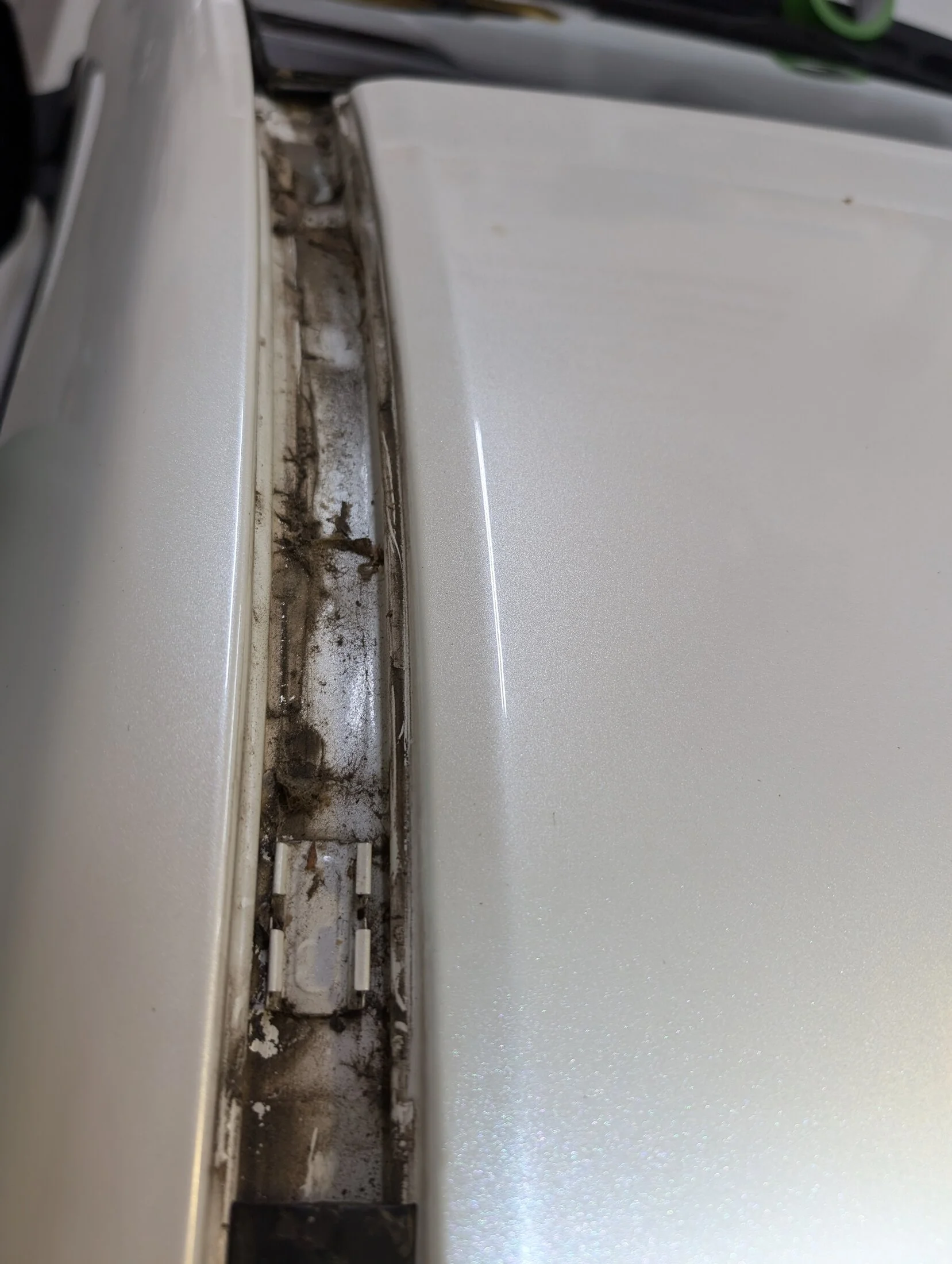

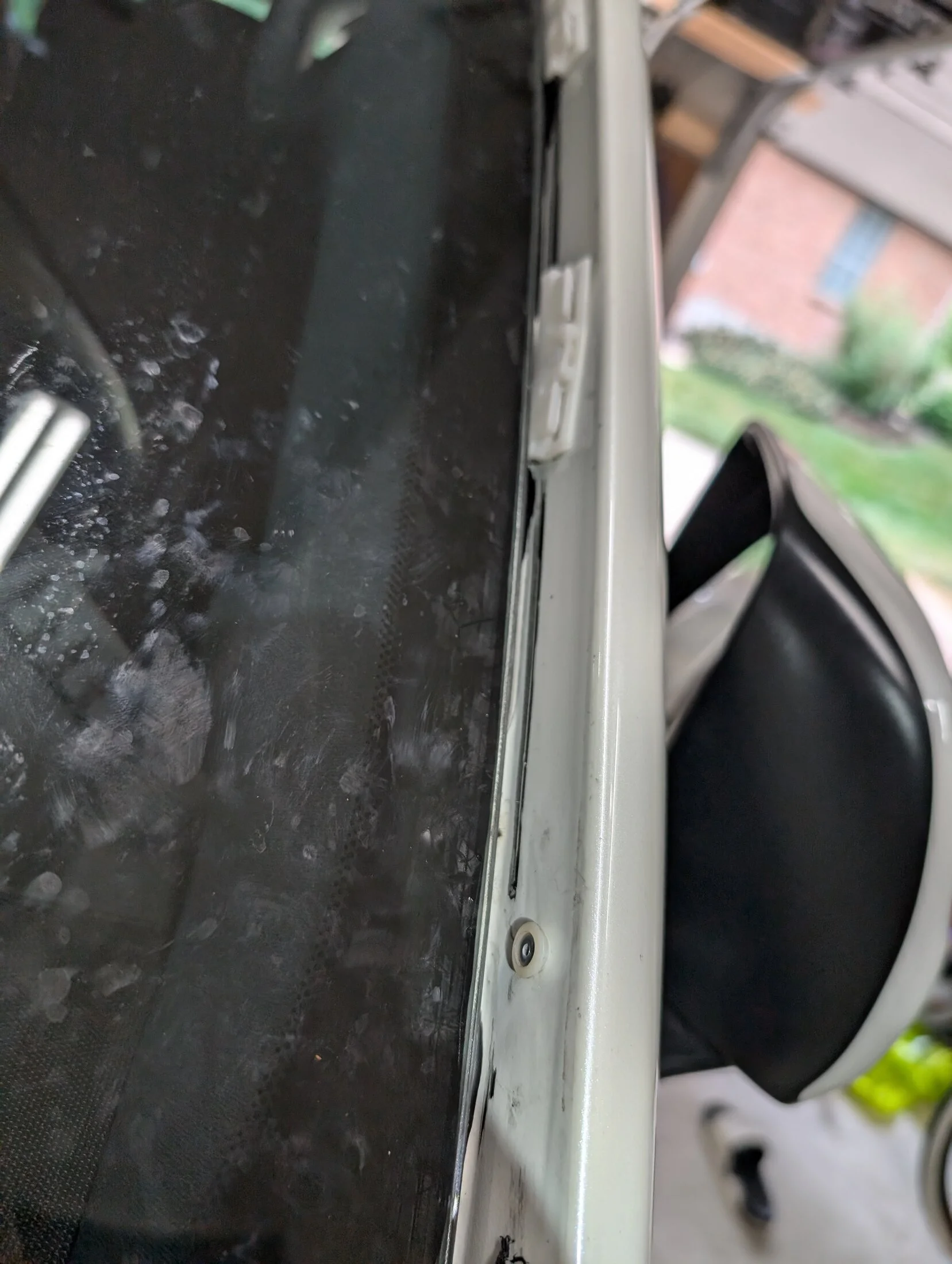

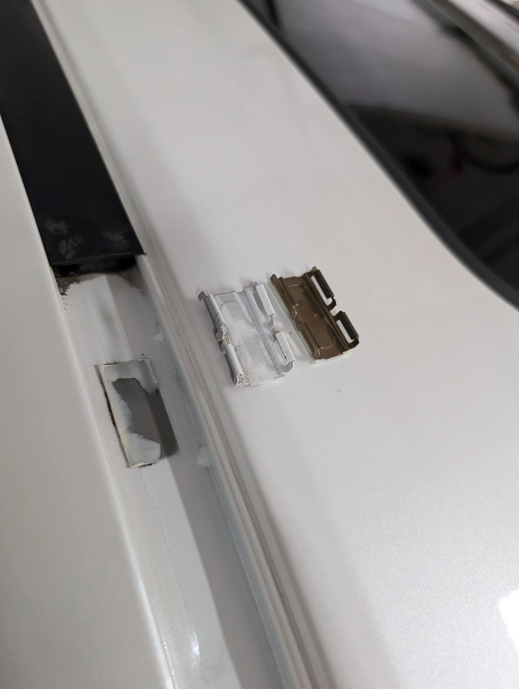

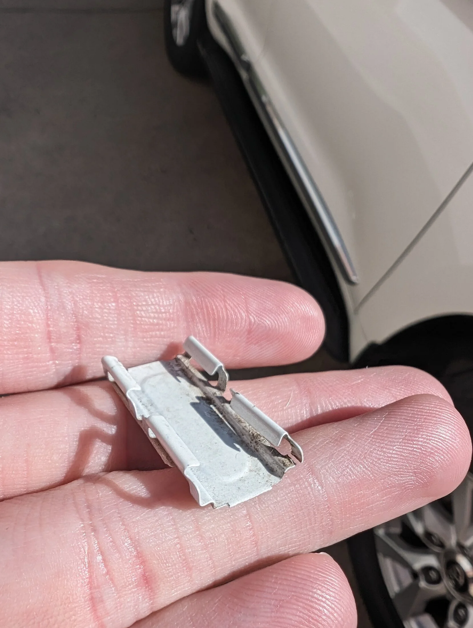

Attached are pix of the mangled clips, previously glued to body channel then painted over. There's now a nice unpainted area where the clips had pulled up and were barely holding on to the weatherstripping.

That's a broken clip. I saw bent clips but not a broken one. Needs new clip and the special glue. Or better the job redone. Who knows what else was not done right.
Truck looks good. Fix it and enjoy it!
Most installers will put urethane under that clip. FSM specifies a flexible epoxy. I may have put the brand I used in that old post, but whether I used it is holding up very well six years later.
Each side molding piece is held on by 4 plastic clips and 2 metal clips. ALL clips, and the side molding, are intended to be one time use. However, these pieces are all commonly reused which isn't always ideal as you are experiencing.
I wouldn't freak out about broken clips or mangled molding. Just fix/replace and you'll be all good.

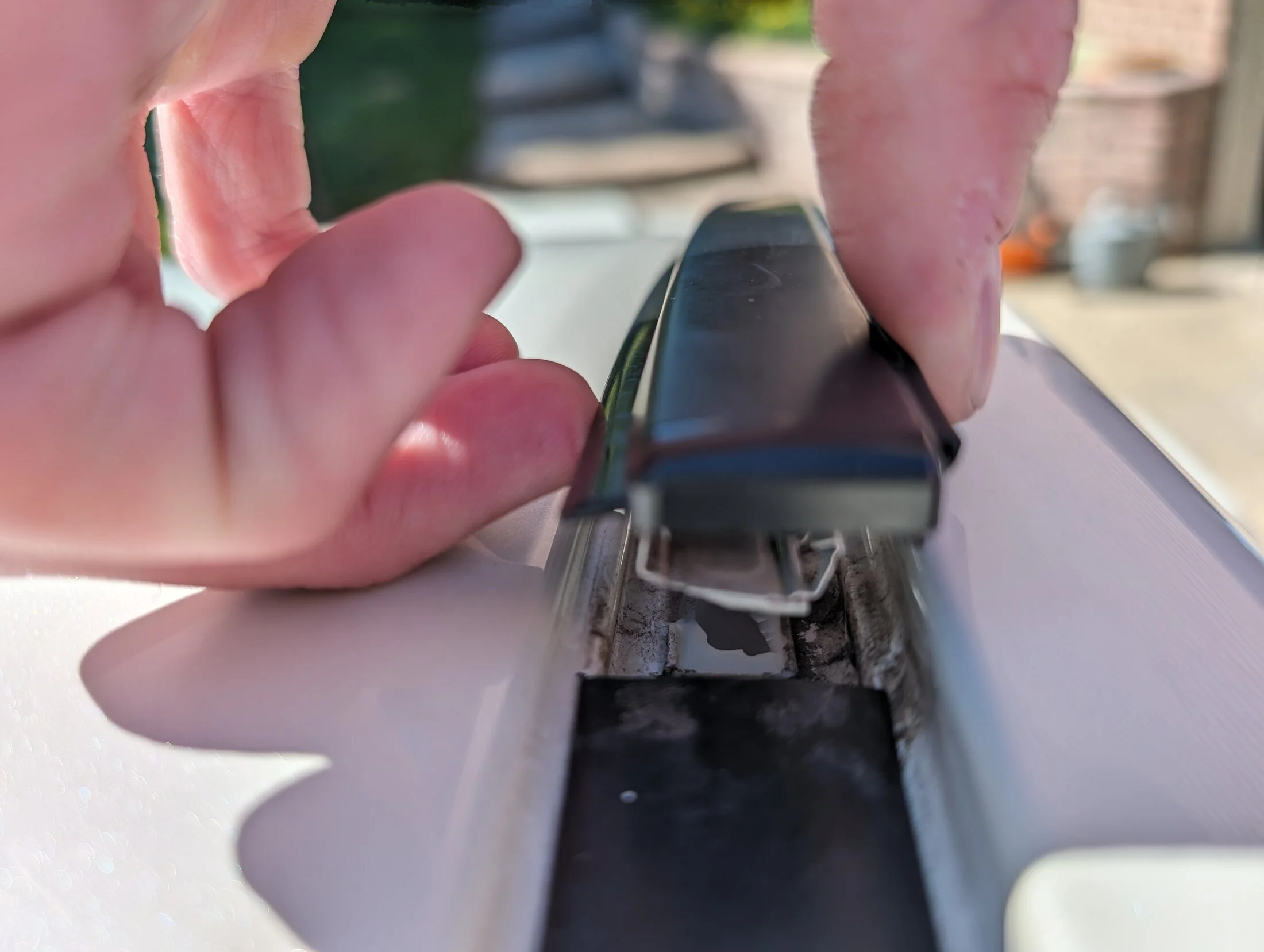

As a quick follow up, I went ahead and replaced all the clips and weatherstripping. Turned out perfect. The stripping sits exactly as it should and makes nice uniform contact with the glass.
I used a flexible epoxy from total boat for the metal clips. Might be the same that @bloc used in the past. Also, on the metal clips know they are directional. They have a faint arrow pressed into them, arrow faces forward.
Only tricky part is getting the white plastic clips off their studs. You DO NOT want to break these studs so be careful there.
