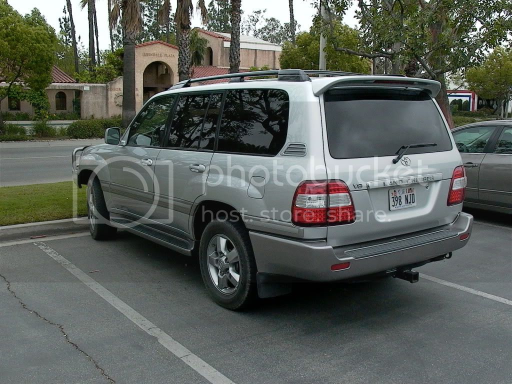

Just picked this up last week from a LC enthusiast (3 Cruisers) in Salt Lake & drove it home (Pasadena). $24k for 95k miles & all dealer service records (meticulous). Absolutely love it. I previously owned a 82 FJ40 when I was working as a construction diver down in Houston in the early '90s, but this is an entirely different beast altogether. Previous owner had the ARB put on after an unfortunate deer collision, and the body shop did a great job matching the paint to trim (and he did the wheels as well). This is going to be a family expedition type vehicle in addition to an almost-daily driver. Previous vehicle to this was a 2009 Mercedes GL320, and to be honest I thought I would be stepping down in ride quality & fit (getting rid of the MBZ b/c depreciation moving forward is about $1k/month, its been in the shop 5x in the last month with suspension & electrical issues, and I'm not about to drop $5k on an extended warranty....and I can sell it for almost 2x what I paid for the '06 LC), but not the case. Coming back from SLC put the ride setting on Comfort & it was awesome. I make the LA-SLC-LA trip often, and the MBZ ride is harsh compared to the LC (and the MBZ has the air suspension). The only thing that sucks vs the MBZ is the gas mileage---averaged 13.8 coming back from SLC, averaging 80 mph (lead foot, I know).
Upcoming mods, all thanks to Mud forum (where I'm spending way too much time learning): interior LEDs ordered. Rear hatch LEDs ordered. Front ARB recovery tabs received. White Knuckle full DOM sliders in hand & getting powder coated next week (along with the stock 18" wheels (which were painted to match bumper by body shop); going a dark graphite to keep the colors in the gray family. Working on rear bumper & rack options as have some ideas/needs that are going to require some custom work as with family of 4 + 2x130lb dogs, all gear needs to go on outside. Headrest DVDs for the kids, and Sirrus integrated into the factory system next on the list.
Thanks to everyone on the forum for sharing of knowledge to this point--hope I can contribute as well.

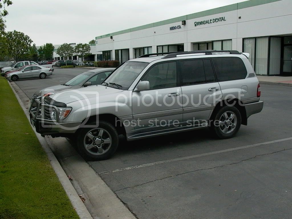

The bumper is right up against the quarter panel......should there be a gap there, and if so, how much? Willit rust without the gap?
Truck looks great! IIRC, ARB calls for a minimum of 1/2 inch between bumper and fender. I have just a tad more to be safe. The gap is meant to protect your fender. The bumper will flex and move slightly and without that gap, something has to give.
Thanks for the info. Ill get adjusted.
I would do it sooner than later. There is a large amount of flex between the sheet metal and the bumper even when hitting a pothole. It would be a shame to knock those pretty fenders out of alignment just because you waited on adjusting a few bumper bolts.
What are your next mods going to be?
Having it done tomorrow at the local ARB shop.
