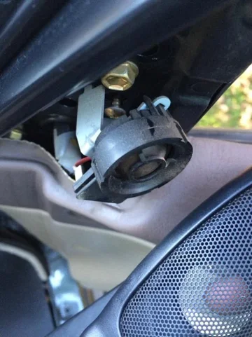

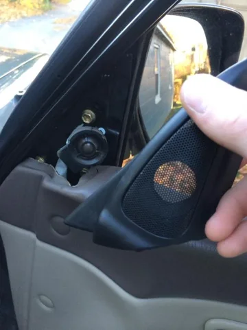

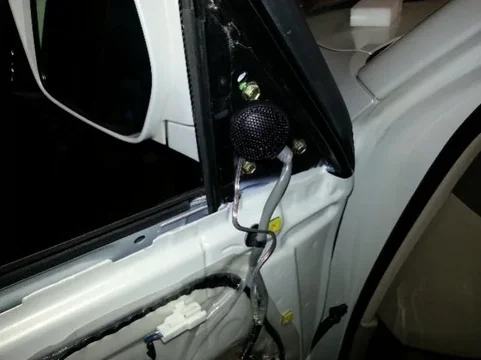

1" will fit. Not sure if it's standard for all tweeters, but my RE tweeter has a screw hole in the middle of the back on it. I drilled out the center of the stock bracket and screwed them in place after ditching all of the mounting accessories that came with...
