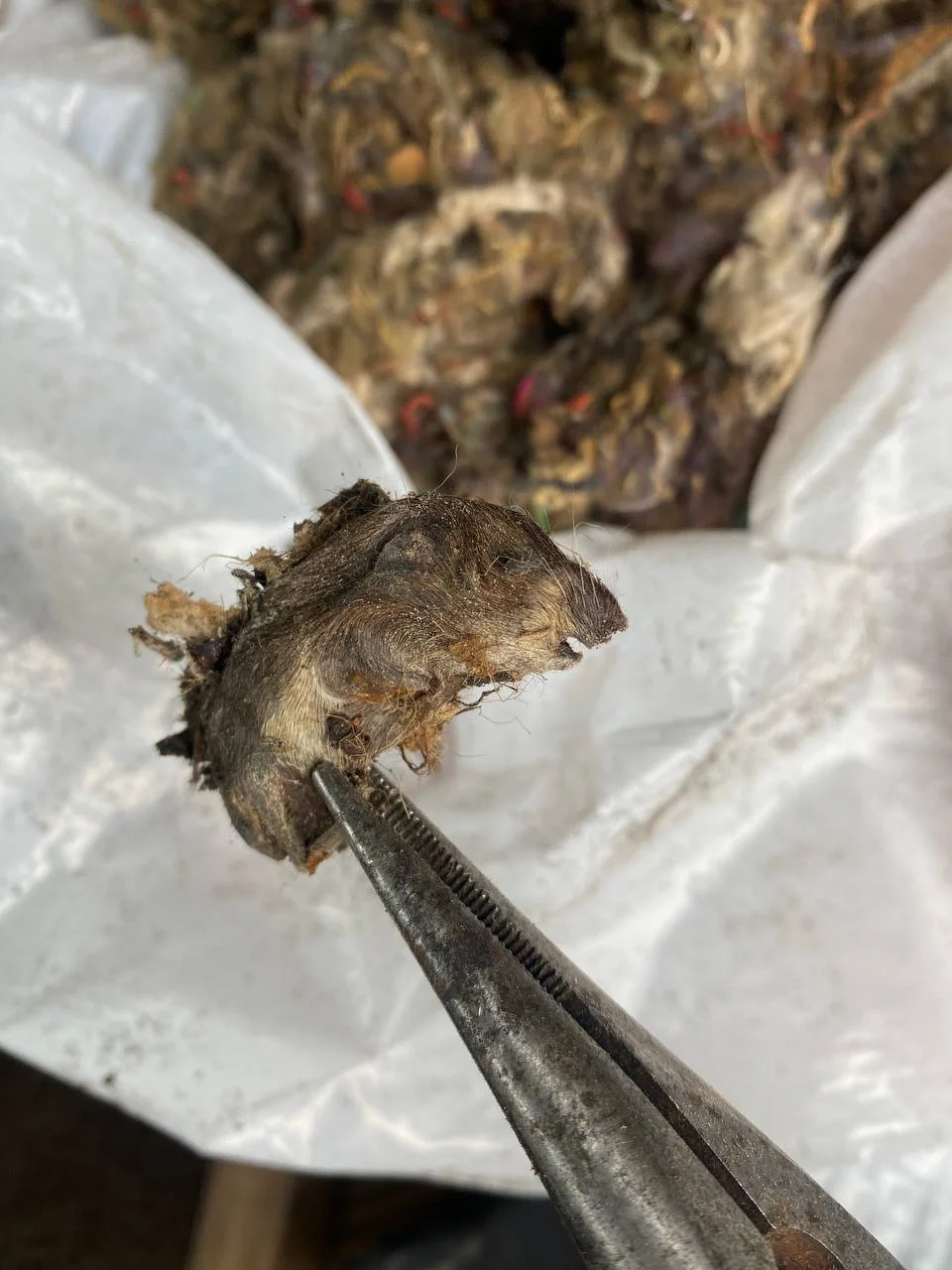

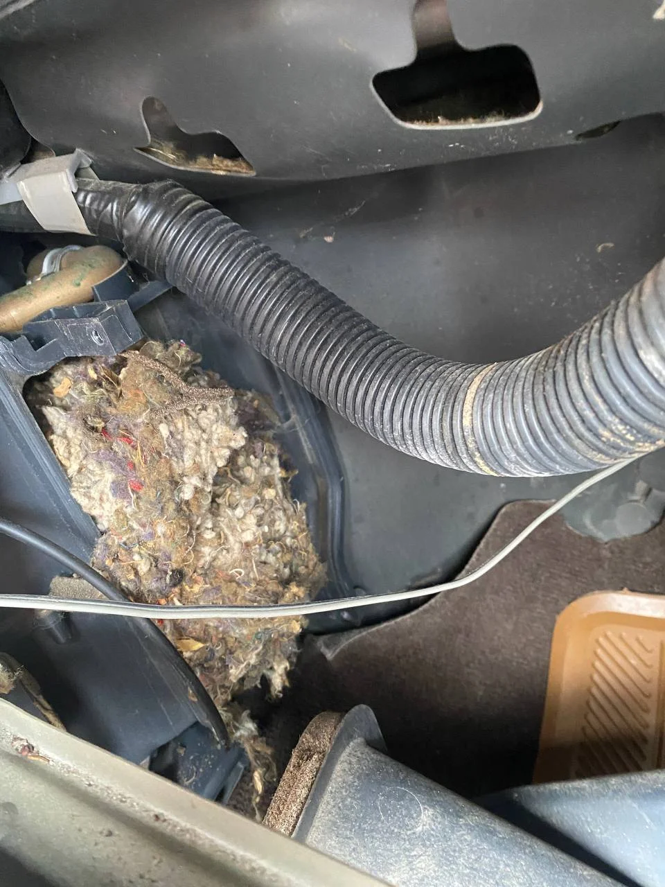

By the way, today I evicted two "tenants" from the air duct. Looks like someone had made a cozy nest in there.
