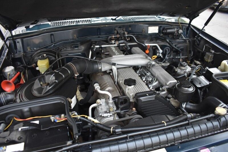

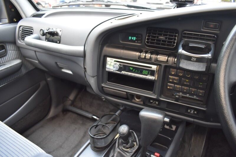

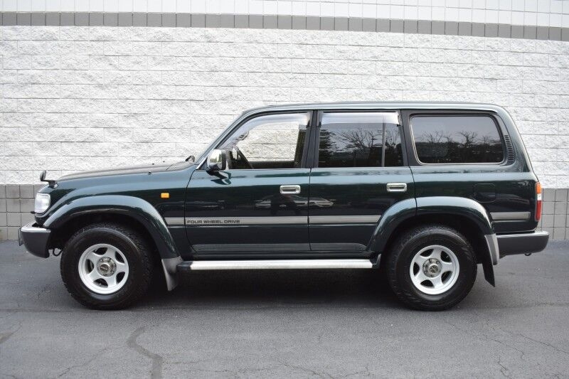

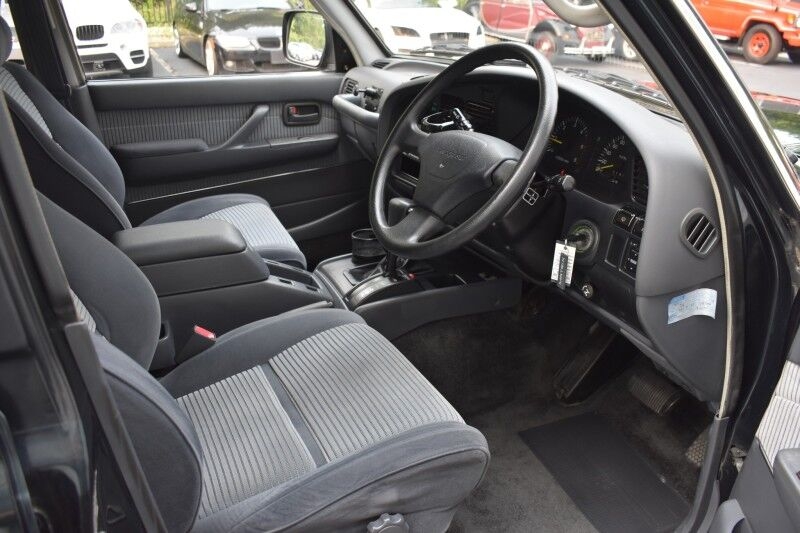

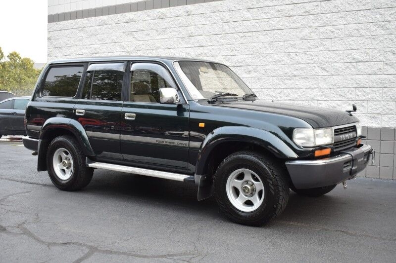

Thanks for the input. I agree - I appreciate the simplicity of the 1HZ which is what really drew me to this vehicle. I've attached a few pics so if anything jumps out at you please don't hesitate to give a shout.

I’ve never seen that passenger foot rest (?) before. Hard to really tell from the pics, it’s obviously been cleaned and shined. The frame looks good and it doesn’t look like it’s been painted to hide anything. Some of the clamps inside the engine bay look original and rusted. That may indicate much of your rubber will need to be replaced as PM.

Thanks for taking a look! I definitely plan to replace all rubber, fluids, and filters as well as the timing belt first thing

Looks great. If the steering box is not leaking I would say tie rod ends? IHZ is a brilliant motor for your intentions and you can often get 400,000kms out of them and more. Keep it stock and have a look at the suspension and full service. When you bash your front bumper replace it with something more sturdy.
