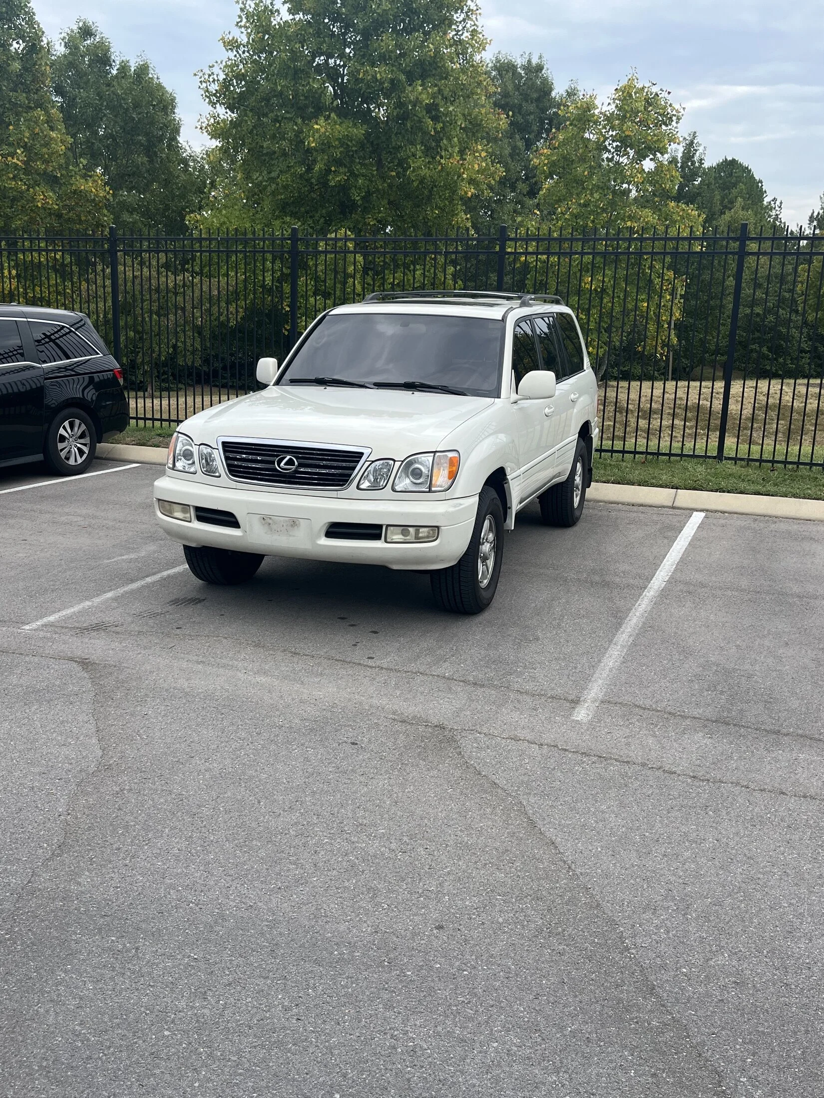

Anyway, thanks everyone, I’ve really enjoyed learning a bunch throughout the process. Here’s the rig. Needs bigger tires I know.
