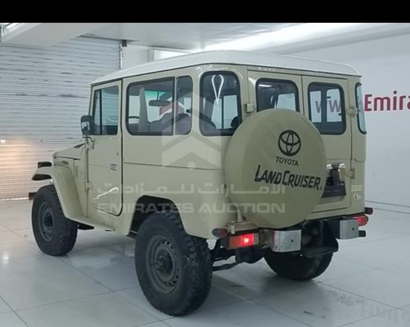

I just won an FJ40 at auction here in Dubai and it's my first. Ive been a series Land Rover man in the past but am keen to work on a Toyota for the first time.
This on is an ex-Saudi vehicle. 1983 by vin number and it's a non-runner. (On inspection the HT leads are completely melted for a start). It turns over fine though.
400k on the clocks so may actually be a genuine kilometres reading?
AC, heater and power steering fitted (OEM??? Not sure yet)
The previous owner has painted it nicely outside but there is rust lurking beneath
I call it a Sheep in Wolf's clothing...

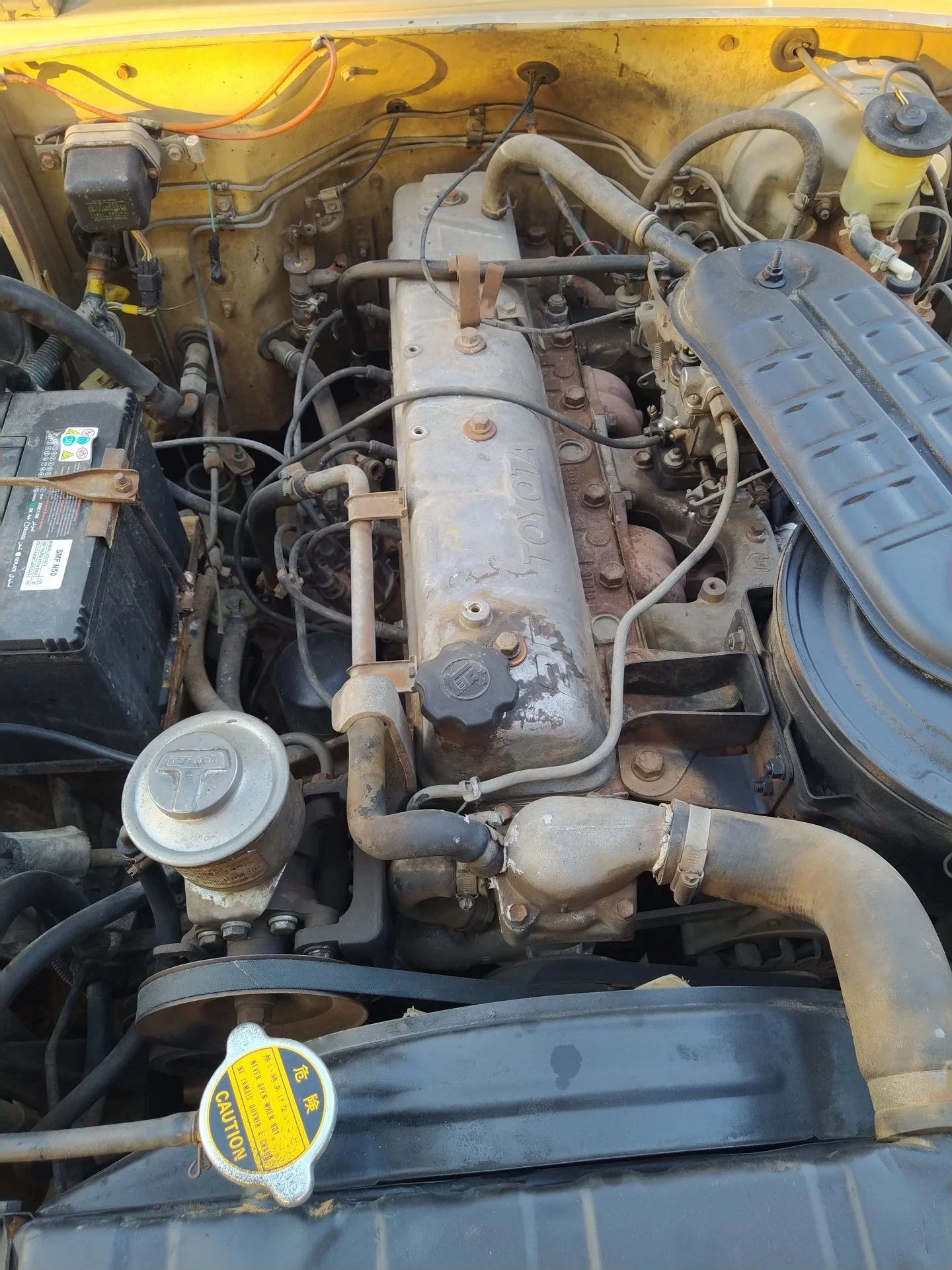

Yes, my first Toyota haha. I intend to do as you suggest and just get her running and drive her for a few months to figure out what I'm dealing with. Right now I've got a new coil and HT leads on order which 'should' sort out the ignition issue. I'm changing all the fluids in the meantime. Rusty water in the radiator, fuel in the sump (at least I know it's getting fuel!) and black goo in the clutch and brake reservoirs...
Interesting that it's a 4 speed. Maybe North America got the 5 speed in 83?
Jan 17, 2022
10
UAE
Well, I got her 'alive' this evening. New HT cables and a points clean up were all it took. Also chucked a little fuel into the carb to help her clear her throat!
Rough but alive!!!
