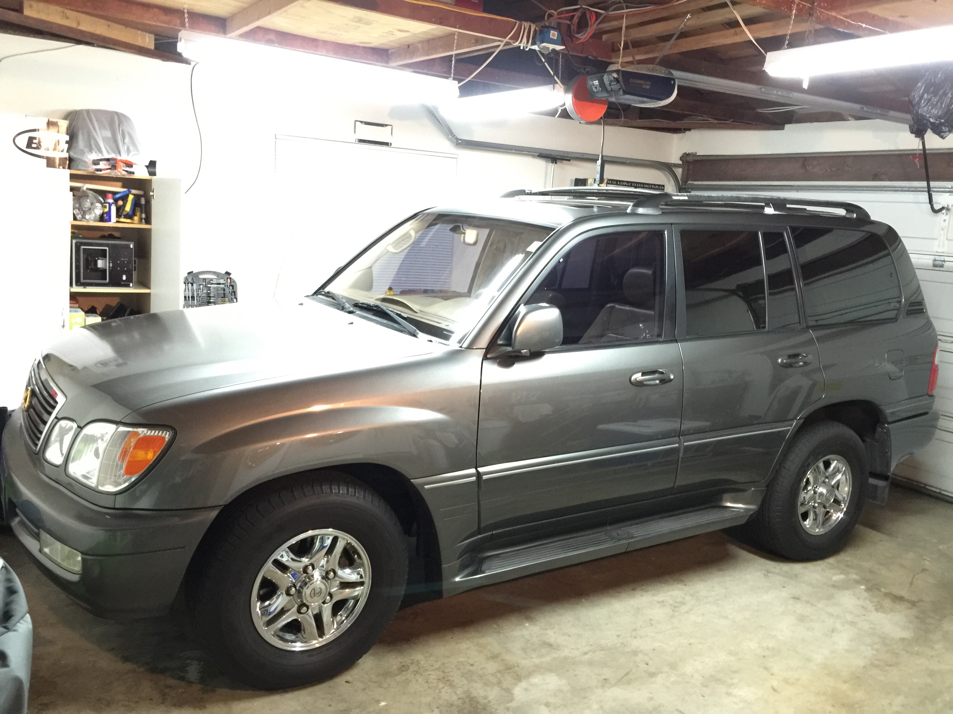

Just tonight I purchased my first LC.
(its dark, so this is the only pic i could get, more to come)
A 1998 LX (238k) with perfect, dealer maintained records and typical repairs recently done (Timing, boots, valve cover gaskets, tires). There are a few minor things I need to fix but overall its in great shape. Its a California truck so absolutely no rust.

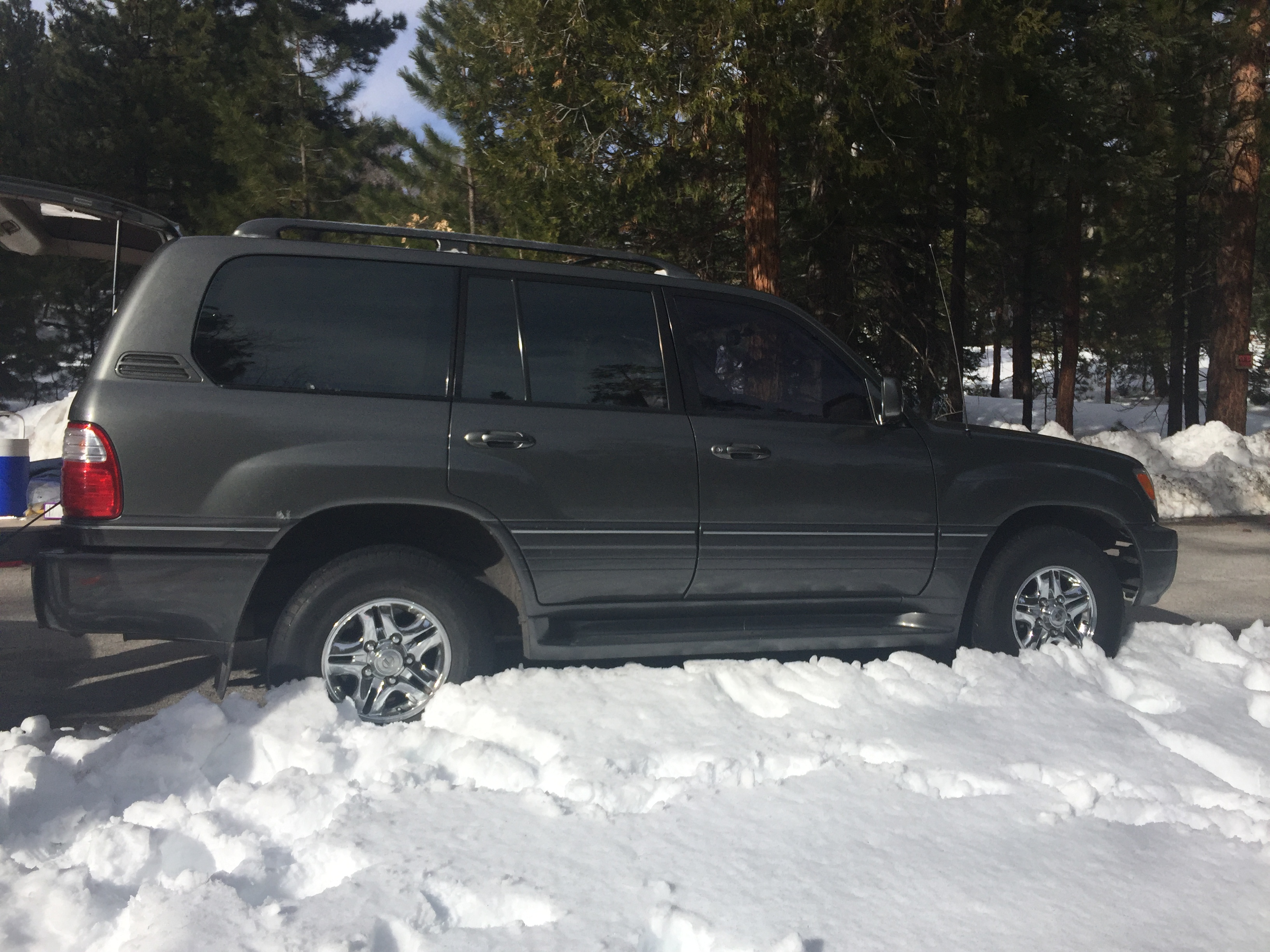

I bought it Friday night, took it to New Jack City on Saturday and Big Bear on Sunday. I am really, really happy with this thing. I need to get rid of these AHC bars. I can't decide on OME or used LC bars. I've been spending a lot of time reading through the numerous threads on suspension ride quality. lol;)
I think this is the first snow it's ever seen. Was a champ in it.
