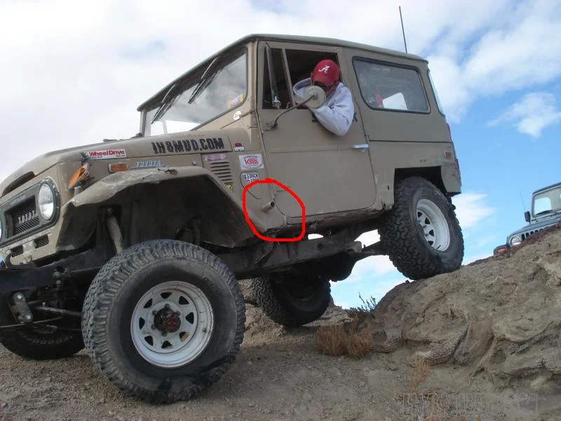

looking killer man, i see the cruiser has already seen some abuse, ill have mine going before to long we'll have to go out on a shake down run:grinpimp:
is that a foot rest for cruisin with the doors off?
Yes it is. My body was bad rusted when I bought it, so I'm not afraid to drill into her or set her against a rock or 2. Me being 6'3, it works out good. Picked up a set of freestyle bicycle pegs from wally world and bolted a small 1/4 inch plate on the inside for support. Smokin' high way pegs!
