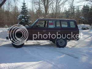

Heres a couple pictures of "Doo Doo" as hes is called. 1984 fj60 205,000 needs some love, but he runs .I own a 1988 toyota , so im not new to toyota but this is my first landcruiser .I do have a couple questions, I was told by the previous owner that that it has heavy duty springs as you can see in the pictures i think it sits higher than a stock fj60 , but im not positive, also in the side view you can see a shackel looks longer than s stock one. I would apperciate it if you guys could let me know what you think. I payed 1,400 came with a set of 35in super swampers. that i was told was on the truck when the Po bought it.

Looks pretty nice.. [ esp.4 Mich] I like doo doo brown. You've come to the right place to answer questions and get support for your new addiction.

It's hard to believe that anyone had 35's on it though.:confused:

Maybe some closeup pictures if you have any would help but the front shackles look stock. What size tire are you running in picture. To run 35's you need some clearance so sounds like you have some amount of lift over stock.

It does look like a lift has been installed. Measure from the bottom of you frame to the ground on all four corners as well as the tire size and maybe we can figure out what size lift it is. Look on top of the spring pack for part numbers or symbols and post them as well.

I have old stock springs with 31" tires and it is 15" to the bottom of the frame. (Stock tires are 28".)
Yes definitley want to put some tires on it, im just really trying to find out where i stand, and go from there, first things first the motor work(valves adjusted belts, filters,fluids,vaccum lines air rail, egr.) and smog pump,bumper and sliders,lockers then the tires.i have a set of 31's for the time being. In the long run i want to make it 100% but that wont be for a couple years at least , like everyone i talk to says just hand over your wallet, because your never gonna have money again. But im ok with that because i love the truck. It does ride like a tank , ive never been in another fj to compare it but me a 2 buddys got on the front bumper and it barley squatted. so the springs reguardless of being heavier or not are in great shape front and rear.
Old Man Emu (OME) heavy duty springs give, I think, 3" of lift. Most people with that lift run 33s. I think you can fit 35s on it but it may not give enough room to really flex. Close-ups of the shackles would help figure out if they are oversized. But there are a lot of companies that make springs for the 60 so you'd have to get some numbers or something off the springs to figure out the manufacturer.
Yea ill do that, the super swamper might be 33's but i thought they were 35, On the drivers side quater the tire came off the rim and did some damage on the body.

Its sitting on 31's on the picture right now, i was also told by the po that is has 4.10-11's for the mig tires, but the rpms dont seem to be up .
