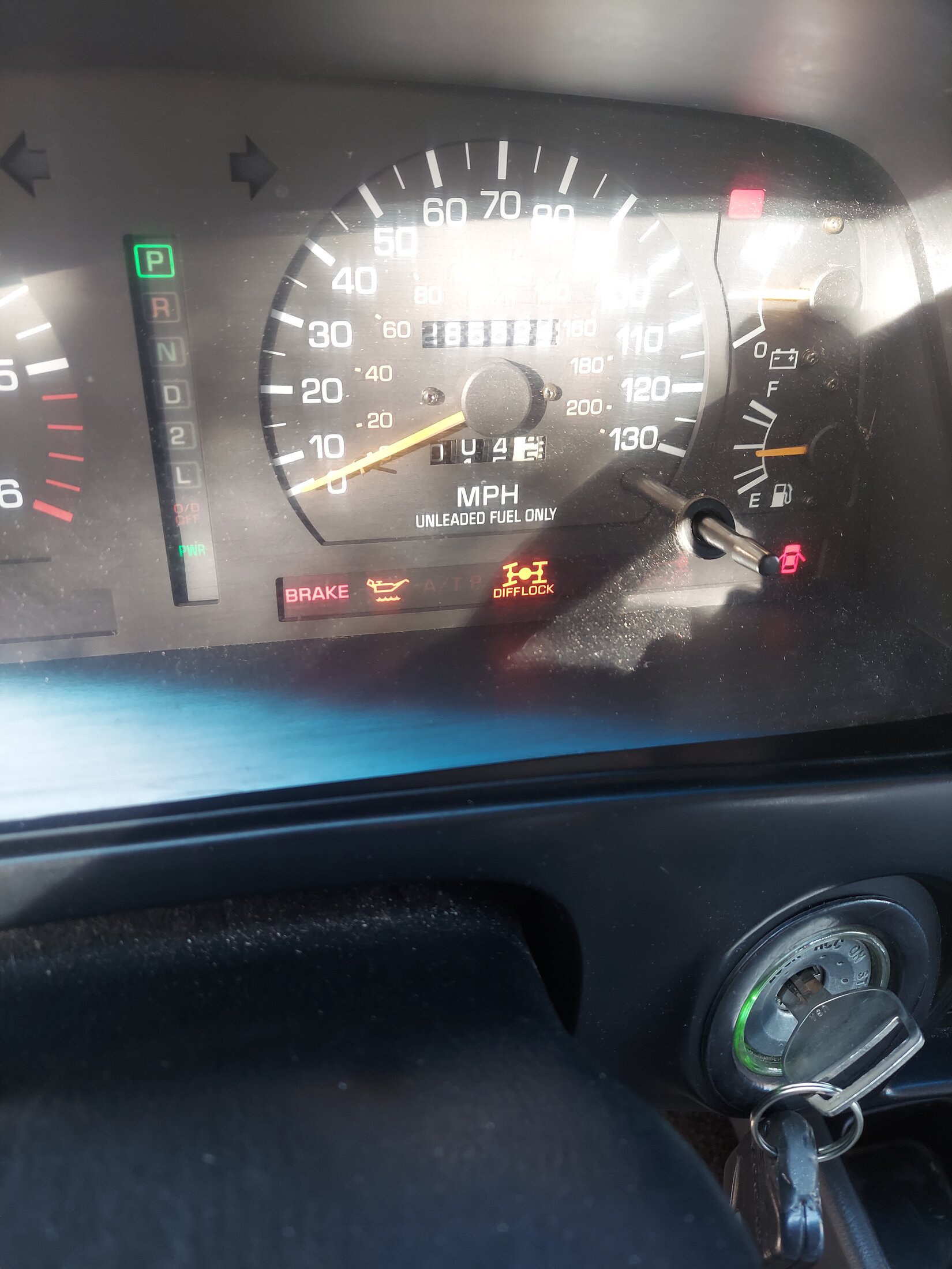

I went ahead and did the 7 pin mod for my CDL.
I followed the directions to a tee then went back over them 3 times to make sure.
The dash switch still does not engage the CDL. Nor is there a light on the dash.
I unplugged the plug from the t case and jumped the plug with a paper clip and the dash light worked fine. I replaced the actuator down there as well, but still did not engage.
I then tested the dash CDL switch plugged into the ECT harness and it worked fine for the ECT.
So the switch is good.
It does go into 4L manually just fine, but again, no dash light.
I tested the transmission relay box as well and it is good. Also checked the CDL dash switch harness and it seems to be fine .
Very confused on what the problem could be.
Thanks for any help in advance.

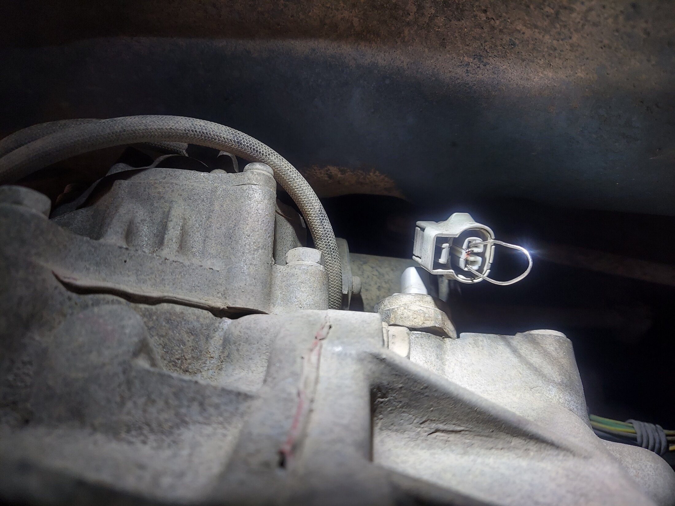

If you are speaking of the indicator switch underneath the vehicle, on the top corner of the t case, I actually replaced it today just to be safe and paper clip jumped the plug, which actually turned on the diff lock light on the dash

The "pin 7" mod is not relevant to your situation. The only thing that mod does is to eliminated the automatic locking when switching into 4-LOW. It can also impact the shift points of the transmission but that's a different discussion not something you need to address with your problem.
You haven't been very descriptive as to how you are testing and determining it not working.
Was the CDL working properly before you started making changes?
Are you using a real OEM CDL switch or a repurposed 4-way flasher or similar.
When everything is working properly, when trying to activate CDL by the dash switch or shifting to low range You should hear relays clicking. You have not indicated that is occurring. If you don't hear that, are you testing with the ignition on without starting the engine.
To start I would remove the switch and reinstall the factory jumper where the CDL is plugged into. That is going to be the simplest path to keep things as simple. Depending on replies to my question, I would suggest testing the 4-LOW Position Switch, jump the connector like you did before.

The CDL light was not working before I made changes.
It is an OEM CDL switch that I am using
I think I hear a clicking? But cannot state that as a fact do to being deaf in one ear.
The sounds of the relays are going to be important. That's why I suggested not having the motor running. With your hearing loss then get a wife, kid, neighbor to be your ears.
In your first post you stated:
Did you replace the actual CDL actuator on top of the transfer case or was that just the CDL sensor switch that is located in the front of the transfer case near the front driveshaft?
Next steps if you do hear the relays is to determine that the front/rear are locked by putting the vehicle up on jack stands and see how the axles move relative to each other.

The connector on the indicator switch on the t-case could be damaged or unplugged. The switch itself (on the t-case) could be bad. It will not prevent anything from working properly except the light on your dash.

The diff lock light comes on the dash if I jump the plug to the sensor. Other than that it won't come on manually putting it in 4L or pushing the CDL button
Well in that case everything from the sensor plug to the light in the dash is working. If you replaced the sensor then maybe you got a bad one.
The next thing I would do is pull the new sensor and check it.
