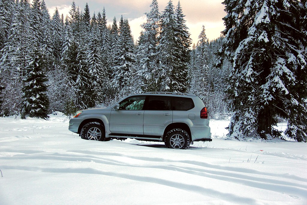

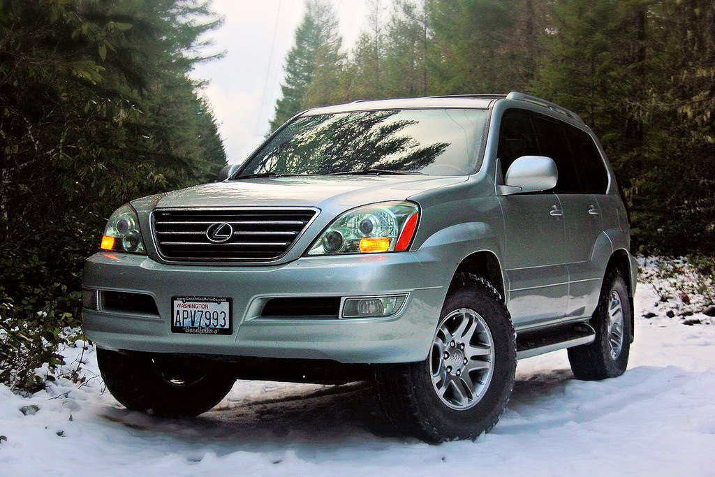

just acquired a 04 GX, 130k, no nav, no KDSS, dark leather, SPM exterior, 3rd row... its basically everything i was looking for other than the 05 and ABM. it has a few issues but those are slowly getting resolved, waiting on HID kits from DDM. getting a new windshield tomorrow(i think this one leaks -either that or its the moonroof). put a set of 285/70/17 nitto terra grapplers on it along with some old tundra/sequioa limited wheels i had laying around from my 4runner, no rubbing other than in reverse at full lock(not worried about that in the least).

You fit 285/70's with no lift! That is awesome! Is the offset on Tundra wheels different then the factory wheel?

yes the offest is different. im not sure on the numbers, but the wheels sit further out. they are pretty much perfectly flush with the edge of the finders, giving it a much more agressive look. -lol once again i have managed to fit 285s on a stock rig where people told me all day long it would never work.
the goal of the GX will be to remain subtle. no aftermarket bumpers, no crazy lift(2" is enough). i want it to fit in at the ballet/orchestra and not draw any attention. i want it to be unassuming and to have people pay it no attention, yet be very capable and get the odd looks and double takes when its seen off road. the point of this is to be a family rig that i feel safe exploring in with my family. sure i could do that in my 4runner, but it was getting cramped and lacked the creature comforts and refinement that this has. i dont want to "wheel" this per say, but if i get into something that i wasnt expecting(its happened before) i want to be at easy knowing its perfectly capable of self extrication and retreating back to civilization unassisted. -the pictures of it in the snow, the ones where its in the meadow, i almost got it stuck there, would of been nice to know i had a winch and or a rear locker to make things easier and less stressful. as it was judicious amounts of throttle were used/needed to free Tux and get us on out way again. while yes that is a technique, its not the one i prefer. i was off the trail there(sure bad on me) but i had no intentions of tearing up the meadow, thankfully my tires are not aggressive enough to really do much damage in the snow, but still id much rather have just eased out of there with little impact.
