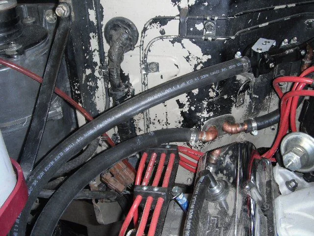

That's exactly what I did. Added a small flare to the tube where the hoses connect.
A glimpse from the engine bay
attachment.php
i just cut up the front T's and turned them into elbows. no sweating, soldering, brazing. just cut, get some heater hose, hose clamps and call it a day.
