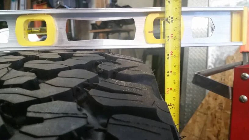

So here they are, the 315's, right at 34.5 ". They have 45 psi, nitrogen in them and it's 25* outside.
