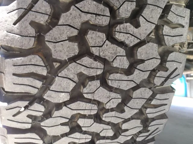

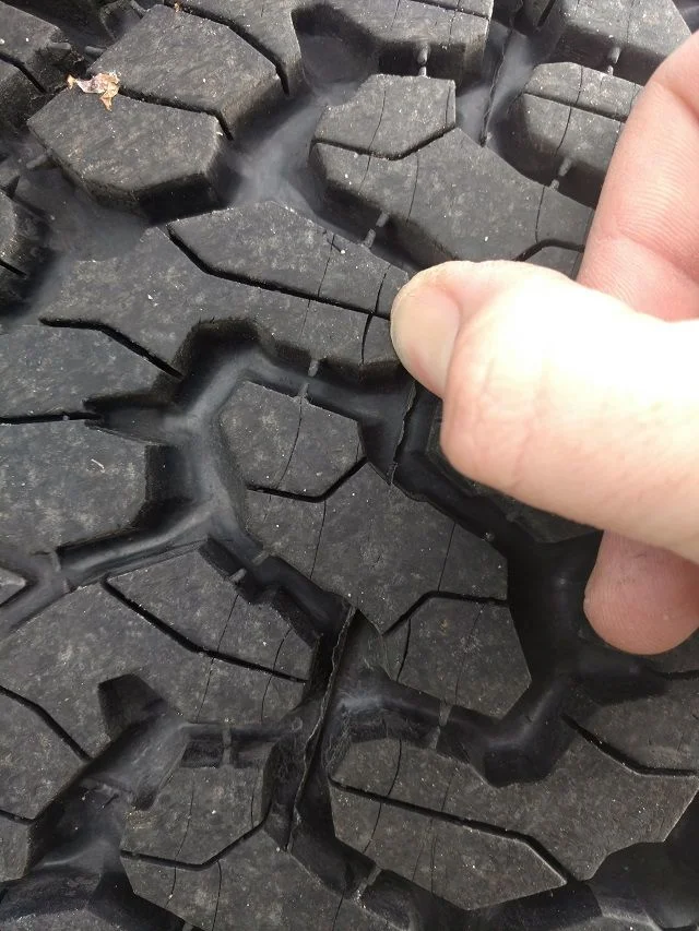

Update: My spare started to split in the same way after a few hundred miles. I returned to discount. The first time they told me they'd never seen anything like it, and that I could warranty them for 90% of what I paid.. When I went back to do that they switched, said it was offroad damage and I was stuck with them. I sent another email to BFG, hopefully they'll take care of it.

Talked to BFG today on the phone, they're taking care of me, 100% replacement. I'm most likely going to switch to KM2s as well. Excellent customer service.
Discount Tire on the other hand.. They're on my list now.

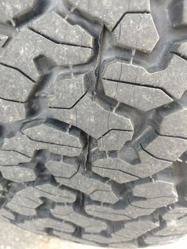

Add another set being claimed under warranty. Just wish I would have paid closer attention sooner, but I hadn't looked at this thread for months. My 295/75r16's had 2/32" wear on all tires so I had to pay 15% for replacement's per their "prorated" usage. Think that is kind of garbage considering they are 6 months old and had 7,800 miles on them. Defective product, is a defective product. But for peace of mind I didn't complain too much. New tires will be in next week.

I'm definitely a fan of how they perform personally over the ko's I had on a Tundra. Hopefully it isn't wide spread and potentially just limited to a few weeks of production. One of the tires was made the 40th week of 2015 and the other three were the 42nd week. Honestly they might have been fine for the life of the tires and not cracked anymore, but in my opinion the risk of my family in the vehicle verse a catastrophic failure was not an option. Either way tread lugs separating from each other shouldn't be happening. I would encourage all to check their tires weekly.

I just started hearing that BFG has had some problems with compounding for the KO2s and KM2s. Hope they it fixed!
Had one of these batches I guess. Exactly the same as what has been described above. Going in to have the shop take a look. Customer service has been friendly so far. Will report back on how it goes.
