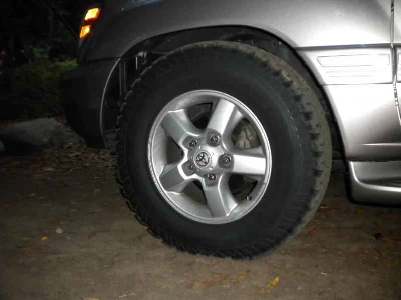

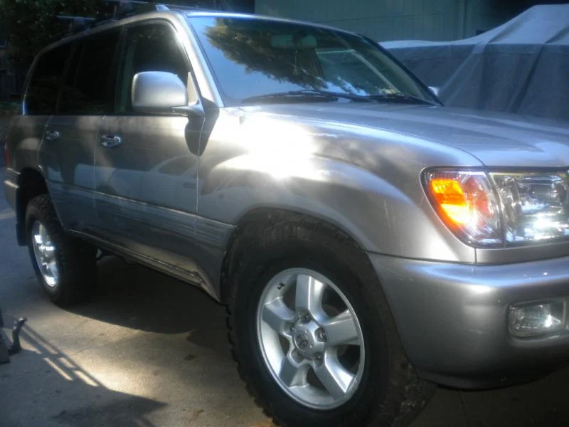

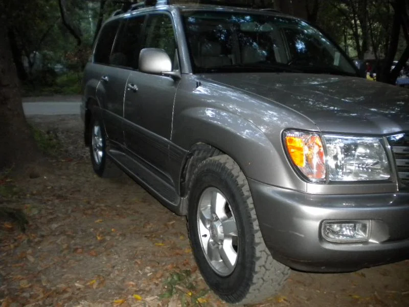

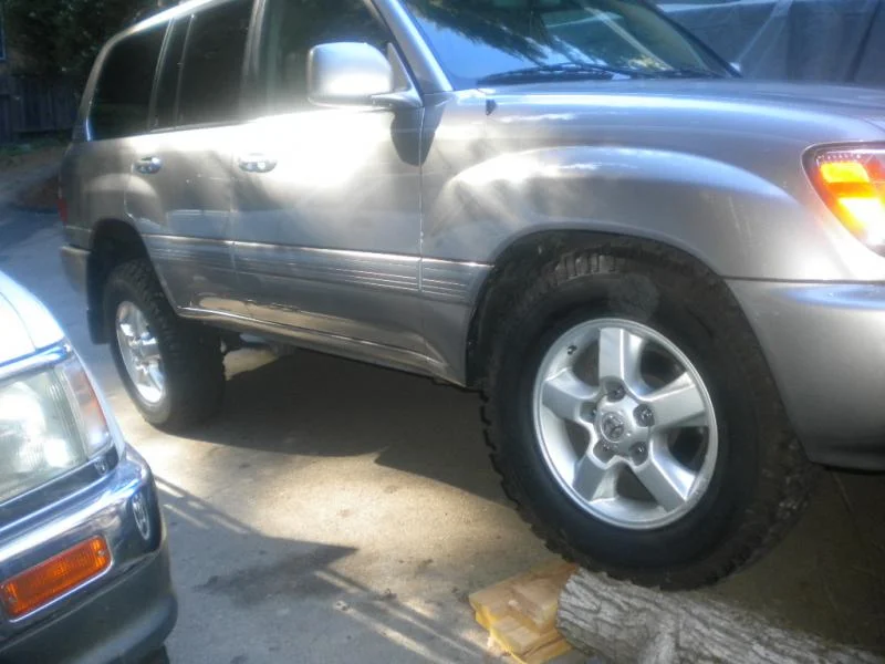

New BFG AT's 275/70-18's pics.

Looking good 4P! I never saw that older post of yours to post up some level driveway pics.The BFG's are great tires,I am really stoked on them!! I just need a bit more lift,the tires come really close to rubbing in the front.I did hit the inner plastic cover once pretty hard and it tore it up a little.So I used some small flathead self tapping screws to tighten it back down in a few spots.

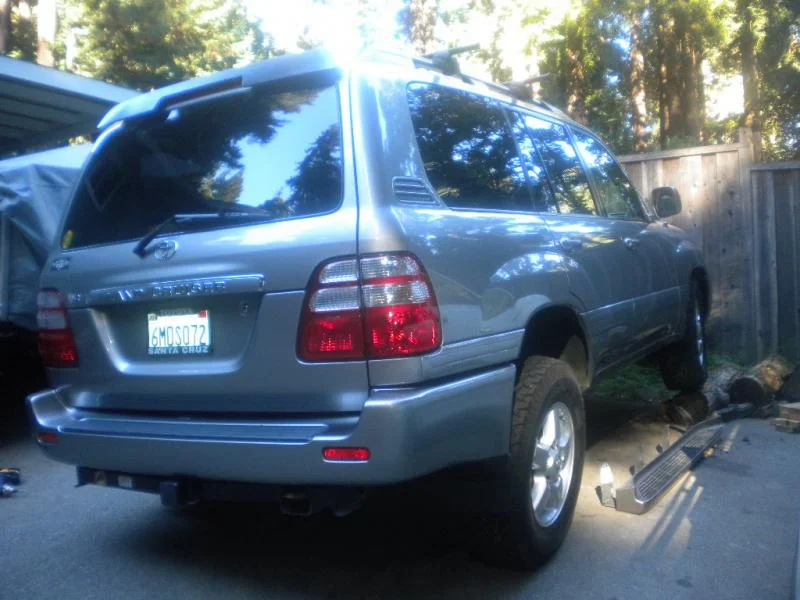

Hey 4P is your truck loaded up pretty good from your trip,cause it looks like it's sagging a bit at the rear? Or maybe you need more lift in the rear to match front? Time for some OME !!! Or

Hey 4P is your truck loaded up pretty good from your trip, cause it looks like it's sagging a bit at the rear?
Family of four, a Thule Evolution 1600 stuffed to capacity, about 200 pounds in the cargo area, 275/70-18 BFG AT KO spare, bike rack and tri bike.
It is sitting a little bit lower in the rear than my normal—maybe 3/4"—but I won't be putting firmer springs in the rear. I made that mistake on my 4Runner, and the ride was way too rough for the family. I love the way the Land Cruiser rides now, and it does so sitting 2.625" higher between the 1.5" rear coil spring spacer, cranked torsion bars, and 275/70-18 BFG AT KO's.
