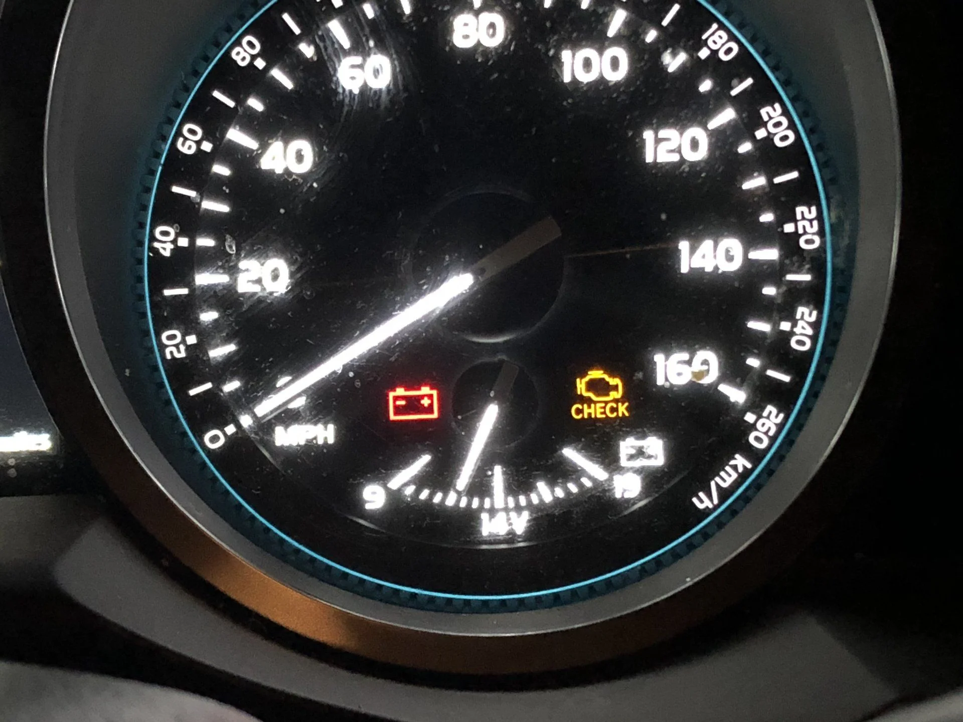

Another clue :
Look at the battery reading
