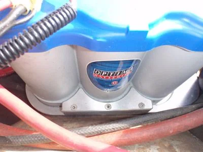

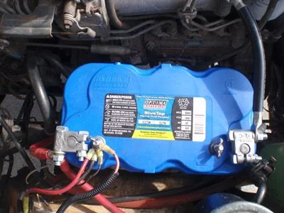

Give ol' Blue something nice. Working on boats we only use the blue top Optima deep cycle batteries. I just recently did this for my 12V HJ47. I went with the D 27M. They are pricey but will last nearly forever. I also went with a really kickarse tray (see photos). The tray is nice because there are no vertical tie downs.
I purchased this setup from the guy who machines the trays. His name is Ben and he also worked with me on the price. I found a cheaper battery online and he matched the price and the whole package was here in two days with free shipping. Really great to work with. Now he doesn't do much with landcruisers (yet I hope) so you will have to drill and countersink your bolt pattern. However, I bet if you get him a template he would do it for free. Super Nice guy.
Oh and meant to mention that I changed out my terminals to a mil-spec type that allows you to terminate your cable and bolt to the side. Also made up some heavy duty marine grade cables w/ crimped copper terminations for the starter, ground and redid as many body grounds I could find. Anyway, I'm real happy with this setup and let me know if I can help out. The link to that optima tray and battery site is: Optima Battery Trays
