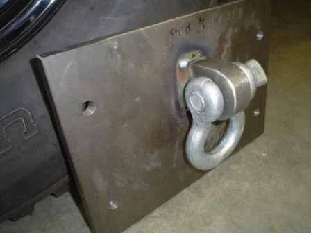

Here is what I made for a recovery point for my new bullbar. I used it last weekend. I painted it before the bolt in. I will use this until i get a winch.
