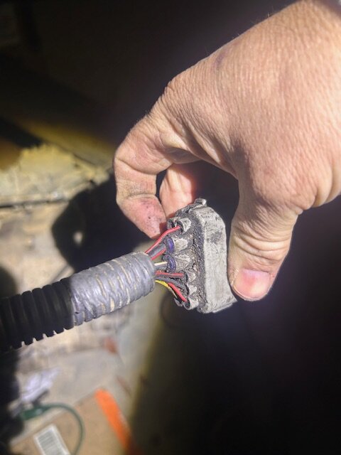

I broke the connector on the neutral switch coming from the wiring harness when removing the engine. Can anyone point me in the right direction for finding this connector? Thanks

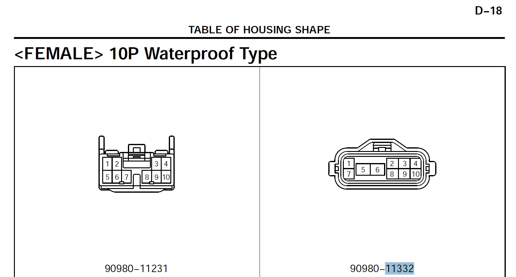

Thanks, to update it is 90980-11332, at least that is what I am ordering, will update if incorrect

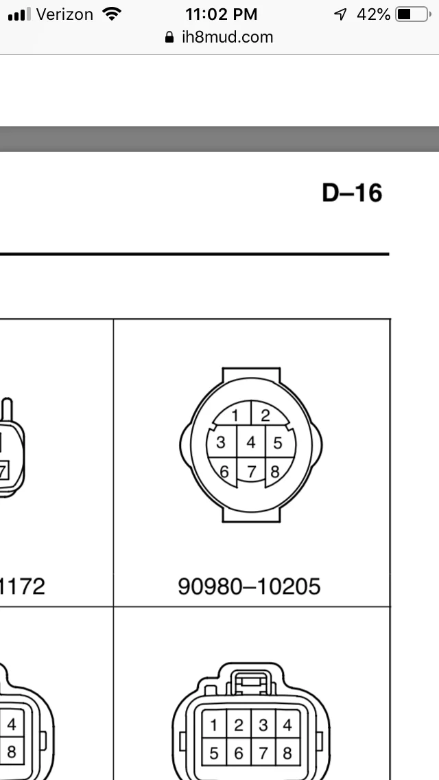

I wouldn't do that:

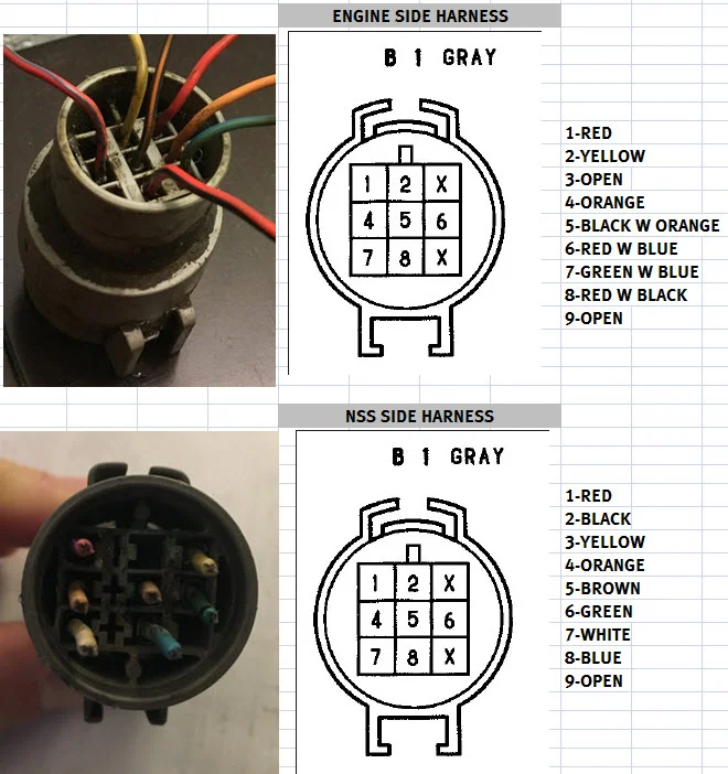

-10204/5 above aren't the correct connector housings. The NSS connector housings are 9-pin waterproof.
The "with clamp" option is the latch style.

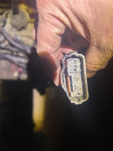

This is the plug I am trying to replace, Is this not the 11332? Am I calling it the wrong thing or am I confused?
