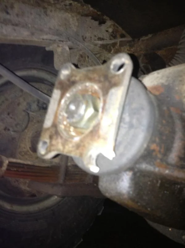

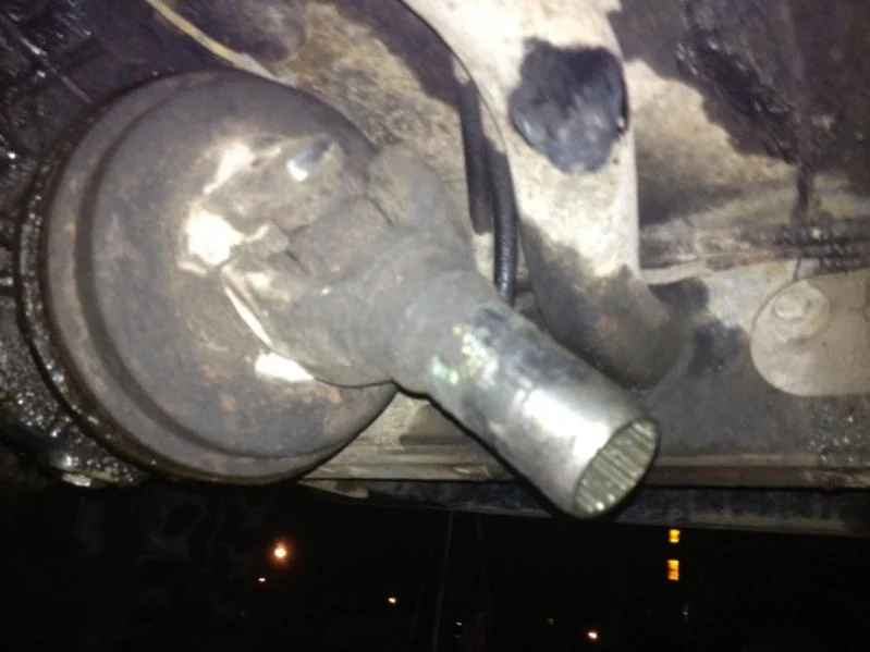

Grenaded a u joint and lost my driveshaft on the 75 fj40. 4 speed stock length. Trying other methods and searched but wanted to swallow my pride a put a feeler out to the club.
Here are pics of what I did. Need a new diff flange I guess.. F**k.
Might have what you need. pm sent

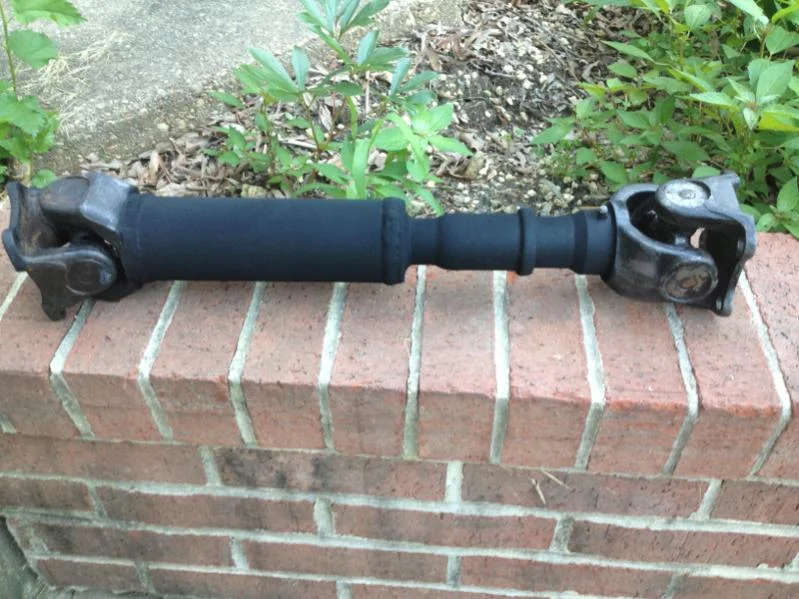

Took the shaft apart. Wirewheeled and rustoleum flat black.
Tomorrow going to try and get it back together. Will let you know
Here it is lubed painted and ready to go!
Be careful of properly phasing the driveshaft. Both ends must be in the same plane. Yours is showing as exactly opposite.
Thanks or the heads up on the ends. Got it installed and all is well. Going to crawl under there and triple check all my stuff later this evening.
