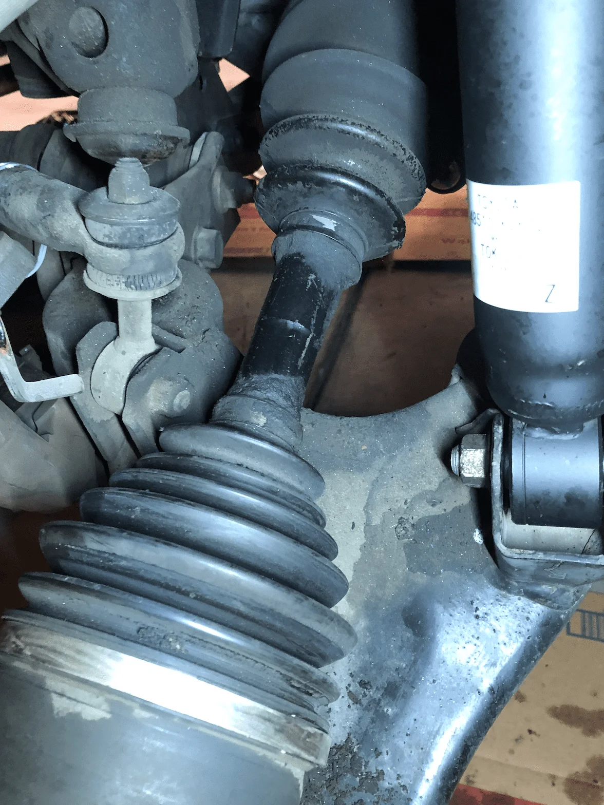

Hi, I plan to buy that 199 dollar reboot kit with an outboard to rebuild my passenger side CV axle, but I am worrying it is not an OEM one.

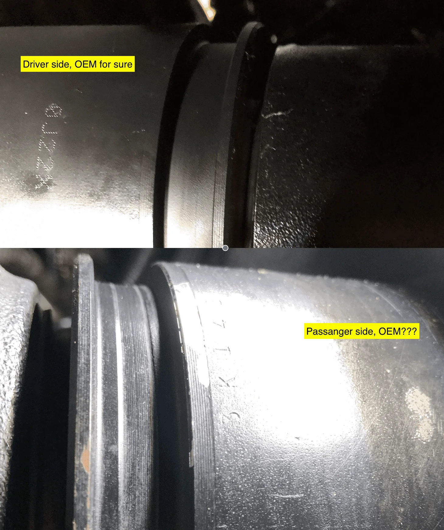

I am sure its dust cover is OEM, with a TG mark. etc. But the strip on the outboard is not green/yellow, don't know if it just loses color overtime...
I have a new OEM on the driver side, you could see from the pic below, some detail of the passenger side inboard dust cover is different, and also it has a serial number "3K14B".
If there is a possibility that the cv axle 17 years ago has different details?
If it is not OEM, could I still use that 199 dollar rebuild kit on it?
Thanks for any suggestion.

I have OEM axles, don’t recall seeing any stamped markings on them though. I would not worry about the band not being yellow — could be an OEM axle was rebanded at some point with an aftermarket clamp. I recommend replacing your clamps with worm drive clamps if you are rebuilding anyway.
What $199 rebuild kit are you referring to? I did mine for less than $50 per side.
Edit: I assume you are going with the kit that comes with a new outer half shaft rather than only boots?

I also need to mention that even the location of the series number is different but the pattern of those numbers is the same "0j22x" vs "3k14b".
Is there something wrong with your outboard shaft or joint that you are replacing it?
No, or I did not tell. I just replaced my upper and lower ball joint, bearing, so I want to do it at the same time and hopefully not come back again...such a pain...
If there is nothing wrong with it, then just reboot. Or if you really want to save time then replace the whole axle. The only time I’d replace just the outer half shaft is if I knew for sure there was something wrong with it (and I knew for sure that the inner was fine).
Thanks, this makes sense. I just a little unwilling, and also the OEM one just raised its price this week about 55 dollars more...
yeah~, I am not sure the inner was fine...
Yeah they are pricey for sure. I would say just reboot if nothing is wrong. Or if the boots are fine then maybe don’t do anything at all! I would at least replace the clamps with worm-drive type, though. I would not replace just the outer half shaft.
Logic would suggest that if an OEM axle has a lifespan of x miles, then a new half shaft would also have a lifespan of x miles. If you replace just the outer half shaft then you will have a mismatched axle — the inner would still be expected to fail at x miles, but the outer will still be in relatively good shape at that time. However, Toyota does not sell the inner half shaft by itself so when that happens you will have to purchase the entire shaft new anyway….
Only situation where I would replace just the outer half shaft: A Harrowing Tale of Incompetence - How I destroyed a steering knuckle - https://forum.ih8mud.com/threads/a-harrowing-tale-of-incompetence-how-i-destroyed-a-steering-knuckle.1191667/

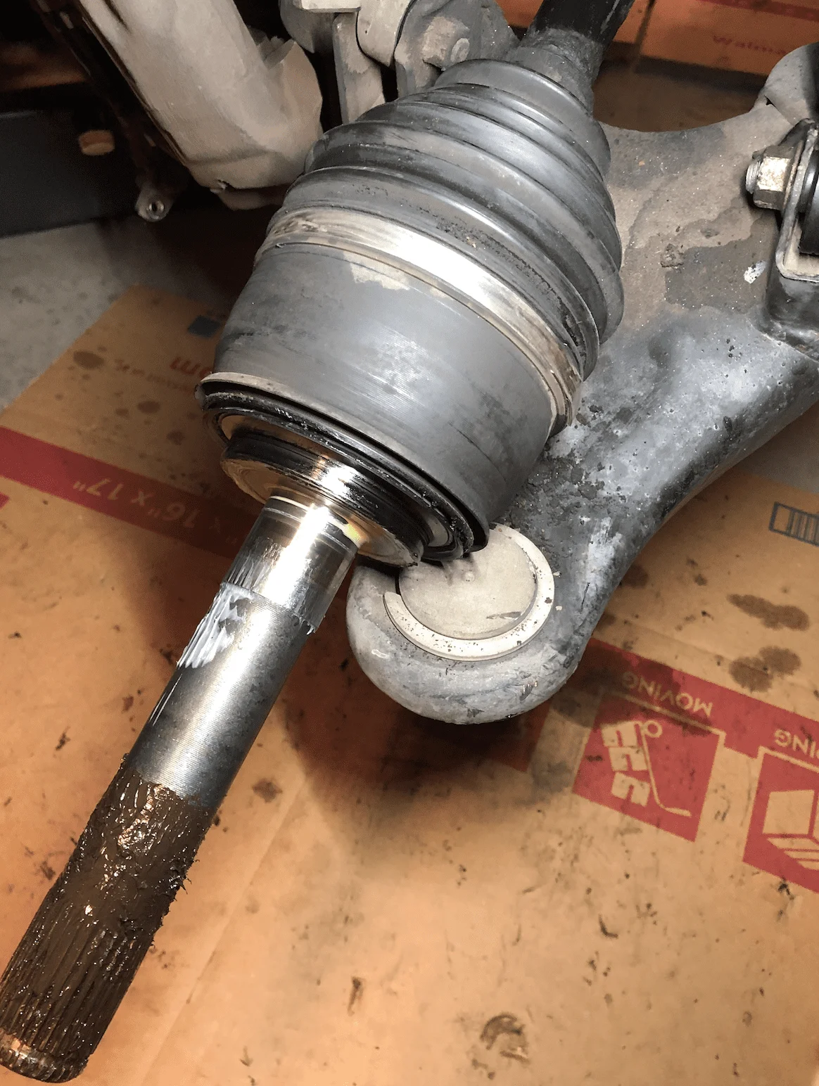

Edit: Just looked at your pics again, I would at least reboot/regrease/reclamp. Looks like you've oozed a good amount of grease. Plus, by opening up the boot you can get a good feel for the actual condition the joint is in.
Thanks for mention this. Now the outer replacement would be a very bad choice. They do sell the inner, but about 350, then it is not worth at all...
I end up with a brand new OEM CV again.
