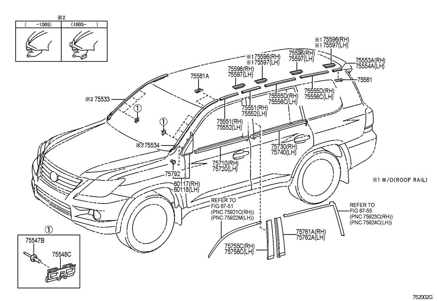

same here. 2011 LX570, the driver side windshielf moulding plastic strip pop up on the roof end, wont clip down, pops up again and again. ALSO, according to the diagram , see below, there appears to be several short pieces running along the gutter but mine doesn't have those short pieces???

The tops of the windshield molding clip into a metal tab with hooks on either side. This part is glued to the roof channel.
Either of these connections could have failed. I used the toyota procedure of new clips and a flexible epoxy to bond them to the roof.. will see whether I got any pics wh
