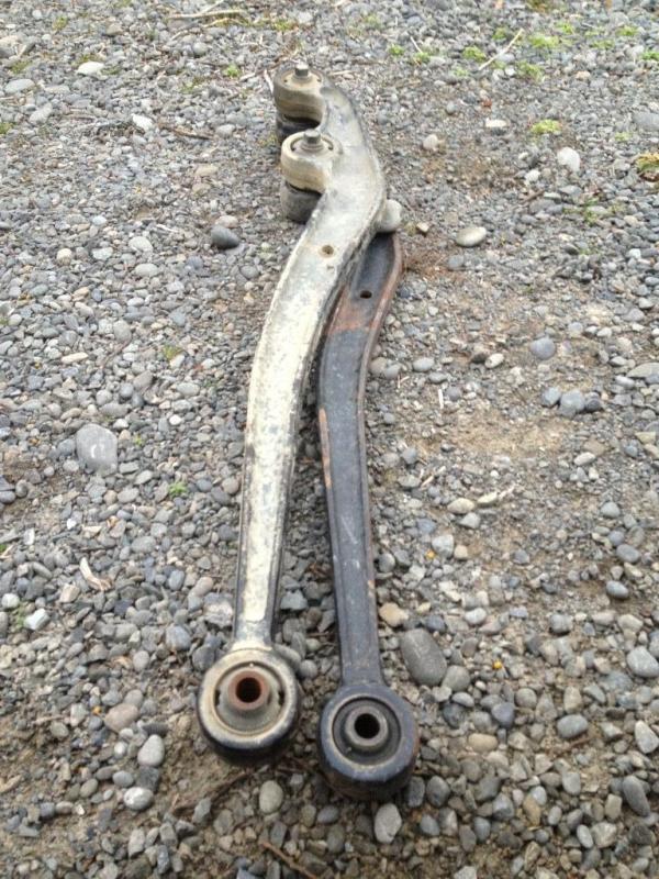

80 series arm on top and prado on the bottom

I need to know how close an 80 series arm is to a 78/70-105 series. I believe if I can get the measurement from the rear bolt hole to the two front holes I can do the math.'
sadam husain= thanks for the image it clears up some of the mud.
Does this mean if you have a lifted 80 series and fit prado arms to it you won't need drop boxes to fix the castor issue?
Its actually the opposite. The 80 arms look to have a few more degrees of castor built in.
If you had a lowered 80 (stoopid) prado arms would correct the steering I would think....
