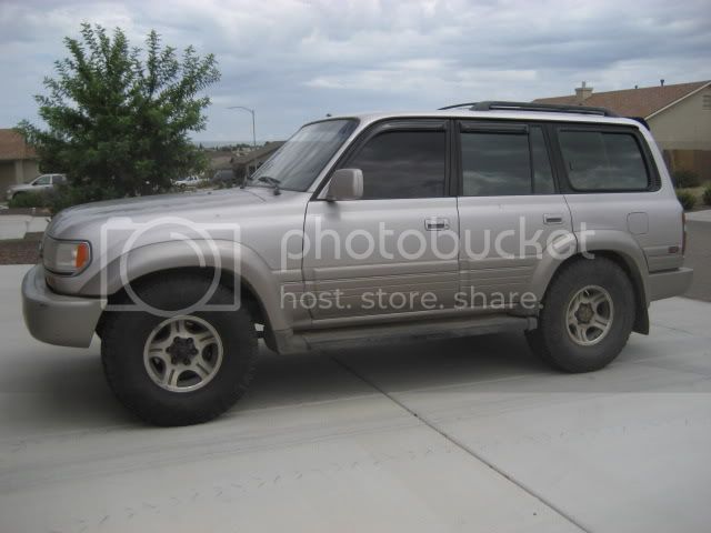

As posted in the 80 section, I was able to pick up a J-lift and a set of 315s for my LX.
I have:
- 4 struts,
- 4 springs,
- 2 - Mr Gasket 3/4" or 1" spacers (not sure which size when compressed)
and the Slee caster correction plates.
Do I need anything else to install this lift immediately (I don't plan on wheeling for awhile, so if I can run it on pavement without certain items, I'll pick them up later)
We're supposed to be moving into a newer house in the next few months and I've already packed up the majority of my tools.
I'm hoping to find someone familiar with installing this lift, and maybe whichever tools will be needed and I can meet up with them and get some help with the install.
I already have the 315s on the truck.
Also, will a 315 BFG AT fit in the stock spare location until I get a rear bumper, or will I need to keep it inside?
Hooray no suspension travel!
