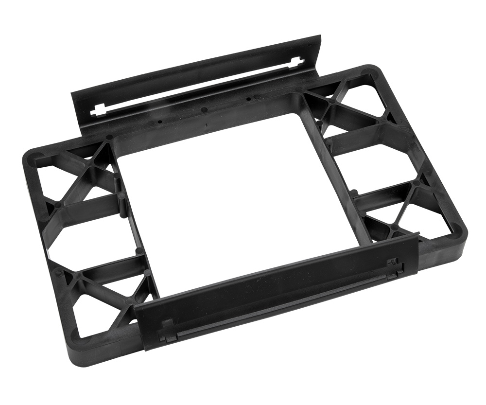

When my 27F needs replacing, i'm going to try a AGM H8 with this spacer:

That spacer looks interesting. It appears the width/depth dimension of H8/49 may be about 1/16 inch greater than group 34. The interface on the bottom may be different too. So I'm not sure it will snap on to an H8, nor whether the height will end up right, but I might give it a shot.
Have you read any reports of it used for this application?
Don't know if anyone has tried it yet. I recently bought it for future use. It looks like you have to cut off the locking snaps and just use it as a spacer like a piece of wood.
I bought a similar spacer to use with my H7 (same size of an H8, just a little shorter) and the spacer did not snap onto the battery. It was slightly too small. I cut the tabs designed to snap onto the battery off of the spacer and simply set the battery on top of the spacer. The spacer did raise the battery up enough the hold down would sit flat across the top.
