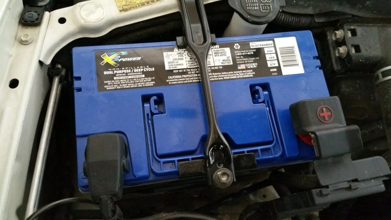

One more vote for the X2 Power AGM in 27F size, $360 at Batteries Plus, so expensive. Toyota brand
batteries do not come in 27F, which is the proper size for the 100.
