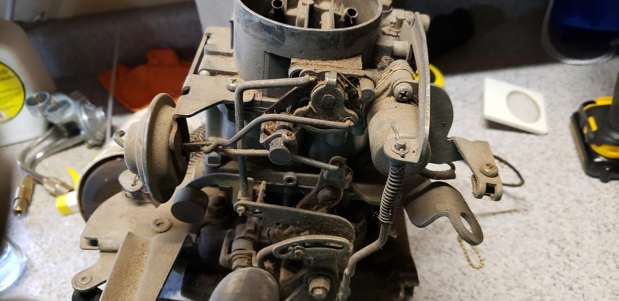

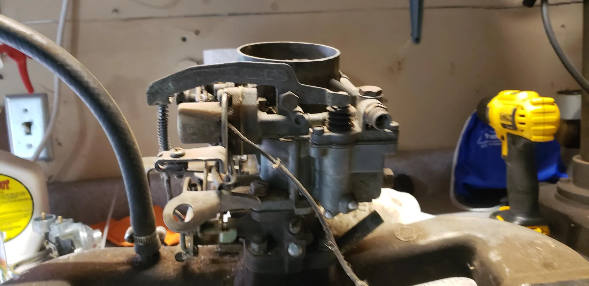

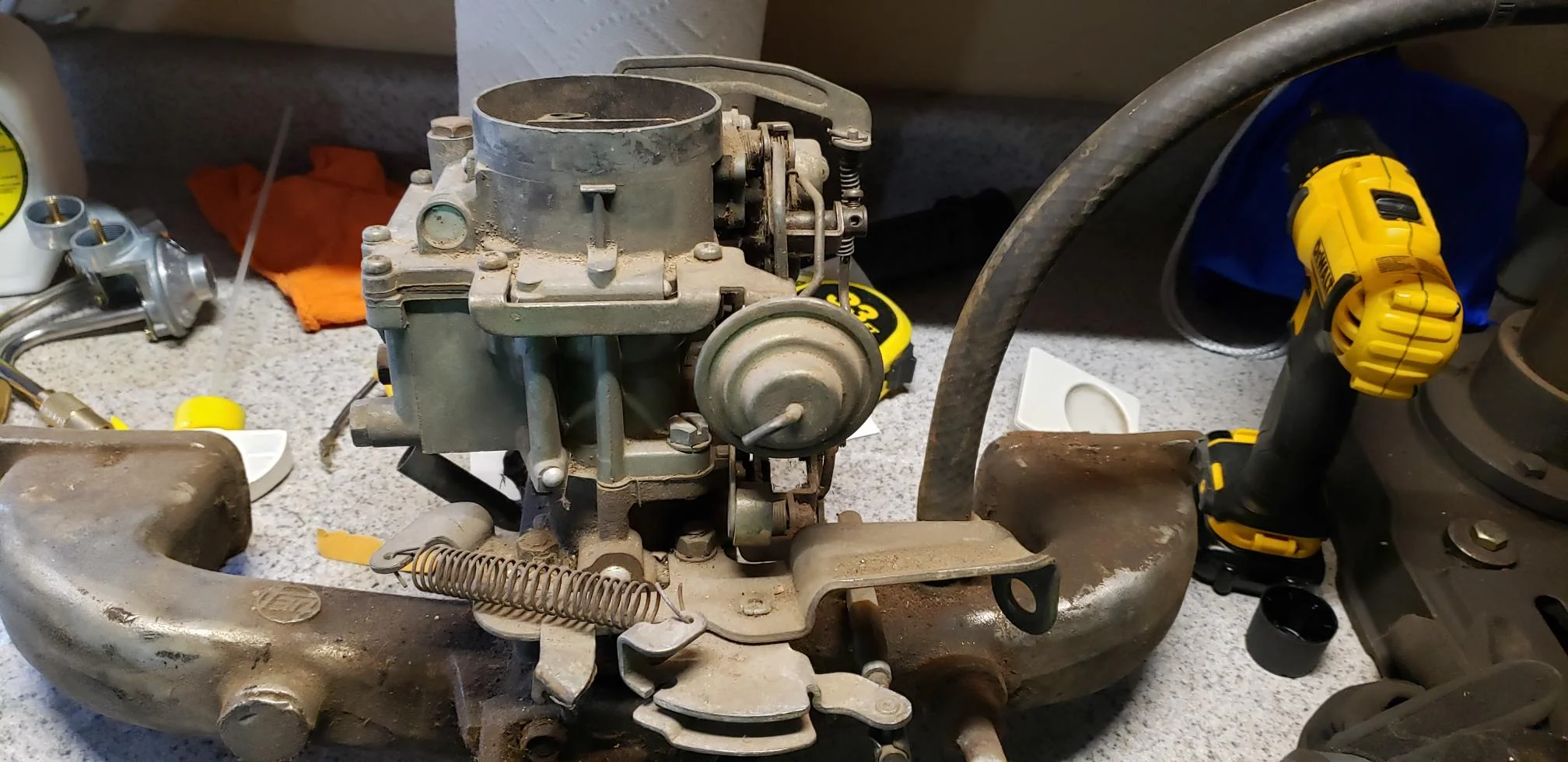

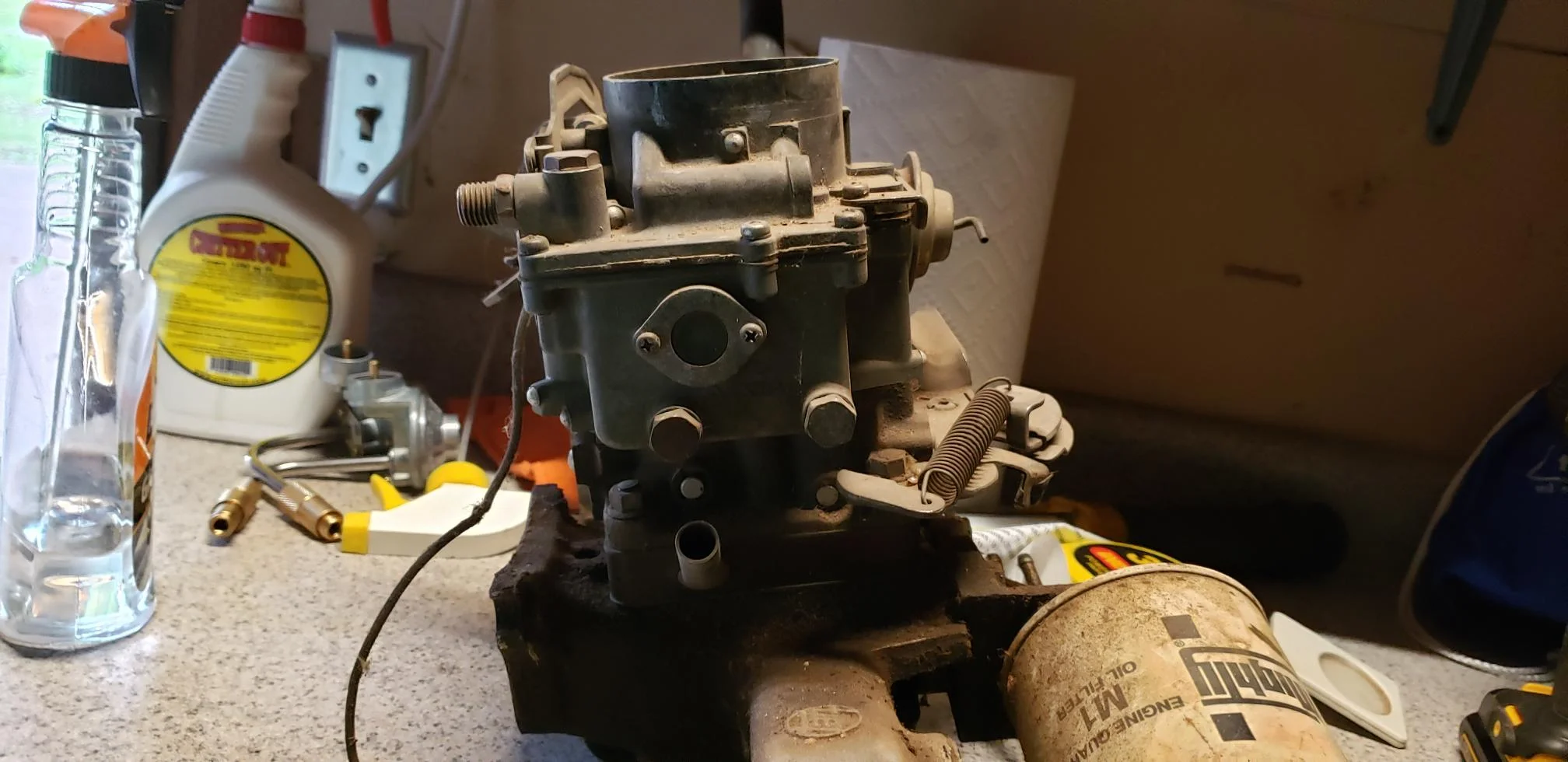

Need to rebuild this carburetor and want to make sure I get the correct rebuild kit. Thanks in advance.
Just run with the rebuild kit for a '70. The 70-74 carbs are the same fundamentally with variations in jetting. Interestingly enough, it has '73 linkage.
Open it up and see, if its a '70 it will have 112 primary, 200 secondary, 90 power valve jet, 50 for both primary and secondary slows.
By the code 0 K 26 would guess 1970 "0" November "K" 26th one made that model. 1960 would be a one barrel carburetor. 1980 would have a stud out of the top for air cleaner. K is the 11th number in the alphabet equalling November..
Thanks, that was my thought too. I have a 71 40 and it looked similar except for the linkage. The PO had damaged the original carburetor. I just wanted some confirmation.
