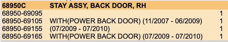

IMO it's safe to assume that if the ball portion is worn the socket is too, so I'd consider doing both. Plus, it appears on a 2009 it's not available separately, only with the whole strut assembly. I'm not sure whether the later model parts can be installed on your 09.
I'm attaching the breakdown of original numbers and build dates
Thank you sir. I wondered about that but it is very unclear in the images. The same part number is refered to the whole box I marked as well as just to the individule strut. I will probably do both side just in case but yes, the right side strut shows damage as well. Not sure if it is because they are aftermarket or just one slight defect in one strut to cause this.
