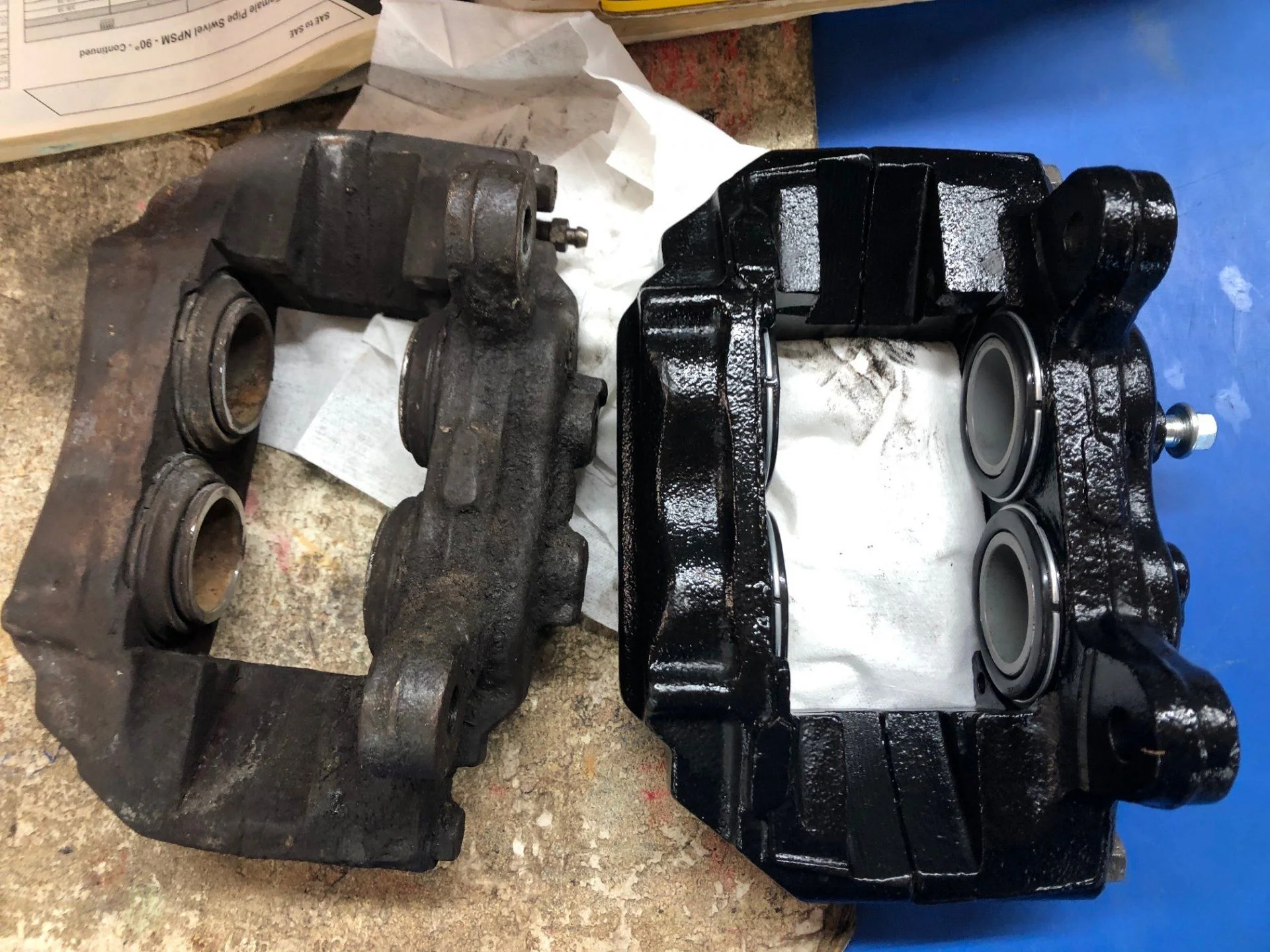

Hey everyone. I need some help from the good folks on MUD. Sorry if this a little long. I want to provide as much info as I can.
Some context: My right brakes seized up on me last Friday evening and the rotor was nearly molten by the time I could get safely pulled over. I had come to a stop at a stop sign and then turned out into traffic on a small highway. I immediately noticed the resistance. I pulled over as soon as I could in a church parking lot and my front right rotor was smoking. I was within reach of the Lord's water hose, so I cooled it down and got a steam face treatment (that part was nice). After a few minutes, I started the Cruiser up, tested the brakes gingerly in the parking lot a few minutes and then limped 3 miles home slowly. The caliper on the right seemed fine all the way home.
I inspected the next day and ordered new calipers and pads from Napa. I installed those yesterday and tested out the brakes on my road and then drove to Walmart to get some degreaser. When I exited the Interstate I could feel resistance and by the time I pulled into the Wal-mart parking lot, I could not budge without red-lining the tach. I went in and got my degreaser and let it cool off. I came back out, loosened the banjo bolt on the right caliper to let off the pressure, and then I drove home about 1 mile without any brake issues.
I am looking for suggestions on what I should look for. I have brand new calipers and pads. Right Caliper was the culprit again this time. What is causing the brakes on the right to not release when I let my foot off the pedal. Looking at the fluid last night, I feel the need to change it. It's getting dark. It's dark at the calipers but light in color in the reservoir.

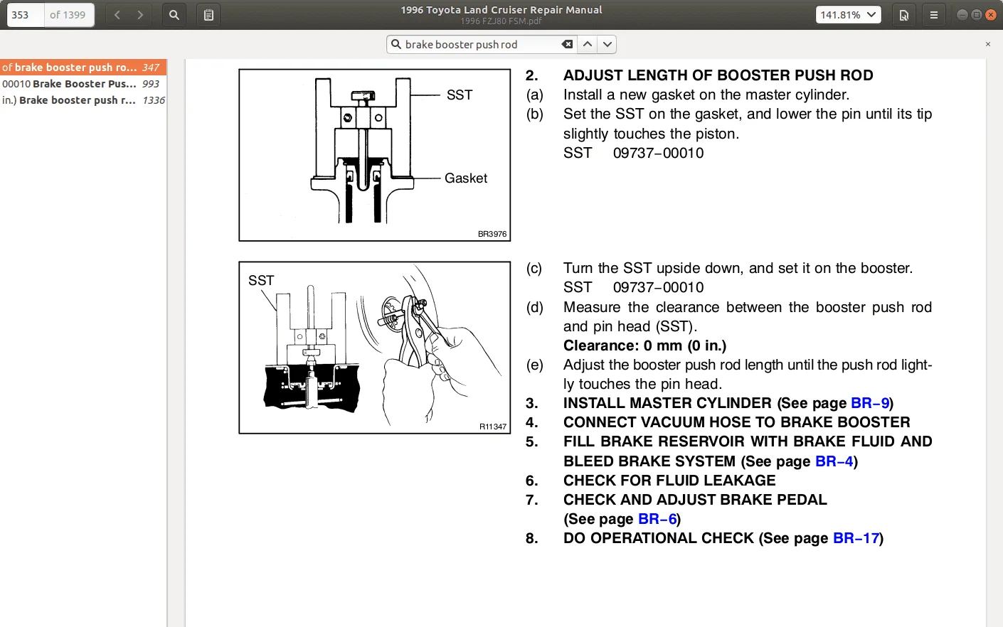

What did your pedal feel like after this? With the gap between MC and booster could you detect a bit of free-play in the pedal before your brakes engaged? A wrench-thickness-worth is a lot of gap and should have been enough to fully release rod from the MC plunger allow it the MC to fully retract. If you could indeed feel free play in the pedal before any braking action then I think you can rule out my theory of the rod being adjusted too long and holding the plunger in a bit.
The Idea as noted of "Loosening 4 bolts on master cylinder" to increase rod length. This is concerning and not right.
Check FSM for Rod adjustment under the left dash under steering column
I agree that loosening the 4 bolts and creating a gap is non-conventional but it is a quick/easy way to figure out if the MC plunger is being depressed after the brake pedal is fully released. I've had success using this method on an 80 series land cruiser so know it can be effective in this scenario with a tight brake pedal and major hydraulic brake drag on multiple wheels. Read above to see that Nathan has confirmed that it's no longer just the front right that's dragging which is very relevant. The adjustment under the hood, behind the the MC is a valid procedure as you can see from the FSM pic below. This is separate from the rod adjustment under the dash which is more related to pedal free play from the booster.
Nathan, if you are are confident that you indeed created free play and that the rod was not engaged in holding the MC plunger down then there aren't a lot of other likely sources for retained hydraulic pressure to my knowledge. I'll mention that it's feasible that the ABS could be causing some issue here but I've never heard of that happening and I think you'd have other clues pointing to it if it was the issue. Maybe someone else can chime in on that possibility.
My next guess, based on my own experiences, would be the MC. That's not to say that I'd change the MC next but I'd have it in my mind as I tested and reviewed the system and tried to rule out all easy options before diving into an MC change and full bleed. Of course, you still need to change more hoses so you could knock it all out at once and in your shoes I would change the MC whenever you change the hoses if this issue is still present just to help rule it out.
I have seen an MC fail internally such that it braked fine but would sometime retain fluid and other times not. This was 15 or so years ago so I don't recall exactly what was wrong with it but as I recall there was a loose part internally that was preventing full retraction or was blocking the fluid release path sometimes and not others. This was a rebuilt mc that I installed and drove for 3 or 4 months before I figured out the problem. I worked through every other part of the system before finally trying another MC because I considering the MC to be new and not the issue. I don't recall what your history is with this MC but based on my previous experience this is something I'd be keeping an eye on as a possibility.
A great option for a new MC is: ADVICS BMT-046
It's a quality part, comes with the fluid reservoir and cap.
Good luck figuring this out!
Great points!! IT is still the RF WHEEL? Correct
Got to ask were the brake lines you replaced "FLAKING" on the inside?
Where the brakes lines internally cracked or cracking?
As jpoole noted much else to the hydraulics.
This makes wonder if some of the internal brake line parts is some where between Master Brake Cylinder and bleeder valve/ Caliper.
Thanks for also noting the adjustment rod Brake rod at booster/master cylinder plus FSM steps!!!

Note this from Nathan above:
However, the hubs and rims were almost skin-burning hot. I could not hold my hand on them.
Lots of plural references and I think he confirmed elsewhere that it's no longer just the right front though I didn't look beyond the above quote.
I believe that he's only changed the hose on the front right caliper and that he changed the caliper at the same time on that wheel.
I also believe that to get the brakes to stop binding that he's opened the banjo fitting on the brake hose connecting to the front right caliper every time. That means that the brakes are dragging because of retained hydraulic pressure. The fact that the pressure is retained on more than one wheel and that one of the front wheels has a new hose pretty much removes collapsed brake hoses as the cause. It also removes binding pads in the calipers, rusty caliper pistons, rusty slide pins, loose bearings and other mechanical causes.
At this point, per the information Nathan has shared, the system is retaining pressure after the brake pedal is physically released. In my opinion this points to the MC either being slightly held in a depressed mode so that the plunger can't release or MC internal issues/failure being the most likely causes. Of course, with online/remote diagnosis it's often possible to be missing important information and therefore giving bad recommendations...

Thank you all for taking the time to respond to me. Please see my answers to your questions below.
@jpoole What did your pedal feel like after this? With the gap between MC and booster could you detect a bit of free-play in the pedal before your brakes engaged? It was not as hard and yes I got free play back in the pedal.
@yknot123 IT is still the RF WHEEL? Correct That's where I feel it most and where I keep going to release the pressure and get the drag to go away, but maybe I have been to keyed in on the RF and I should try releasing the pressure on one of the other calipers next time. I have just been loosening the banjo bolt enough to release some fluid and allow the brakes to relax.

His new symptom and his repair of loosening the banjo nut. The code also points to the Vacuum pressure to Brake Booster. There is a fitting and valve that comes off the intake manifold, that the vacuum hoses attaches. If this is not working properly the diaphragm inside the booster will act funny. Some pressure no pressure, to much pressure etc Sound familiar. Check fitting/valve on intake to vacuum line to booster
Great input from all and would follow up with the vacuum line/valve, rod length, master cylinder, brake booster.
