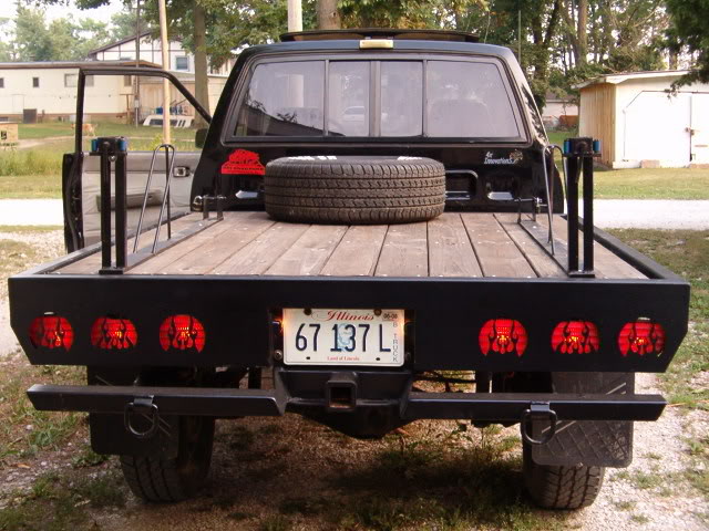

Heres the tool box we made not entirely installed but when it was done decking was placed on the lid so at a glance you wouldn't even know it was there.
You can see that the filler tube has been relocated to the drivers side in the other photos.

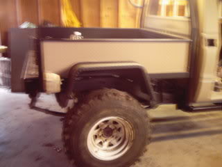

gmack192 -

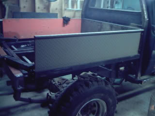

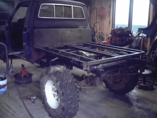

Post up some side pics of that golf tractor bed !! - awesome.
I made the headache rack w/ highlift jack mounts, in place of the square tube that was originally there. for the fenders I used steel tread plate trailer fenders from STURDYBILT ( and they are) I cut out the sides of the bed to match the lines of the fenders. to mount the bed to the truck I used 1x1 square tube, mounted to the factory front and rear mounts. The original floor was rusted out, so I replaced it with new tread plate. I wish I knew what kind of golf course tractor the bed came off of it was orange .
