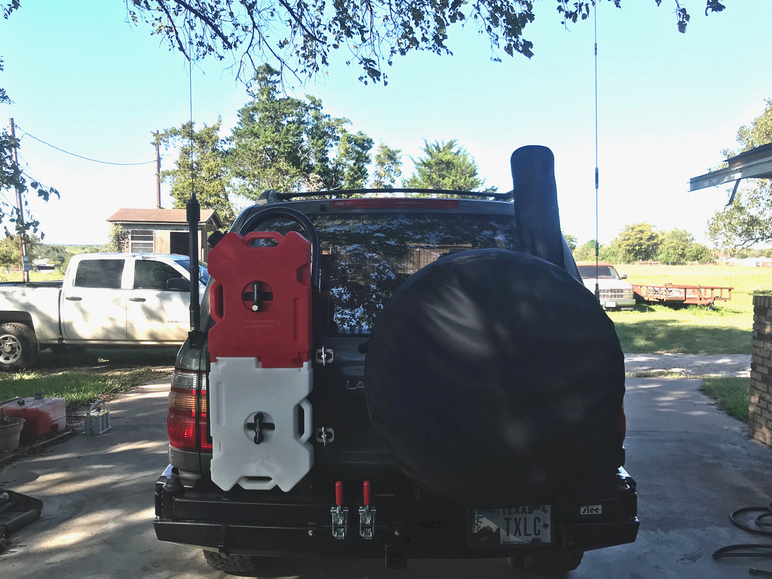

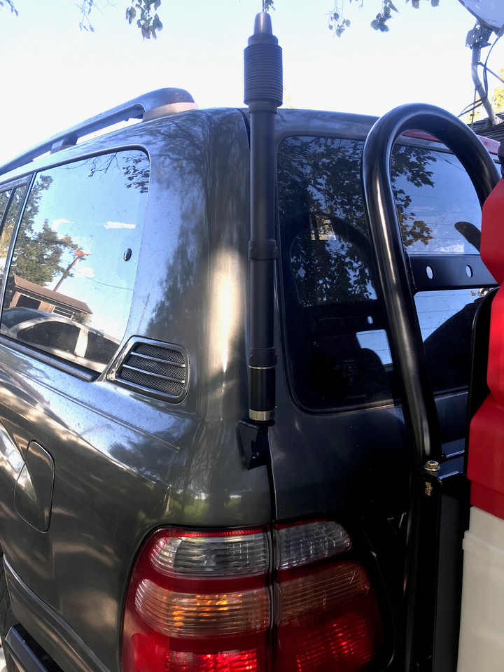

I ended up going with a 1/4 wave. I live at the foothills of the Appalachian mountains in Alabama. (LITERALLY the house across the street at the bottom of the hill where Choccolocco mountain offroad park is)
That being said, installed antenna and mount today. Now I have to source a cable and app to program this radio with.
It's close enough to the roof that you will get some ground plane from it, but I would check the SWR with a decent antenna analyzer before transmitting if I were you.
It has been by luck that low tree branches seam to catch the passenger side antenna no matter how small it is. I have an antenna on both sides of my rear hatch on my usual driver and I put the tallest on the driver side.

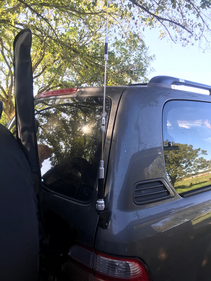

The antenna comes NMO or SO239 (mine is SO239). The antenna is made by Comet. Already noted but you only need 2m. I think I bought mine from DX Engineering.
Installation photo:
2m / 70 cm
HF ATAS (not installed at the moment)
Both
