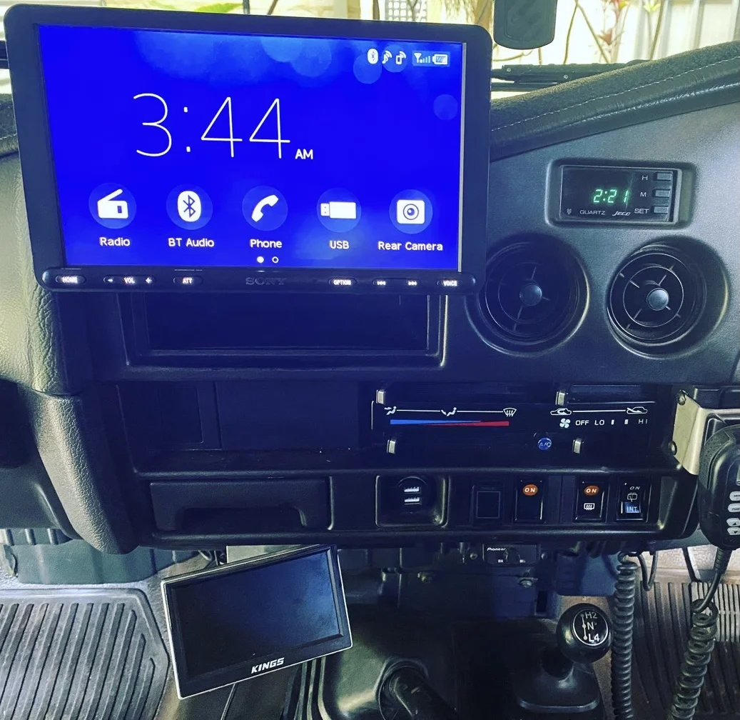

This is the Sony unit I installed into my HJ61. I didn’t want a double din unit as I place my wallet in the storage compartment underneath, and didn’t want to lose this space… I absolutely love it!
This is the Sony unit I installed into my HJ61. I didn’t want a double din unit as I place my wallet in the storage compartment underneath, and didn’t want to lose this space… I absolutely love it! View attachment 2974957View attachment 2974963

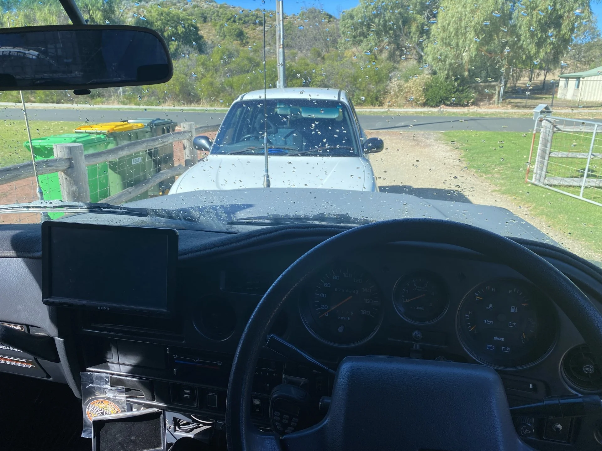

From my eye level when driving, the top of the screen of the Sony is level with the bottom of the windscreen - so doesn’t hinder vision at all (and I am short…)
Looks nice! And no issues with vibration or jolting on rough surfaces? The HJ61 dash is pretty different from the FJ60 from memory (unfortunately it's been awhile since I've seen mine from the driver's seat)

Thanks for posting this. This is actually the one I'm planning to get for my FJ60. It was either this or the Alpine....but really didn't want to pay $900 for the Alpine. Any issues installing it? It was strange, Crutchfield said that this unit would not work in the FJ60, but the Alpine iLX-409 would. Both are single din units.

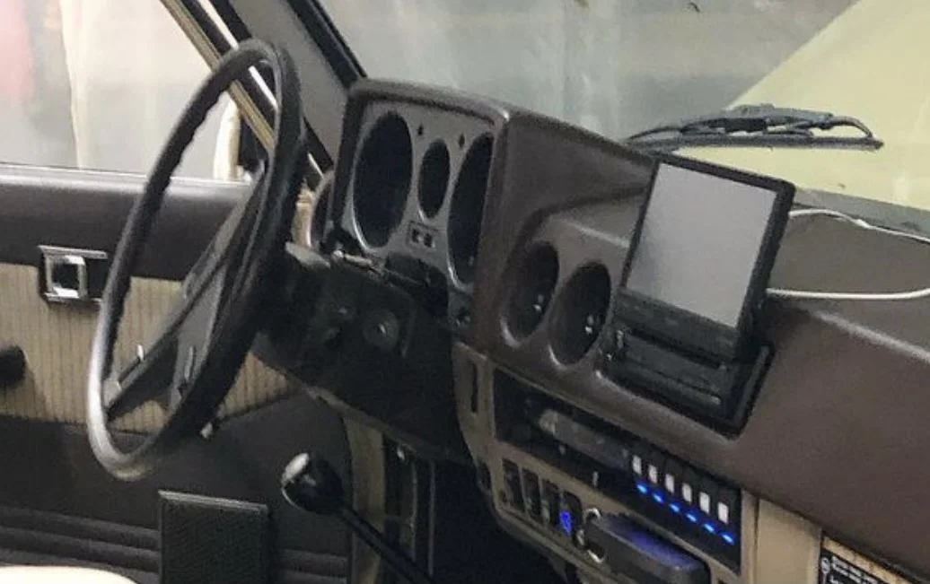

This guy did a flip out screen single din unit which he said is a Kenwood. Would be nice in that the screen folds into the body of the unit.
This guy did a flip out screen single din unit which he said is a Kenwood. Would be nice in that the screen folds into the body of the unit. View attachment 2975550View attachment 2975551
that type of setup would actually make me more nervous. The thing I like about the Sony is the bracket that connects the screen to the body is very stout...and will most likely take the bouncing around much better. I would think this setup would make the potential for the screen to get damaged much higher (since the brackets aren't fixed). Just mho.

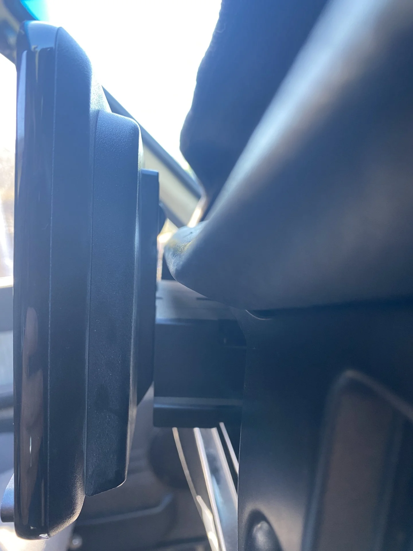

The Sony is fixed solid! I travelled on the Gibb River Road - which is one of the most notorious dirt roads in the North West of Western Australia and it didn’t move / shake etc at all!

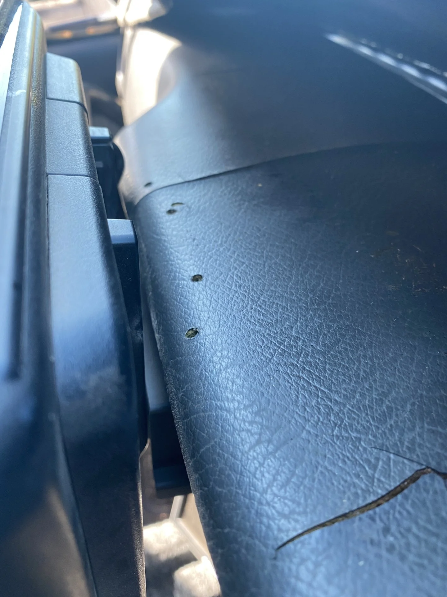

According to the instructions it won’t fit as the dash pad protrudes too far out from the single din ‘hole’. I ended up drilling 2 tiny holes through the dash pad to fit a small screwdriver in to make it easy to screw the screen-securing screws in (my dash is cracked anyway, and has a dash mat over it…). I spoke to someone else who used small machine bolts instead and didn’t drill through the dash.
To me, it couldn’t be a better fit!
Here are a few pics. One from my driving position showing it doesn’t intrude into the view, one of the clearance behind the screen to the dash, and one of the holes I drilled (unsure why there are 4! - must have made a mistake first time around!!)
