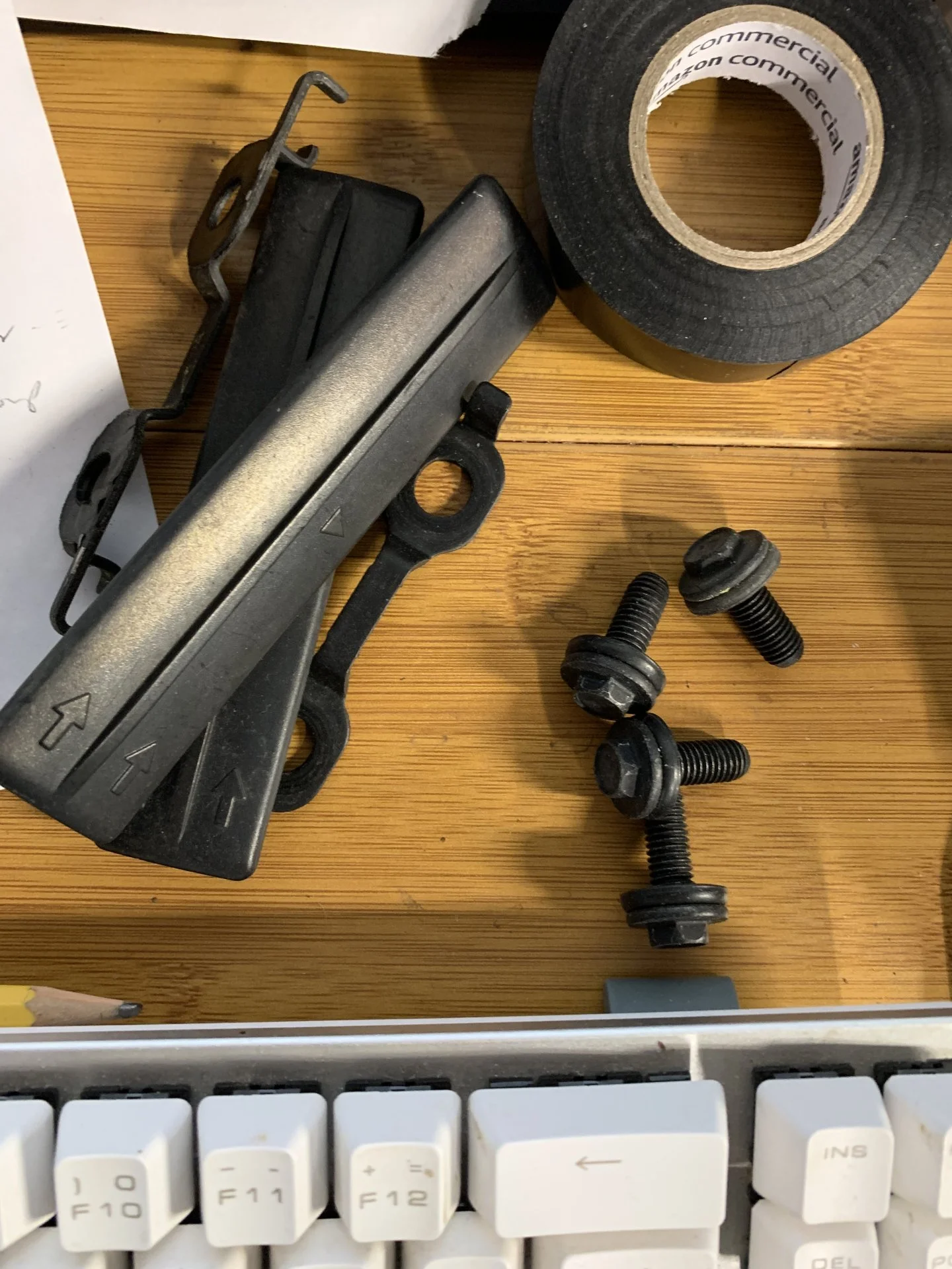

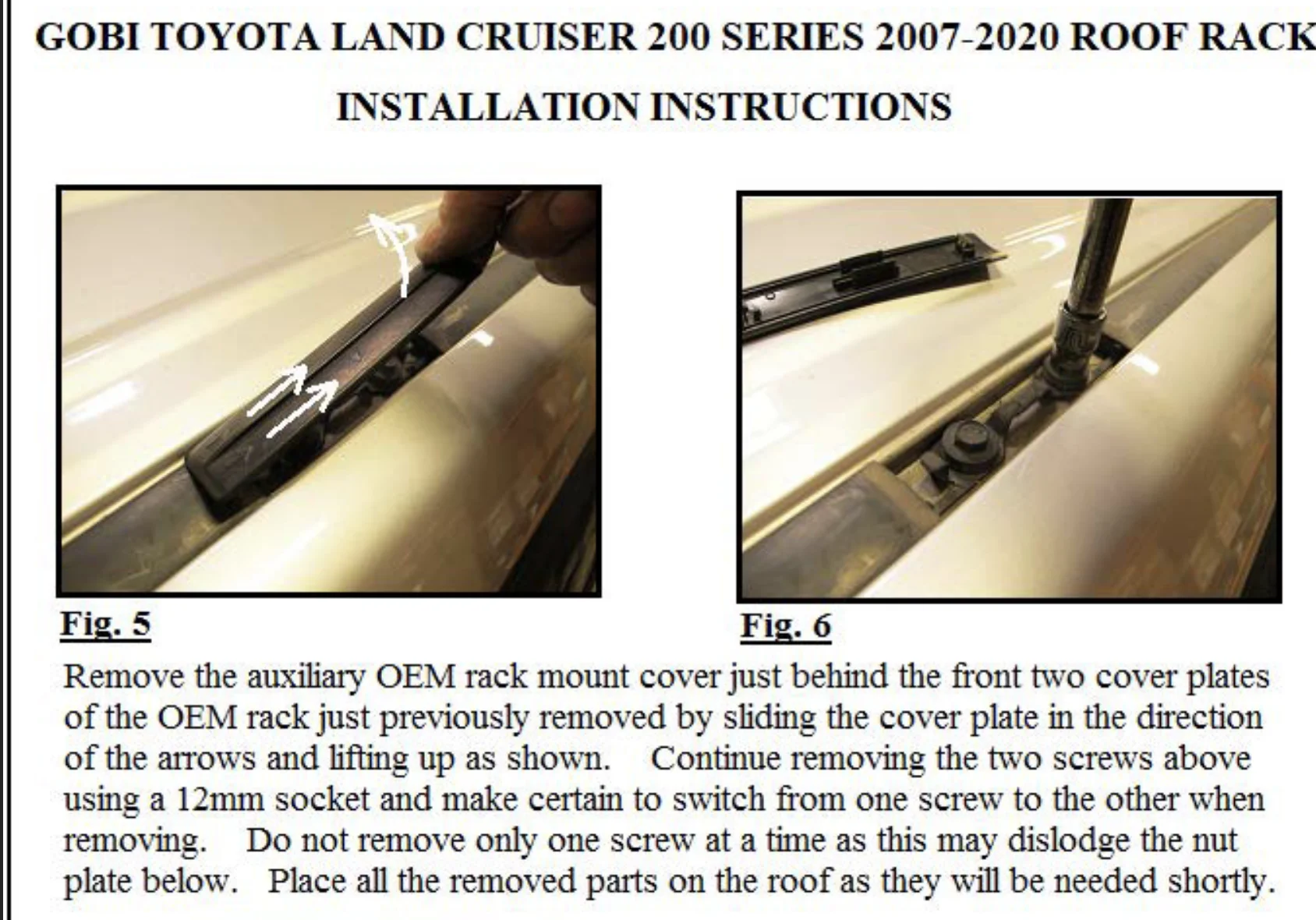

I posted last week in the "What did you do" thread about my roof rack. I had a FrontRunner installed by the dealer I purchased the truck from prior to delivery 3 yrs ago. Over the time I've had the truck I haven't been happy with having the sunroof opening blocked and some other features of the FrontRunner, so lucky for me, my wife and kids got a Gobi to replace it. Removed the FrontRunner and then after reading the GObi instructions, realized I'm missing an OEM part - the "OEM Auxillary rack mount cover" that comes on the truck covering the 2 bolts for a mount point just behind the forward most location the OE luggage rack mounts. Cant find the part in any of the online parts catalogs, and need it to install the Gobi.
ANYONE know what this part number is? Better yet, anyone have a couple they pulled off their 200 and want to sell?
I'm attaching a picture (shows the "spacers" I'm removing from the FrontRunner and the location of the "OEM Auxillary rack mount cover" circled in red) and also a shot of the reference from Gobi.
ANY HELP APPRECIATED!!! My truck is sitting in the garage with a naked roof waiting for these pieces....and local dealership has NO IDEA what I'm looking for.

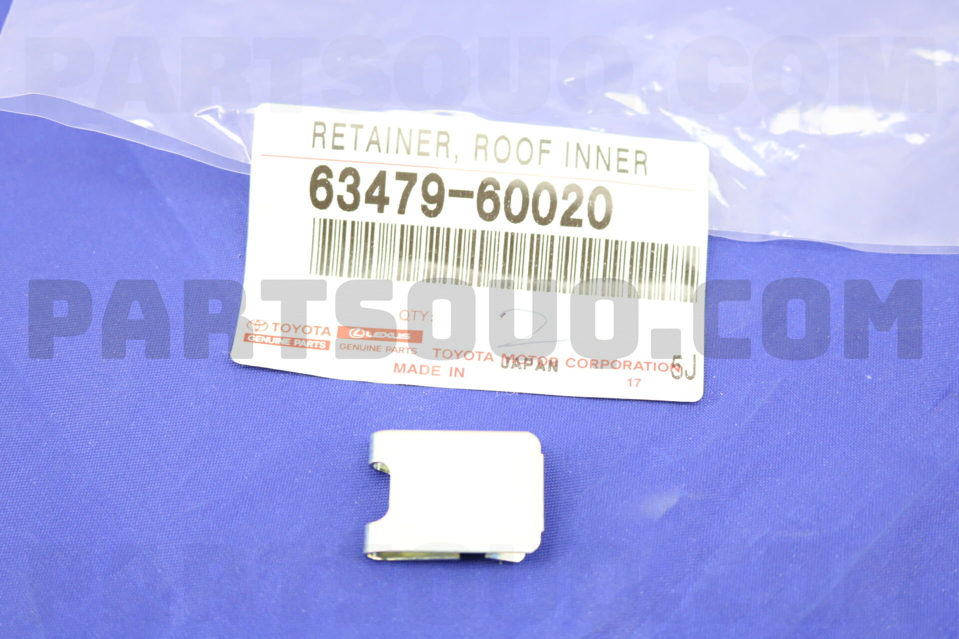

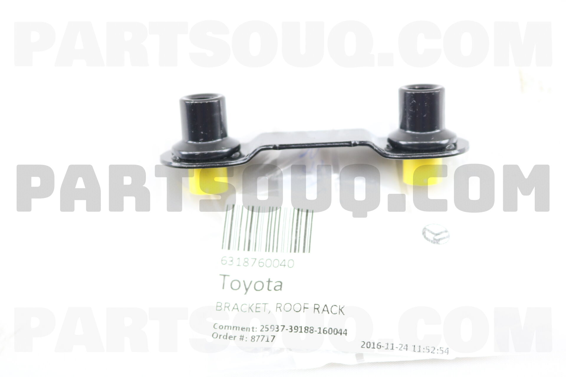

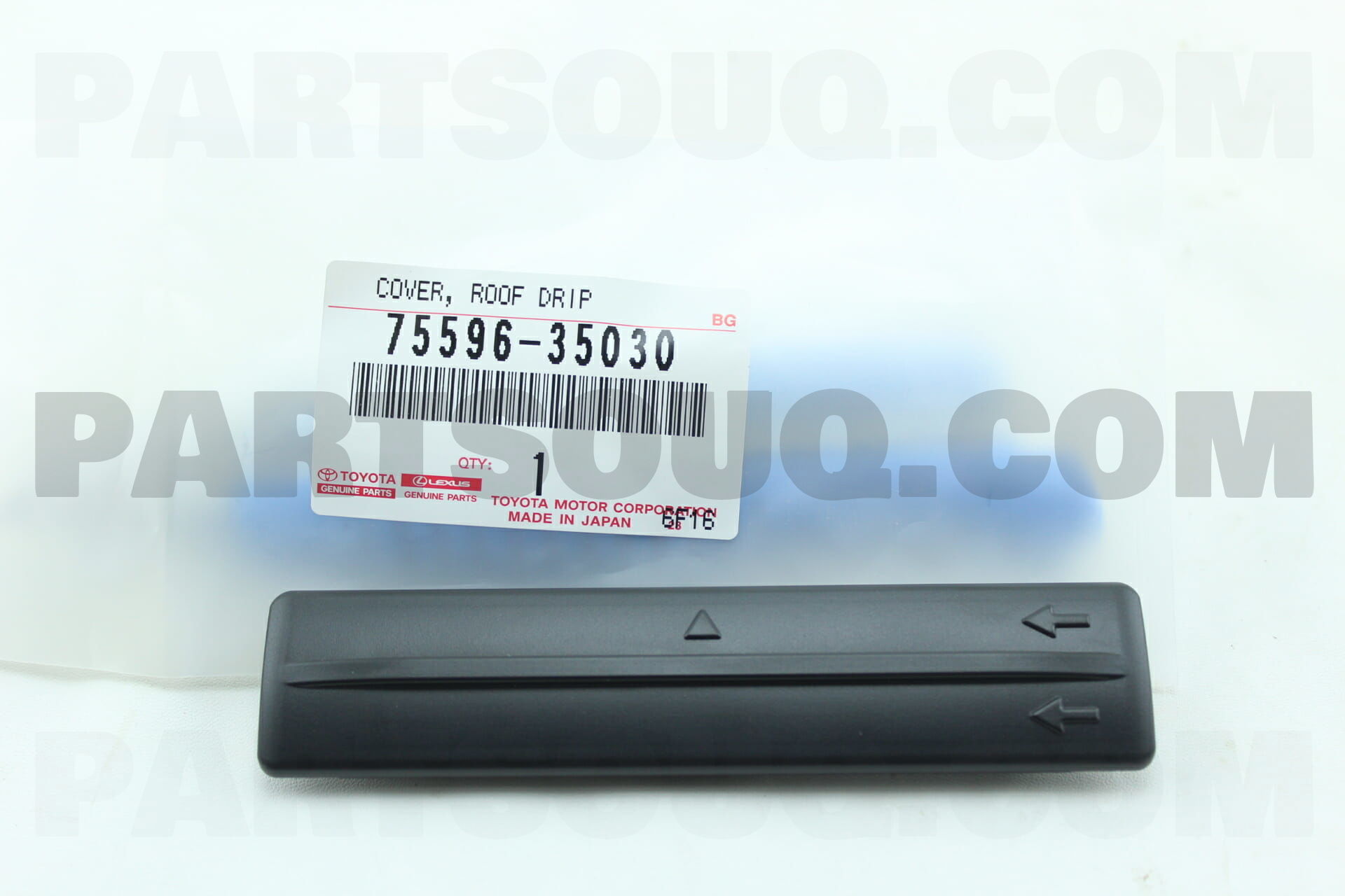

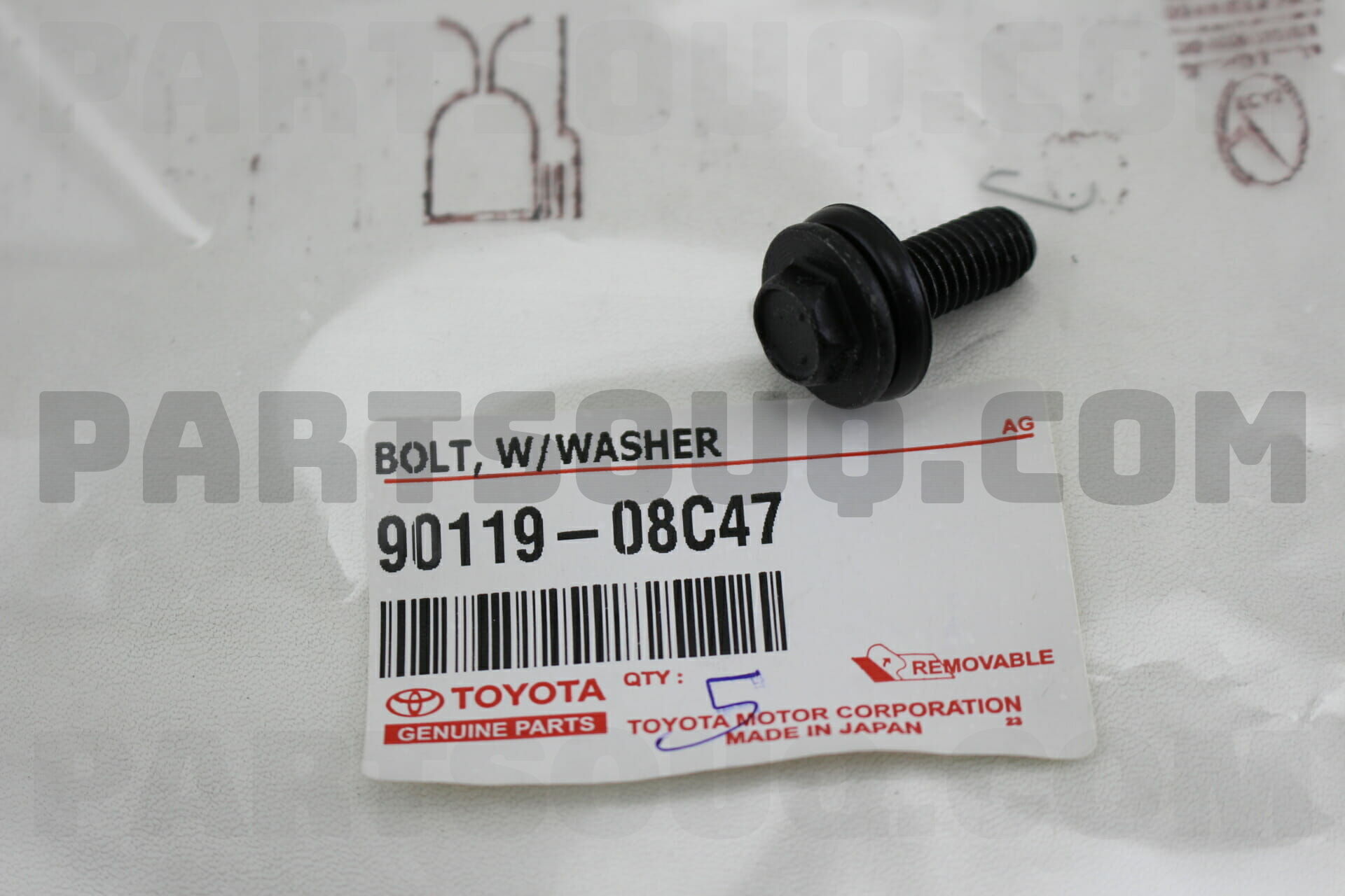

For future reference, here are the parts:
The parts diagrams list a left and right part for the cover, but all the parts DBs i checked only have one replacement part listed for both the left and right one. It also appears to be a Toyota universal part that came on just about every vehicle that has some sort of roof rail system option in last 20 years.
There is a seal available that is technically for the OEM rail brackets, but i suspect if your 63185-42020 was being reused and you wanted to replace that seal rather than just use RTV, it could be used in that place.

Bolt/Washer: 90119-08C47
Cover: 75596-35030

Nut Bracket: 63187-60040
Dreaded Clip: 63479-60020
