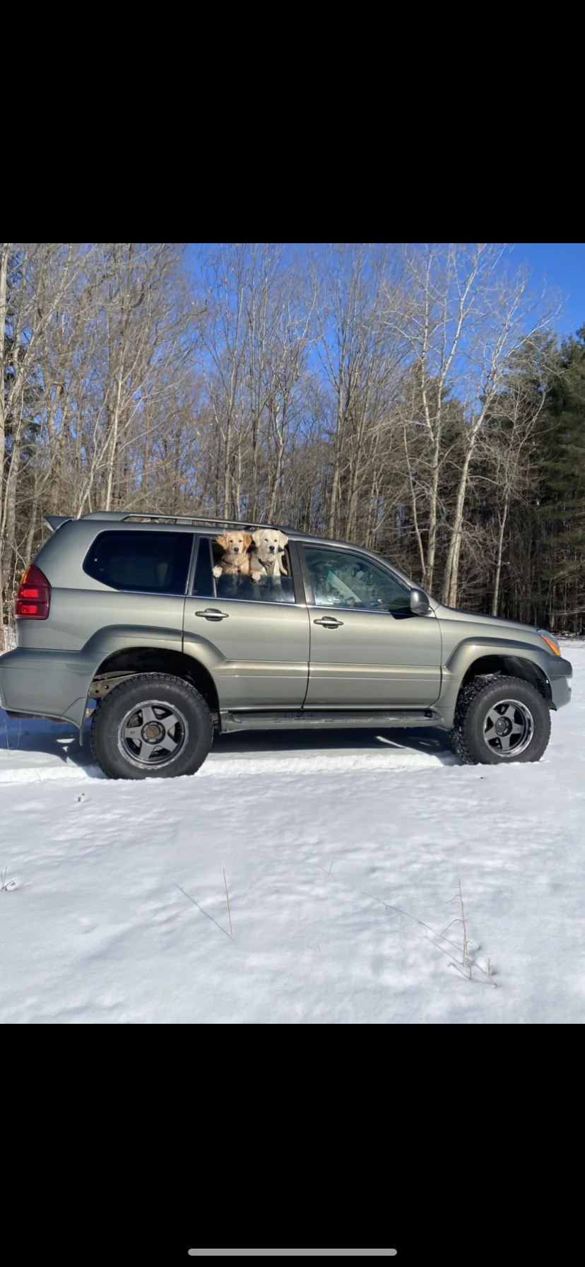

Hey guys, hopefully someone can identify this noise that’s driving me insane!! I’ve attached a short video clip where you can hear it clunk/clank twice. I hear the noise randomly all the time. It happens when braking,not braking, turning, going straight, over little imperfections, over big imperfections, taking off from a stop, coming to a stop, and at all speeds. I have a dobinsons ims 2.5” lift and Ironman uca’s. Within the last 10k miles I’ve replaced a lot of the front suspension with all OEM, including LCA’s, inner/outer tie rods, rotors, pads, shims,caliper pins, retaining clips, sway bar bushings/links, Blue Pit wheel bearings, and changed transfer case/diff fluids. Also CVJ driver side cv shaft 15k miles ago. I removed sway bar and links along with skid plate to eliminate them causing the sound, no change. The previous owner never heard of a grease gun, you could see that a grease coupler had never touched the zero’s. I know it’s not the clunk from the rear slip yoke, but maybe the u joints on the front driveshaft? Please help . I love this thing, but it’s starting to sketch me out. Thanks
