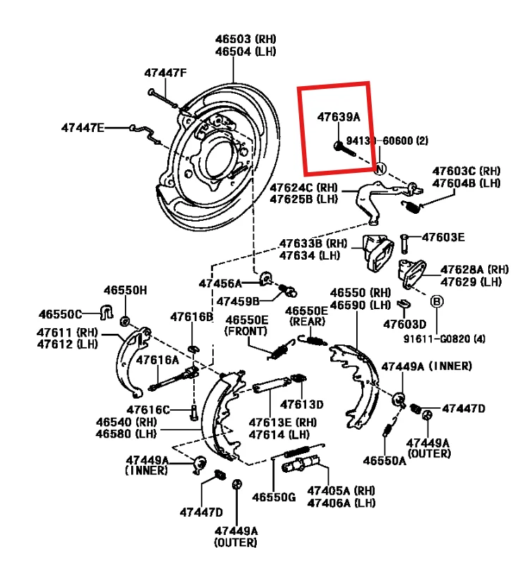

The park brake assembly can rattle. there are a couple of rubber bump stops that should land on the back of the backing plate (i.e. you can get to them without taking everything apart) when the handbrake is disengaged to stop the mechanism rattling around. Worth checking as they worked for me.
