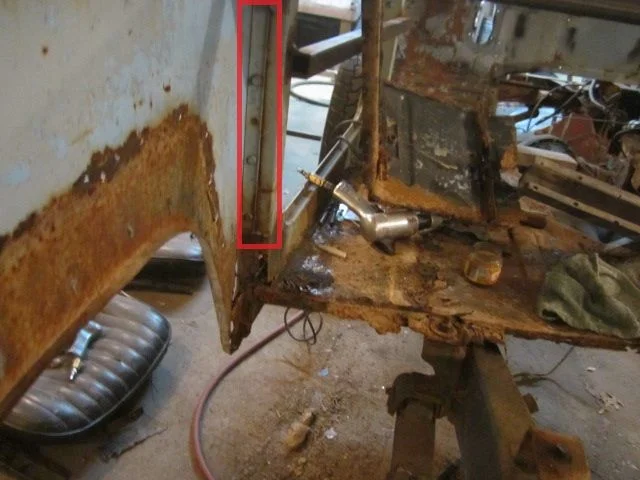

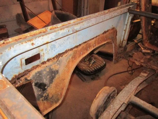

Here's a few pics of my current punishment. The rust on this truck has rust.:bang:
