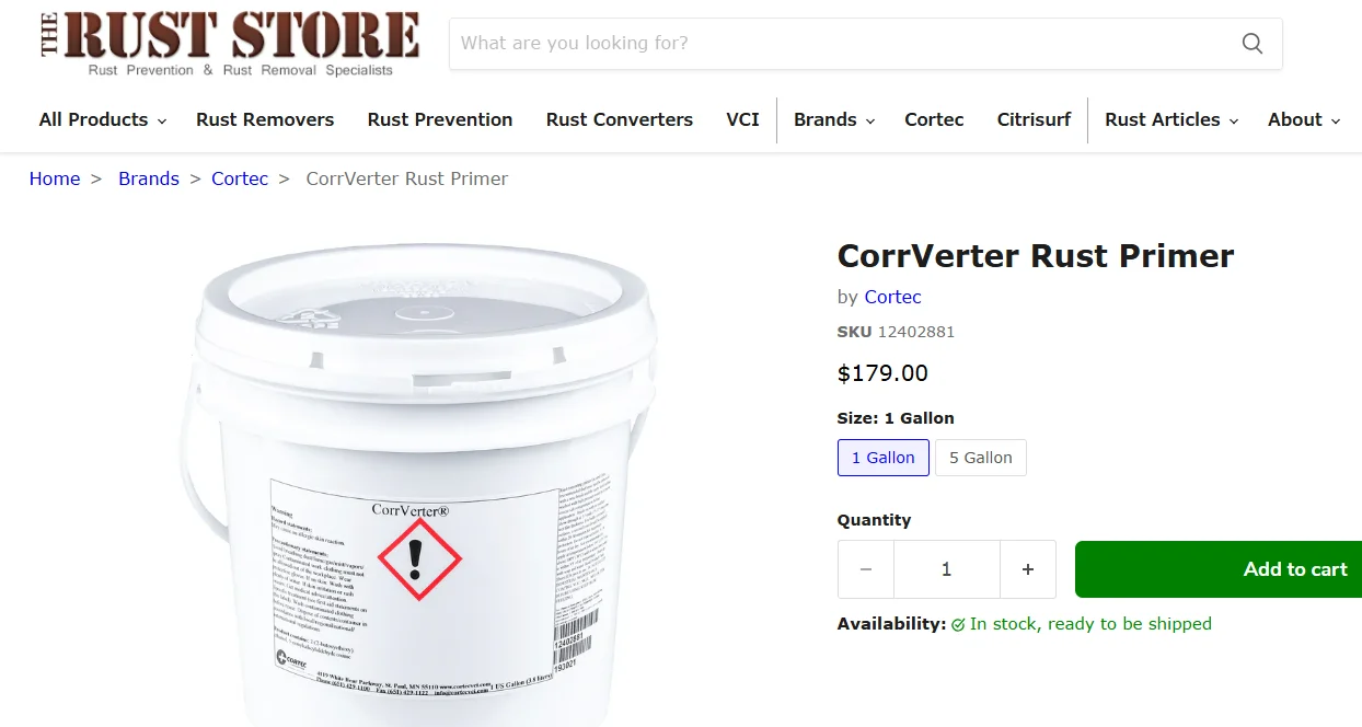

I'm planning on using this on my 40, when the body comes off later next month.
CorrVerter Rust Primer
It's spendy, but I do not want to do this job twice, and I have other sheetmetal that needs it.
I'd rather use Corroless, but I can't find it in the states.
