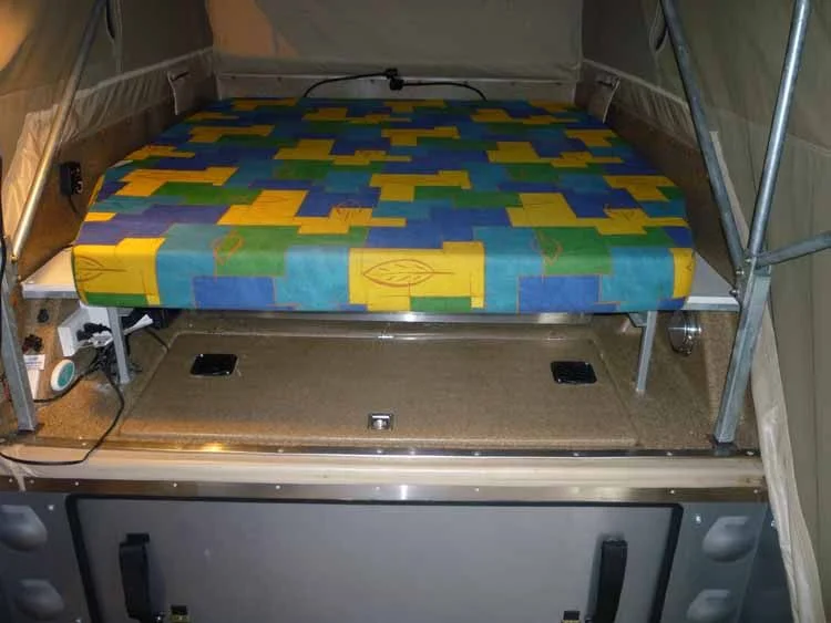

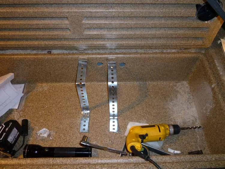

The Heatsource came and it was time to figure out where to install it. Unfortunately, it's a bit wider than the Diesel heaters so it wouldn't fit under the bed on the sides. After a few . . .beers and a cigar, I decided the only place it would fit is the storage box under the bed. The next dilemma was how to route the hot air and return lines.
I finally decided to avoid more cutting on the underside, to route the hot air and return lines to the lid

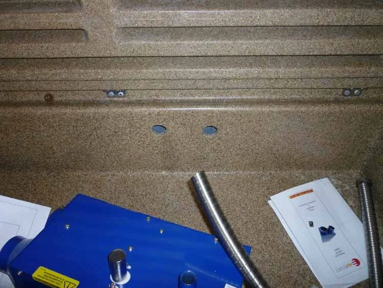

Now the nervous part. Cutting holes in my new camper.
I first cut two holes out the back of the area for the exhaust and combustion air inlet. Next cut two holes in the lid and used a dremel to open the hole to fit the covers
In the second picture, you can see how thibk the lid is
Finally, drilled more holes for a robust mounting bracket. Don't want this bouncing around offroad

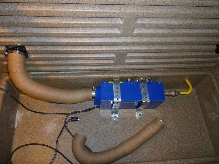

After getting the hoses installed onto the unit, I installed it and bolted it in, drilling another hole for the propane line
I am short hose to reach where I put the air inlet, I'll order some more.
The combustion lines wrap around the underside and face the rear
The gas line connects to a propane hose and runs up to the tank. I had a custom 12 foot hose made, but got a pipe fitting end instead of a flared end to connect to the yello hose you see in the pictures. I'll take it back and get it modified. I put a seperate valve on the propane so there would only be gas in the line when I want to run the heater
I installed the temp controller just above the mattress, I used Velcro until I am sure thats where I want it.
You can see the controller in the left of the last picture and the air vent covers on the top of the storage box under the bed.
I made a groove with my dremel on the left side for the cords to run up by the lid with it remaining closed
Can't wait to get the hose replaced and test it

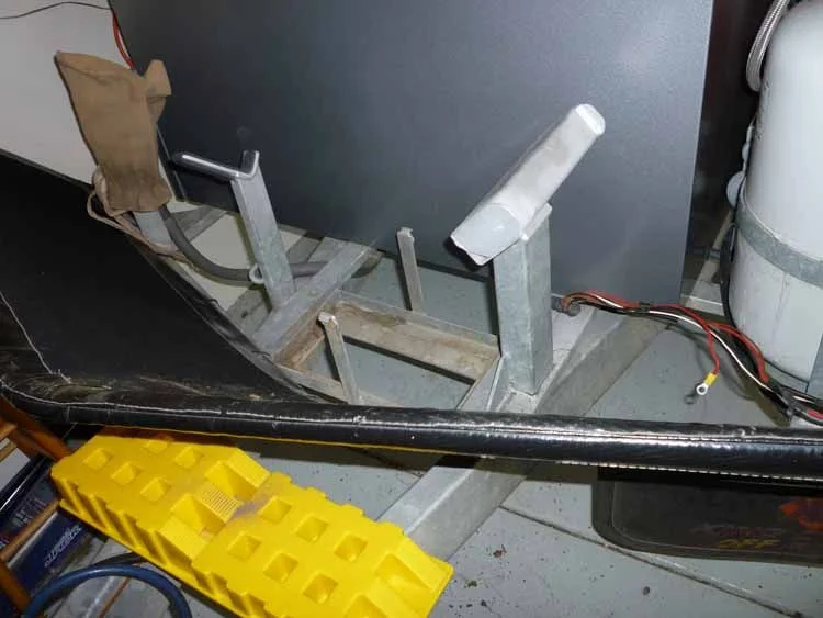

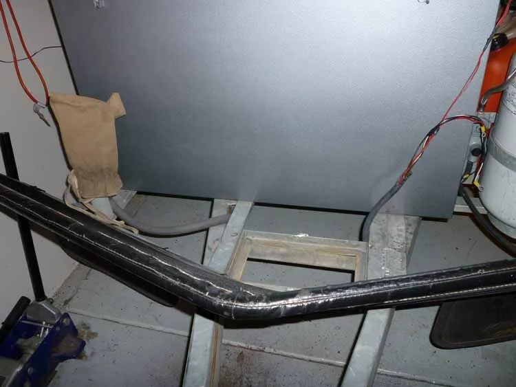

The Kimberley comes with mounts to put your outboard motor. Since I don't have one, I decided to cut the mounts off and install dual batteries.

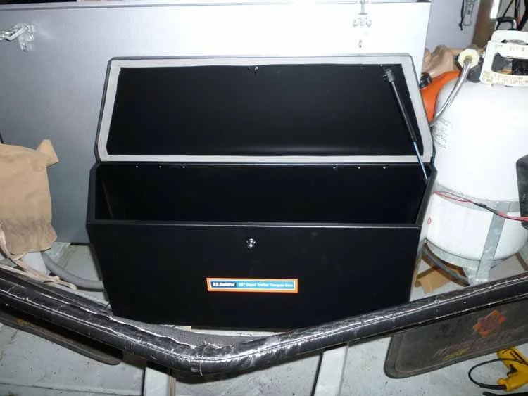

First chore was to find a box. I could not find a dual battery box for two group 31's. I couldn't find one via an Internet search. I walked into my local harbor freight looking for something else and found this for $80
This fits two GR 31's perfectly with a few inches to spare for some small stuff and a dual switch
First chore was to cut off the motor mounts

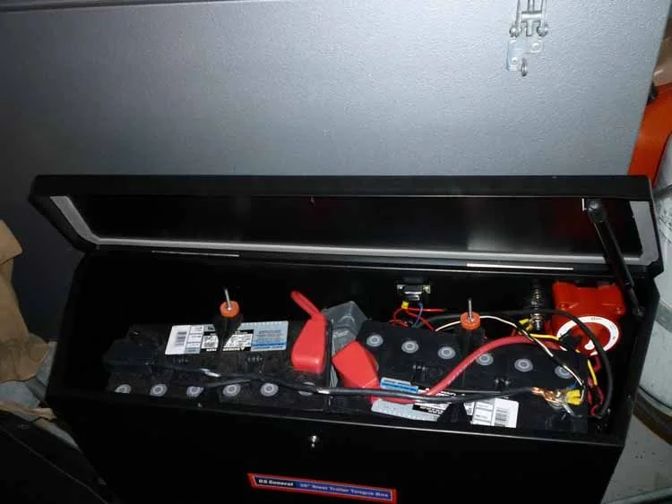

Next install the box, batteries and switch. I also put two 12Volt Marine aux outputs on the front you can see in the last picture
