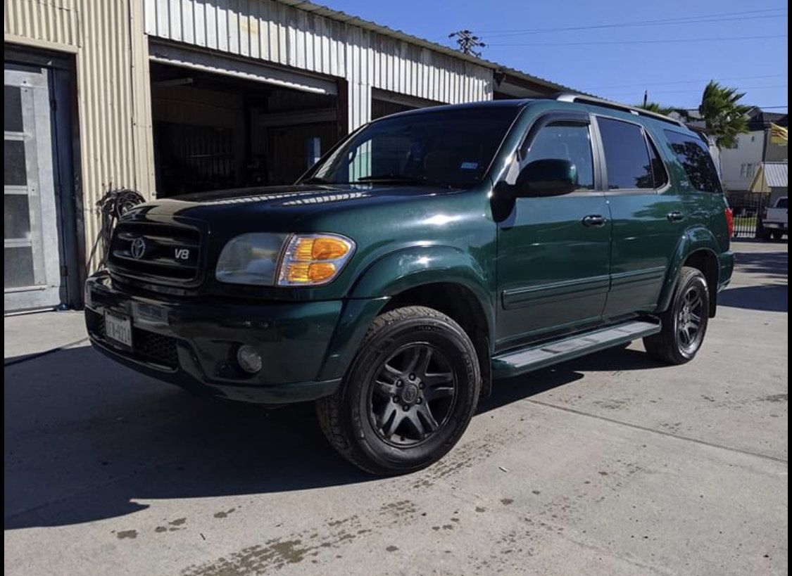

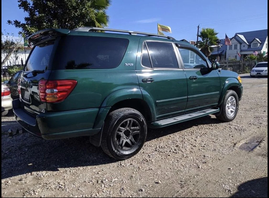

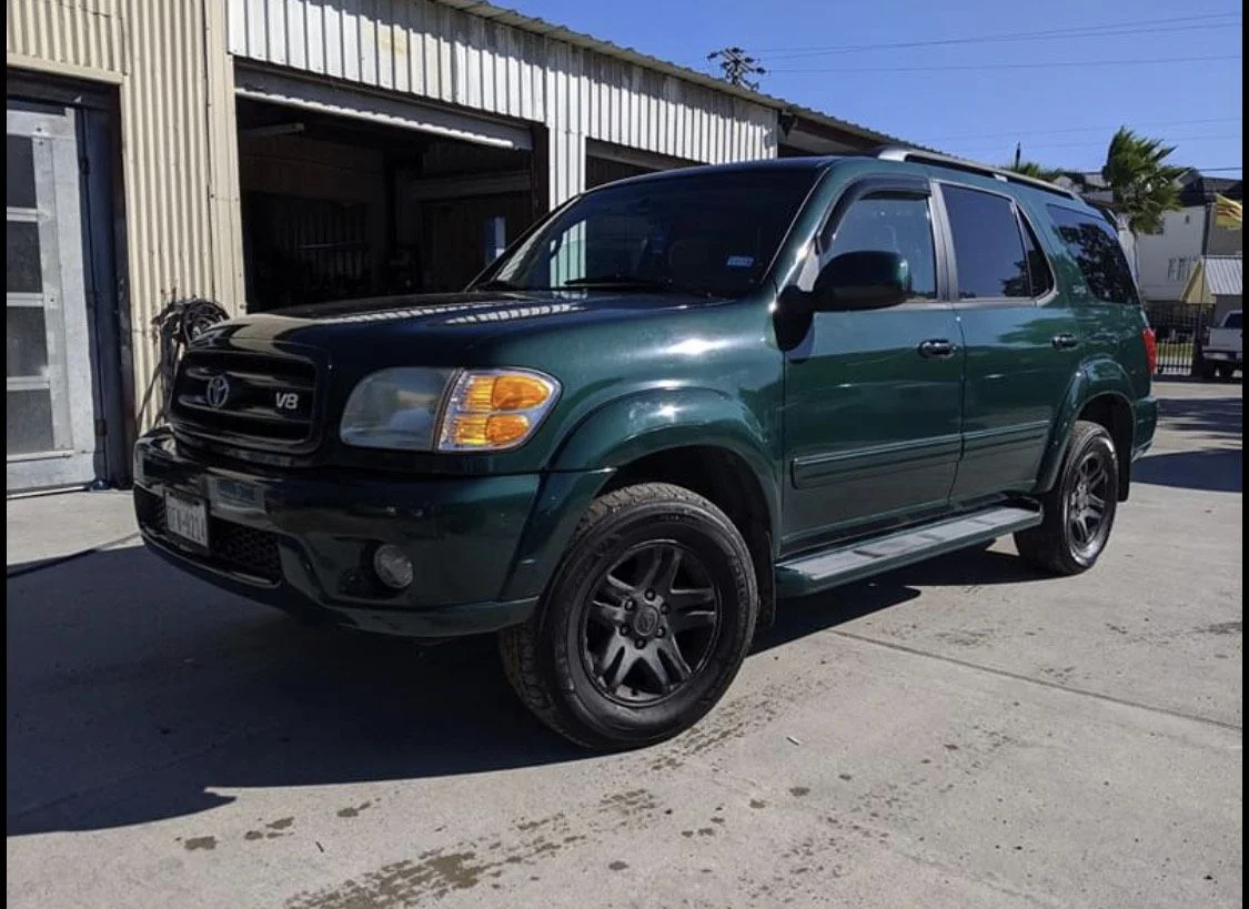

Here's how the Sequoia looked on Facebook marketplace before I bought it:
She's a 2WD (I know, I know) with 184k miles, I got her for 4100 cash which I felt was a pretty good deal at the time. Here are some pros and cons I noticed with the car:

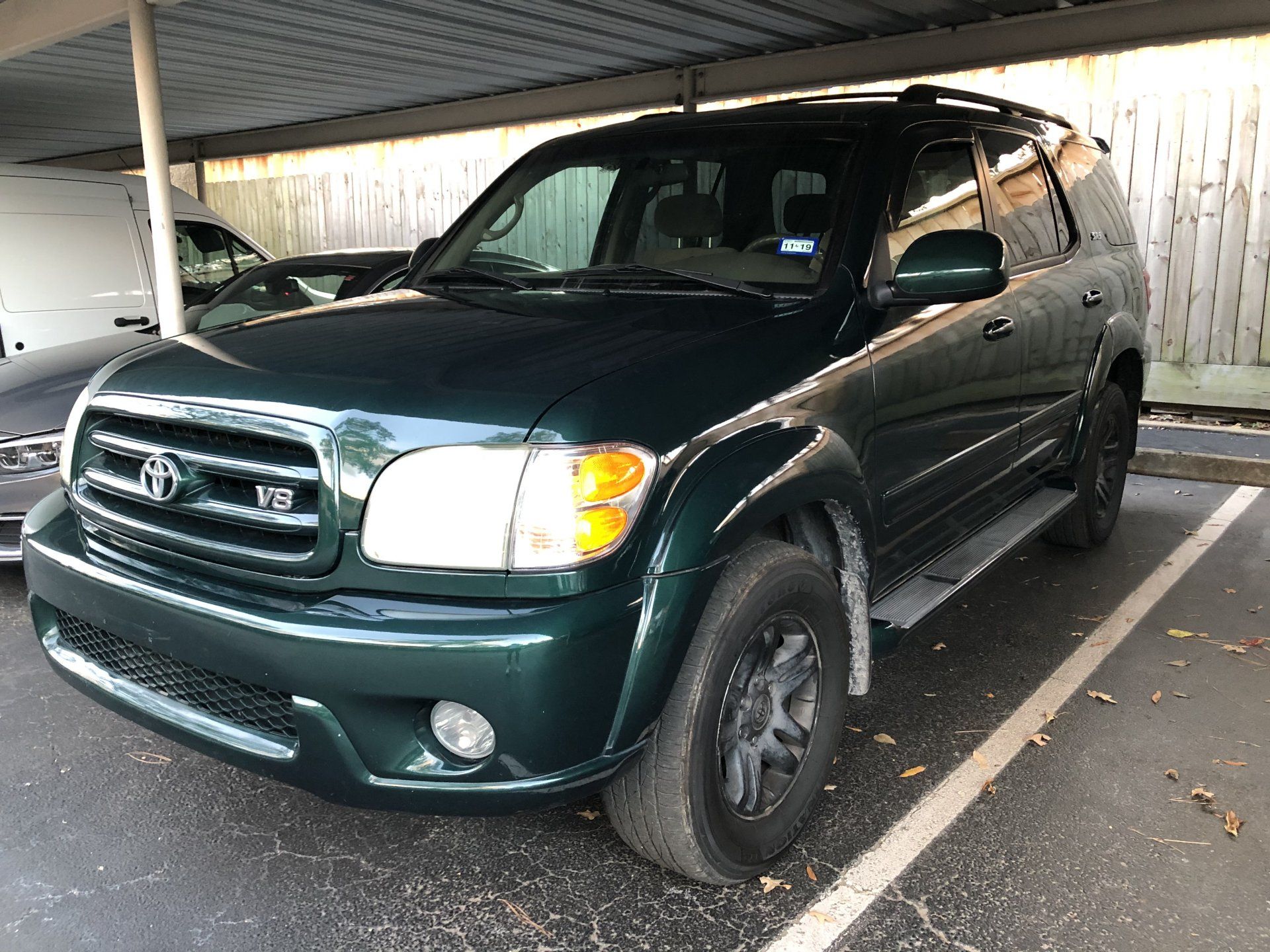

After I took her home, I gave her a nice wash and this is how she looked afterwards:
You can really tell how badly those wheels need a repaint.

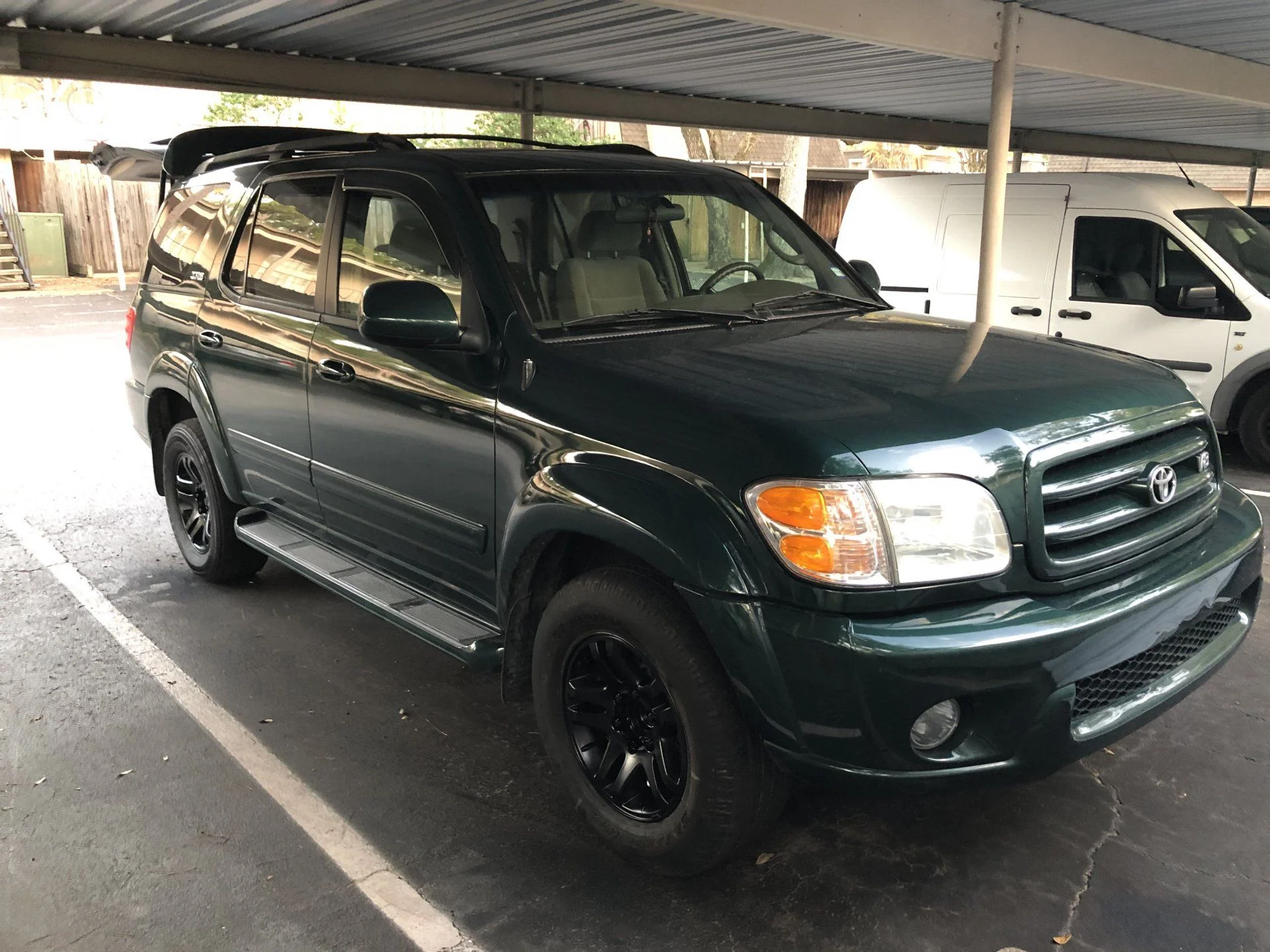

So, I went down to the local Home Depot and bought 4 cans of their Rust-O-Leum trim paint. This stuff is perfect, the gloss level is just right and the new paint instantly brought back some life into the car. If you're looking to do your wheels in black, I highly recomment this stuff. During this time, I also fixed the leaky valve covers in a garage with a friend. Took around 3 hours and while the valve covers were removed, the engine looked perfect and had zero sludge build up, sadly, I got no photos of this as I was working with a friend.
Here's how the car looked after the new paint on the wheels.

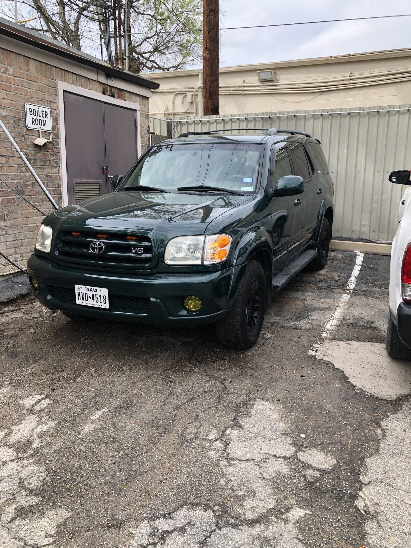

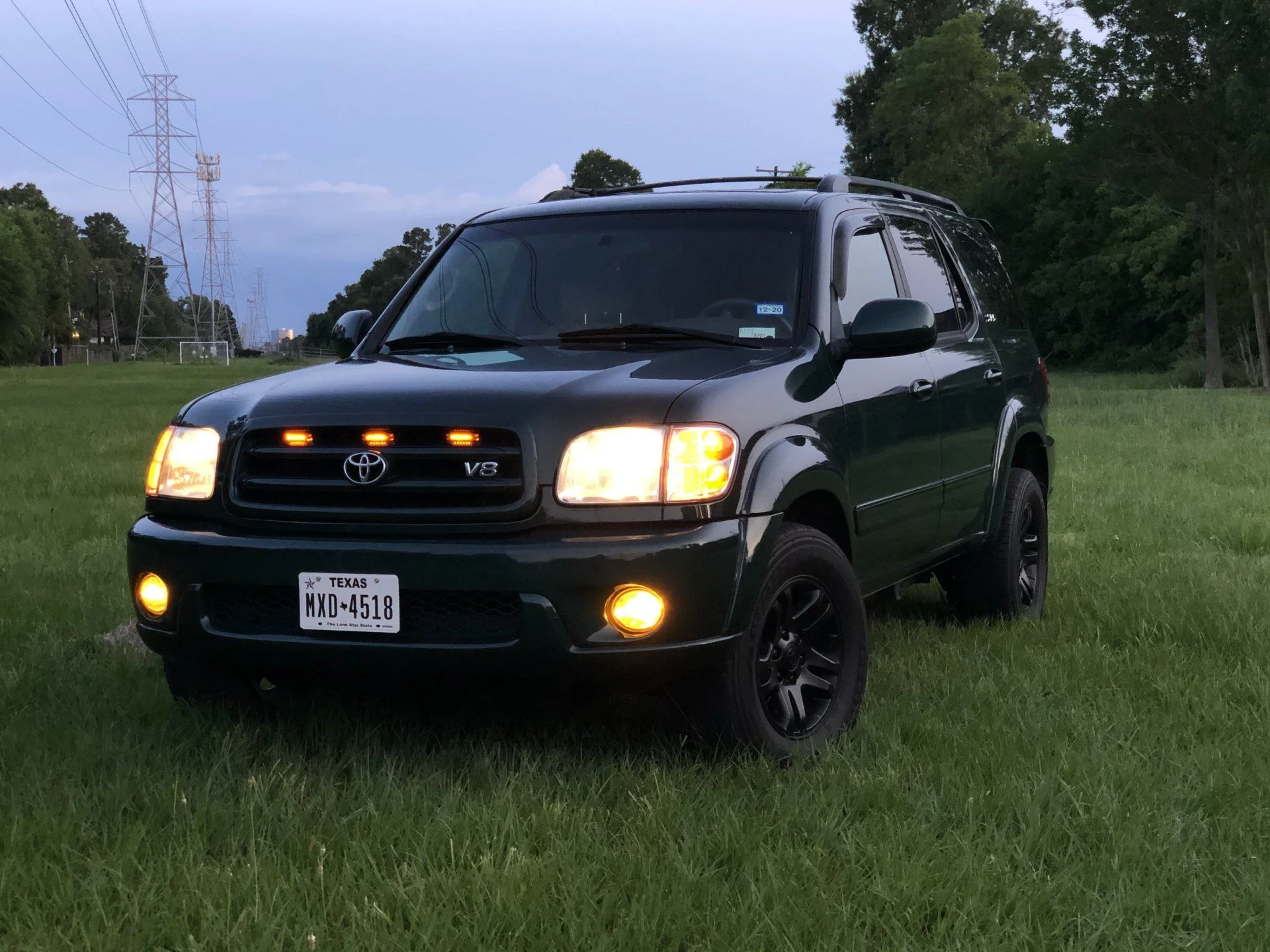

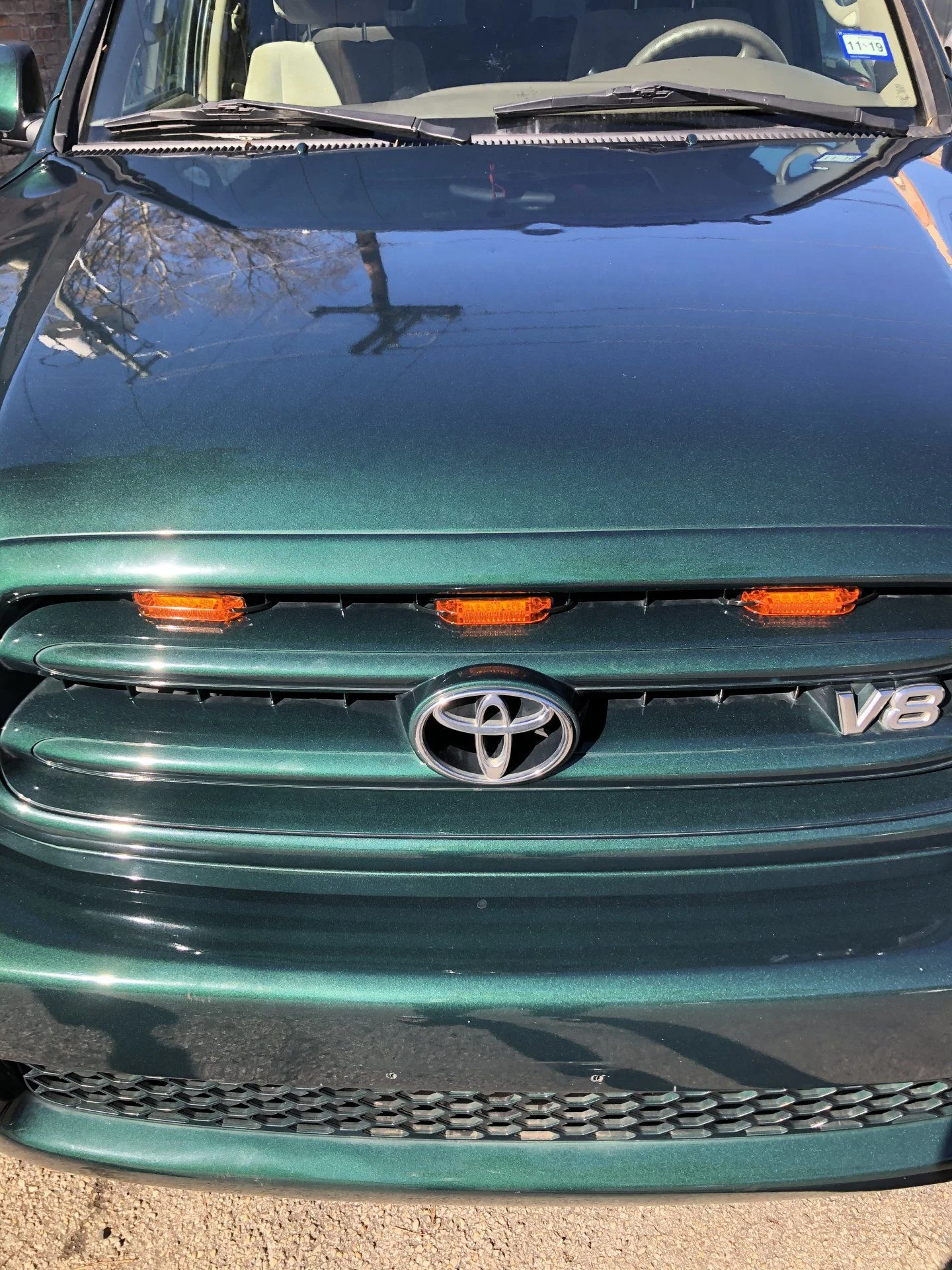

First, I installed some marker lights to the grill because I thought they looked pretty cool. Inspired by the ford raptor of course but I opted for the "line" styled marker lights instead of the dot styled ones on the raptor.
Install was pretty straight forward. I zip-tied them onto the grill (perfect size) and tapped into the parking light for power. This way when I have the parking light or main headlight on, the markers come on and I can turn them off anytime I want. If you want a similar mod, I definitely recommend these Grand General Markers. They have been on the Sequoia for a year now and still works perfectly with zero condensation; the size is perfect too.

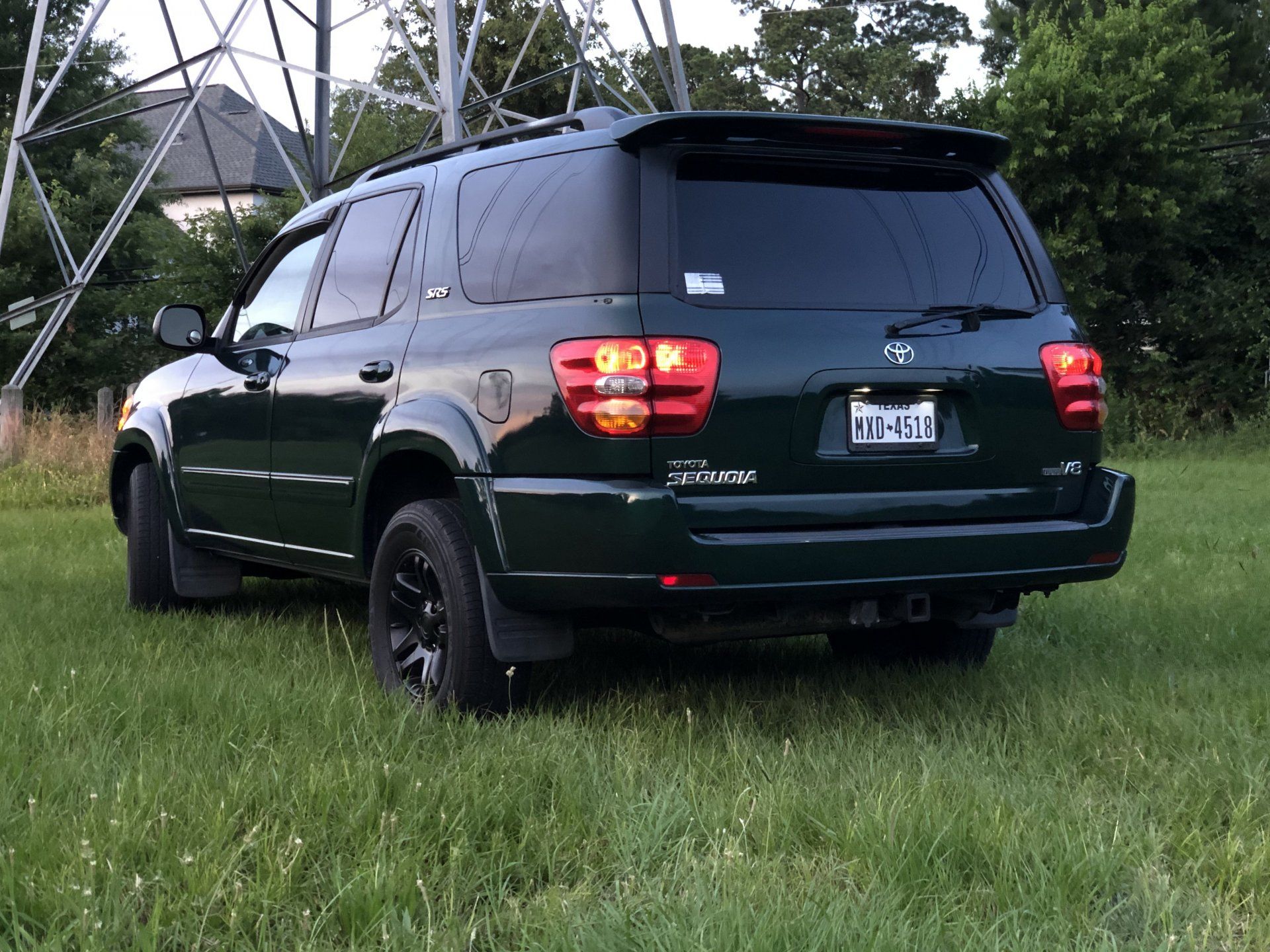

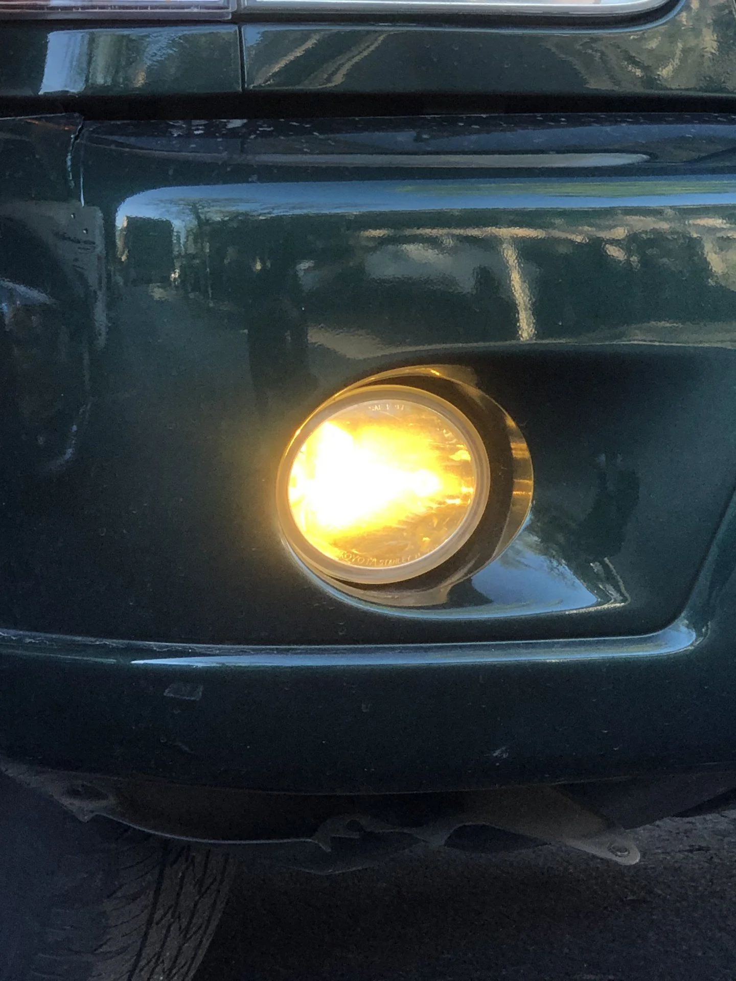

Continuing the theme of lighting, I installed new fog lights, parking lights, and reverse lights. For the fog lights, I went with some yellow Hella bulbs and put a yellow film over the light, and for the reverse lights and parking lights, I just went with cheap Amazon LEDs which are still working perfectly a year later.
I feel like the yellow tinted fog lights + the LED marker lights made the car look way more agressive, definitely not a mod I regret doing.

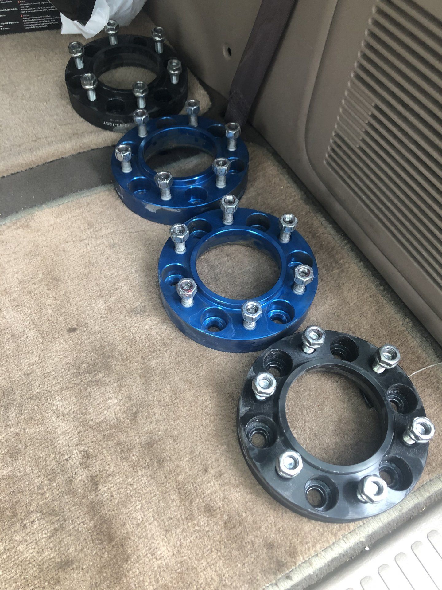

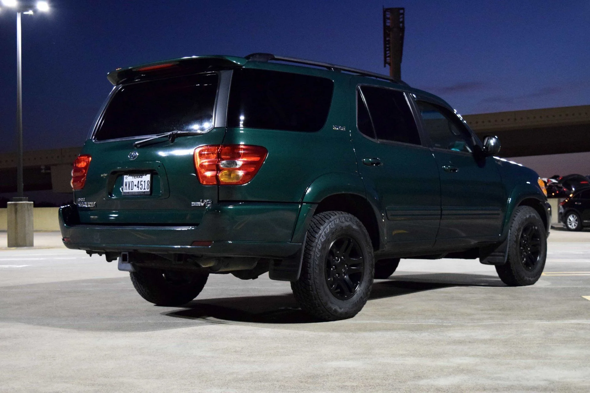

While looking through Facebook marketplace, I found a set of spacers which were an absolute steal, ($80 for 2 G2 spacers and 2 Spidertrax spacers) so I had no choice but to buy them.
Install was easy and I used Loc-Tite for safety. After the spacers install, I also removed the side steps (4 bolts each side) and sold them for $40. The 1.25 inch spacer made the wheels perfectly flush with the fenders which drastically improved the looks; and the side step removal made the car look more aggressive and less like a soccer mom hauler.

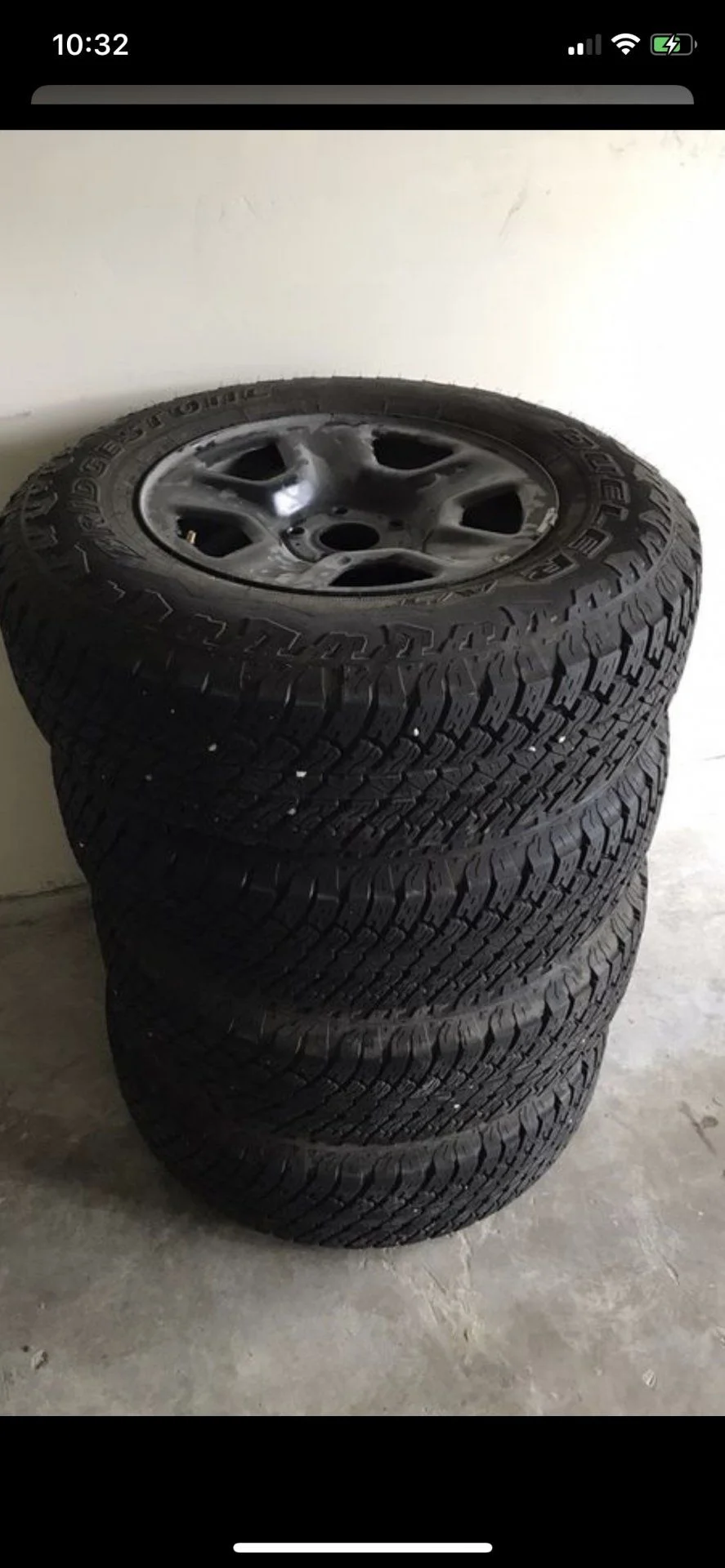

At this point I was looking for a more aggressive A/T tire to put on the Sequoia. While browsing on Facebook marketplace, I came across this set of wheels and tires for a Jeep Wrangler for $150, tires were at 80% tread and those wheels alone were worth $150 so I hopped on the deal. I ended up selling the Wrangler wheels for $100 and using $60 to get to tire shop to install and balance the tires for me. These tires are 245/75/17s which are taller but thinner than the stock 265/65/17s, I frequent dirt and gravel roads and these tires handle very well on them.

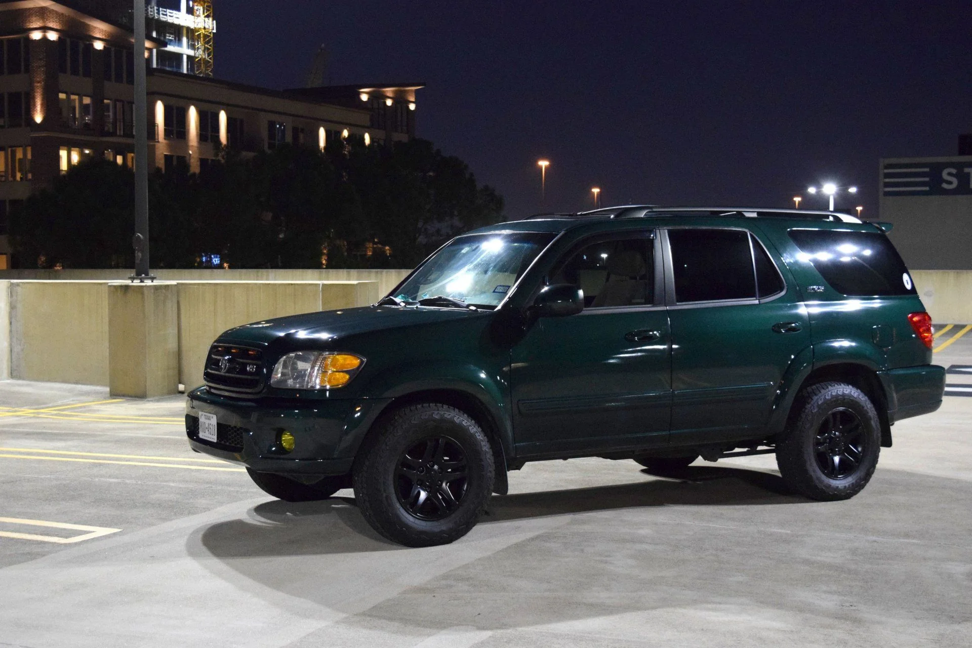

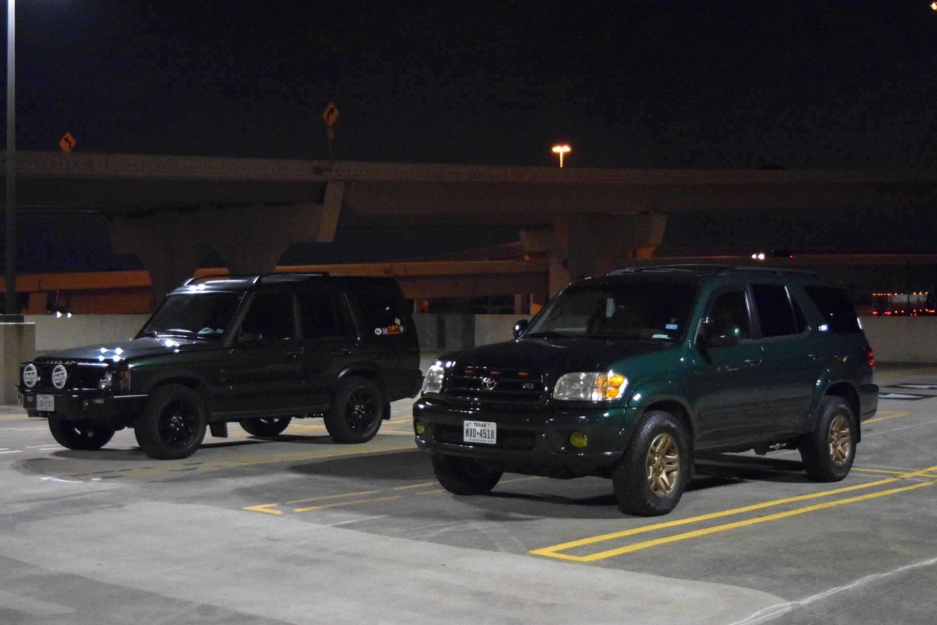

At this point, I was about 10 months into owning the Sequoia with black wheels and was kind of growing tired of the color combination. So, I ran down to Home Depot again and bought 3 cans of Antique Brass spray paint to paint the wheels a bronze/gold color. The results were decent for a spray can job. There are some drips and imperfections, but looks good if you don't look too closely.

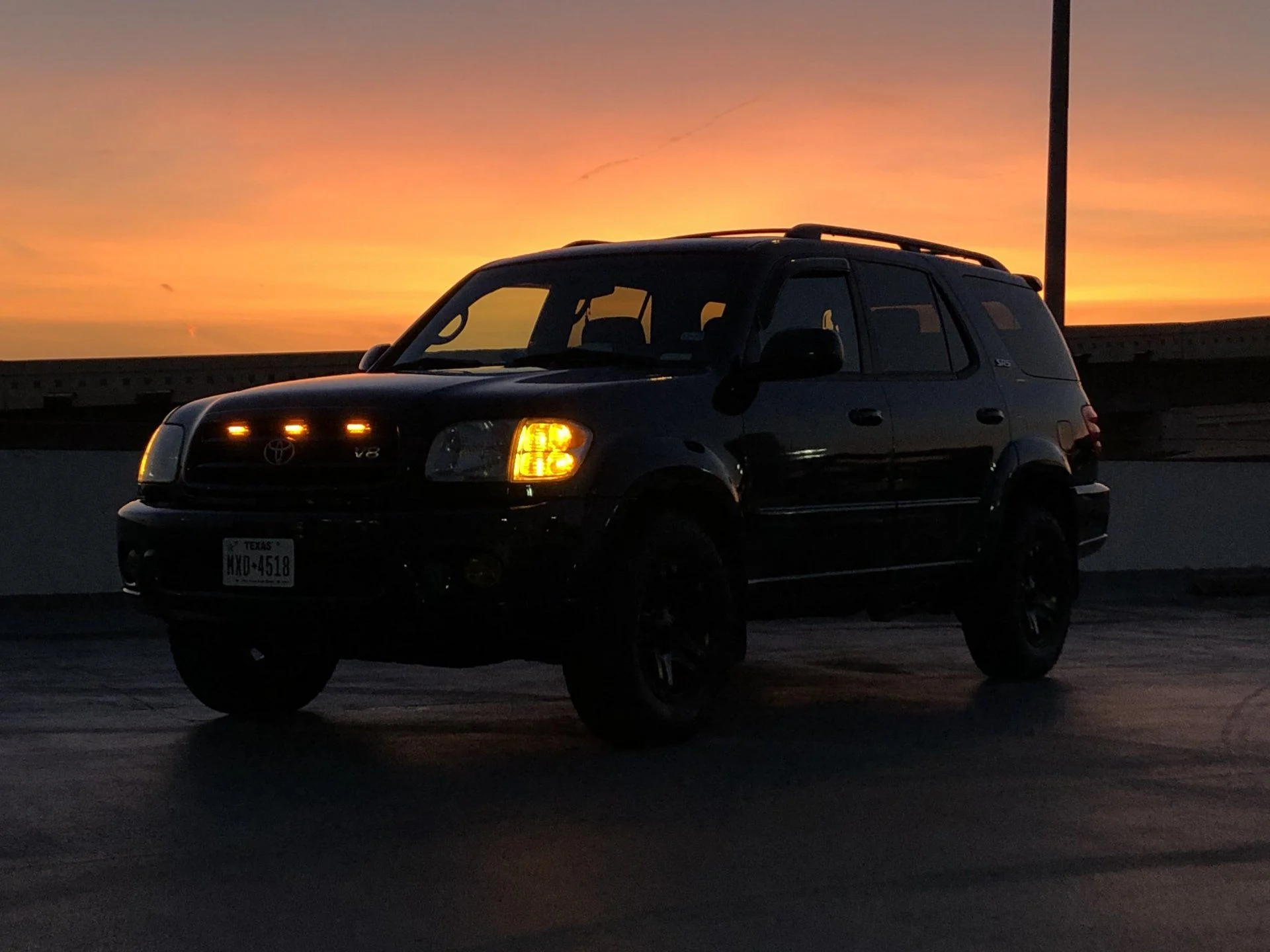

  2. Lighting. I always felt that the Sequoia lacked in the lighting department. The headlights are too dim and I wanted to address that, so I bought a set of Hella 500s and a N-Fab prerunner bar to custom fab to the Sequoia.

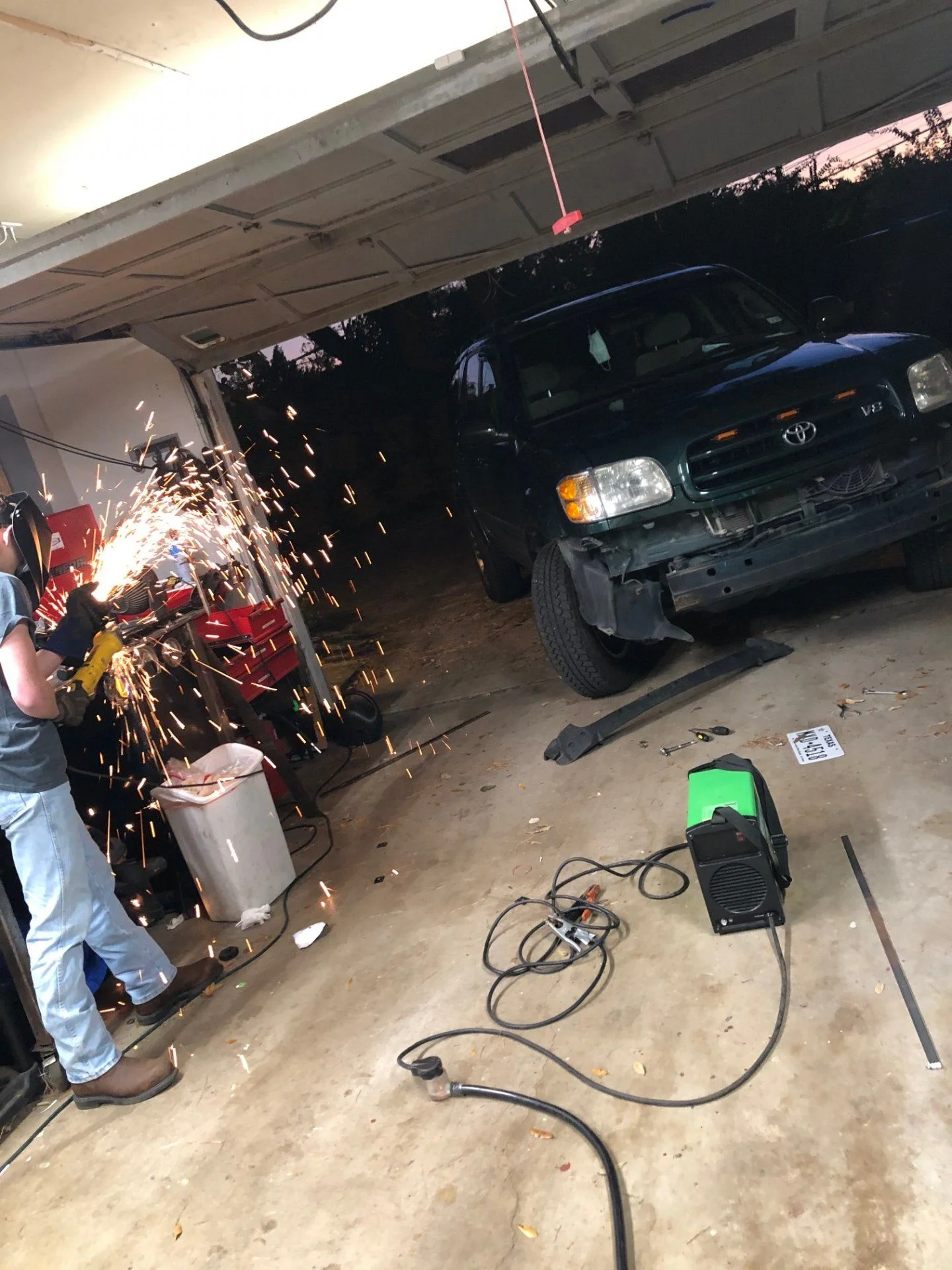

This is the light mount bar I opted to install on the Sequoia. Since it's not for a Sequoia, I had to custom make some brackets for the install. As I didn't have a welder myself, I asked a mate to weld in the brackets for me onto the bumper support bar.
Had to cut 2 holes into the bumper to fit the light mount, but the final product was well worth it.

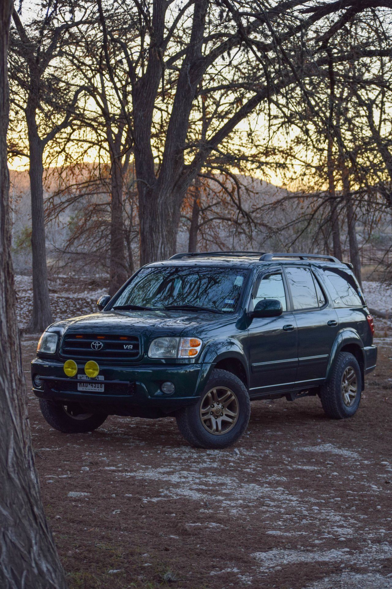

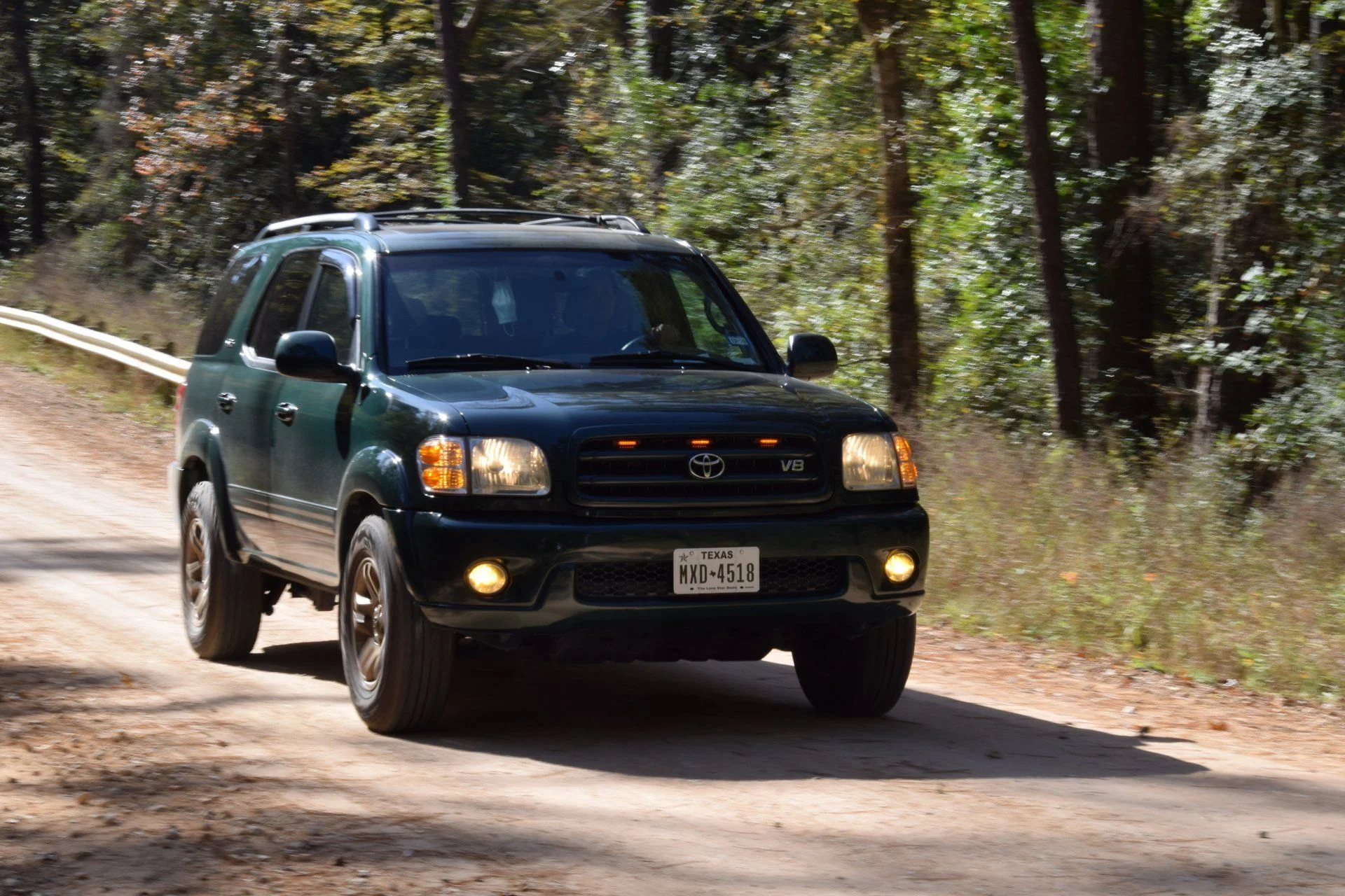

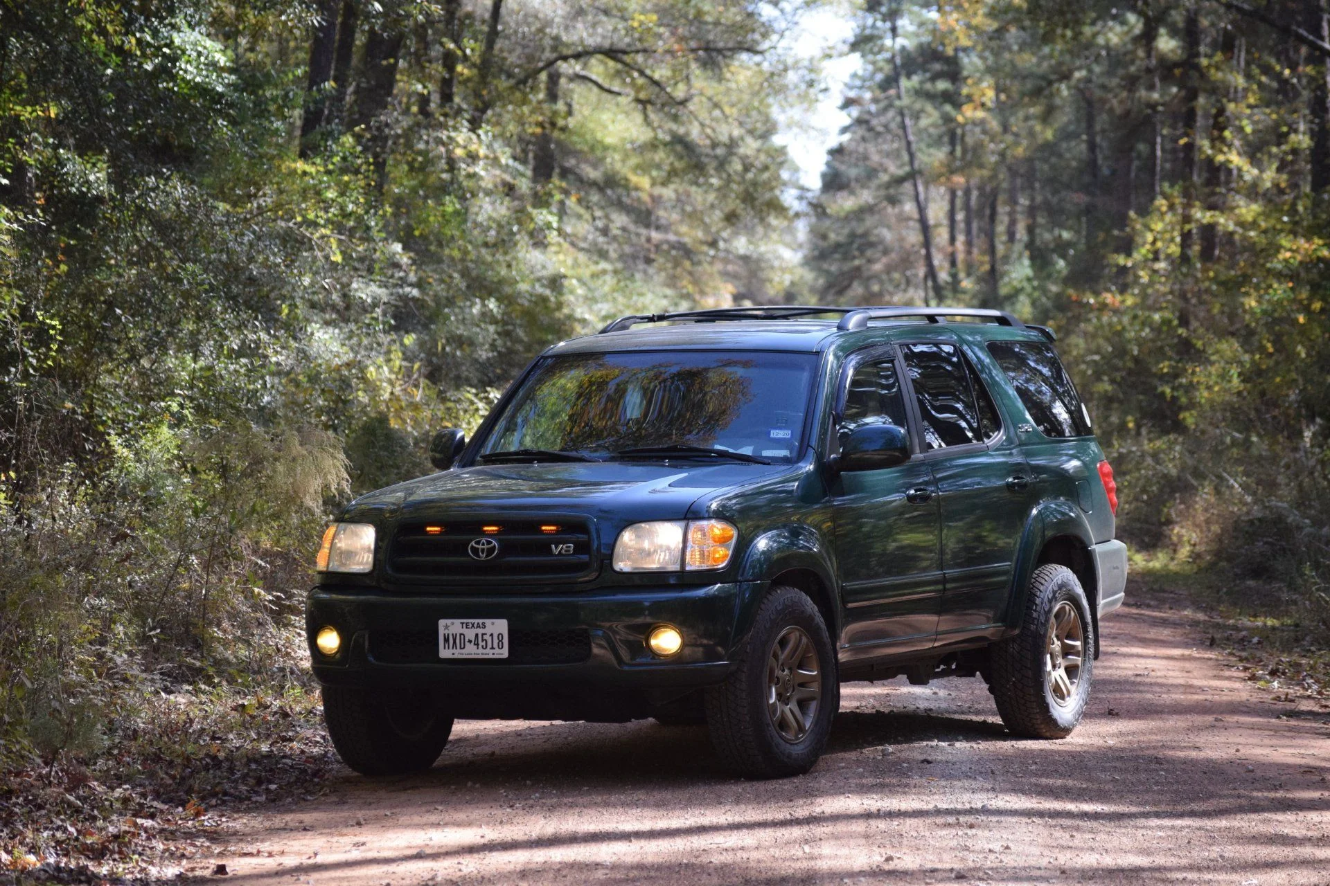

Here are some pics I took after the front level and lights install during a trip to the Hill Country:
