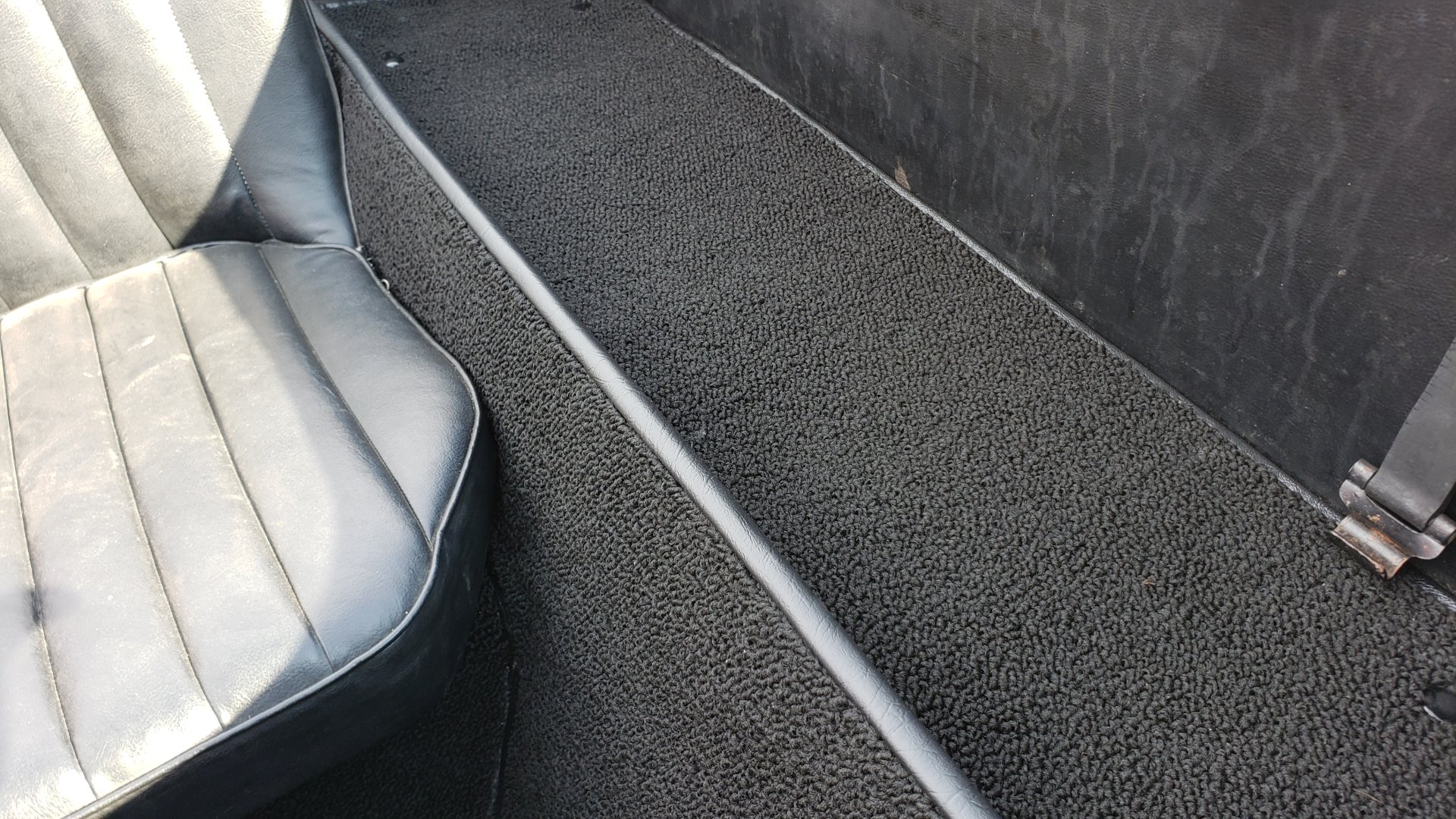

good news, carpet done. turned out excellent.
