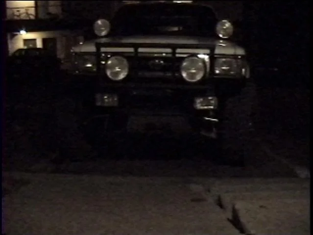

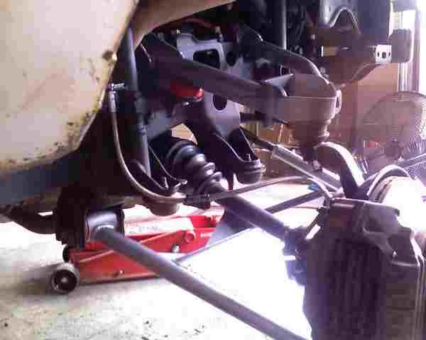

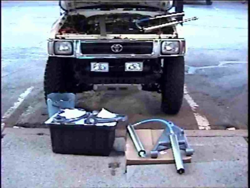

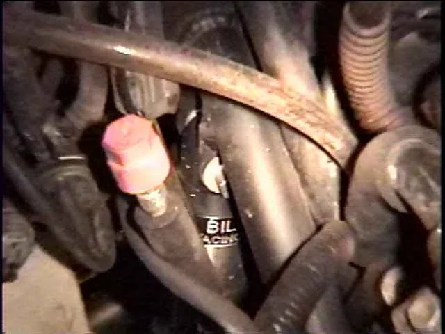

It took long enough but I've got the long arm kit installed. the biggest hurdles were the small problems. Torsion bars have a boot at the frame end and my driver's side was missing. The torsion adjuster could not be removed so the stock springs had to go back in. I'm not going nuts just yet so no problem (must be cautious turning, wrong spring rates). The point where I was going to triangulate the shock hoop got scrapped at the last minute due to inadequate tool clearance. I cobbed together a bolt-in upper shock truss but ended up warping the truss when welding in the gussets (learning here :D). It will be rebuilt, real PITA to install or remove. Also I messed up on my plan for the reservoir mount, I have a temporary solution for now.
Otherwise it's like a different truck, silent and consistent. I can't feel a damn thing driving down the roads, paved or dirt :grinpimp:. New camera next payday, I am as sick of video stills as everyone else.

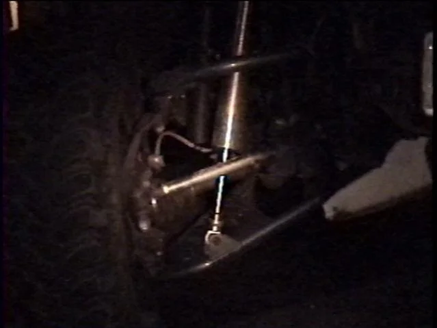

Here's the truss and a couple of overkill shocks hiding in there :eek:.

Oh yeah, if any of you SAS guys have a couple of anchor arms left over that didn't make it to the trash I could work out a deal. If they're missing the boot then it's probably seized to the torsion bar (like mine).
It's one of these (driver's side).

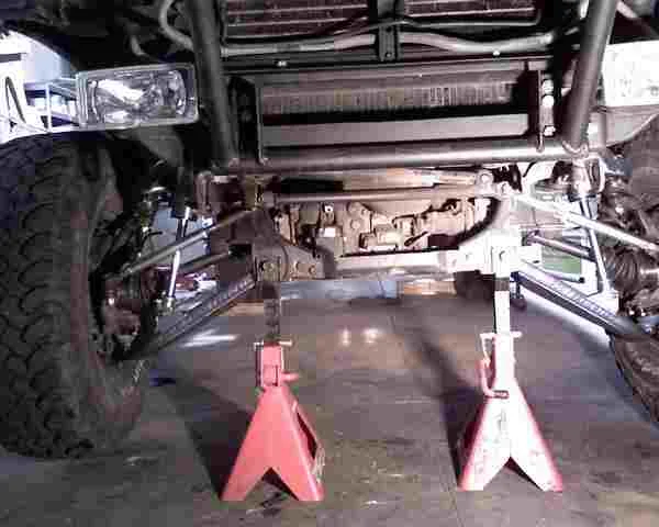

I built new shock hoops to work with my coilovers. Unfortunately I have not been successful in cleaning the threads on my used 9100s. I got the threads clean enough to work them on the bench. However the damaged areas (shock PO welding close) chew up the adjusters when setting them up on the truck.

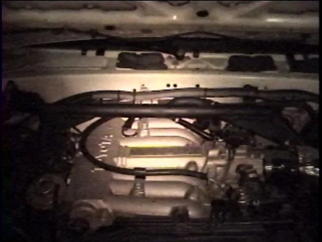

I've tubed up the front end, still need to fabricate wheel wells. The TC steering is going in next.
It is no easier to work under the hood, same junk diffrent package. The new shock placement allows more travel then I will realistically ever achieve even with all spherical bearing uber joints or whatever nonsense :D.
