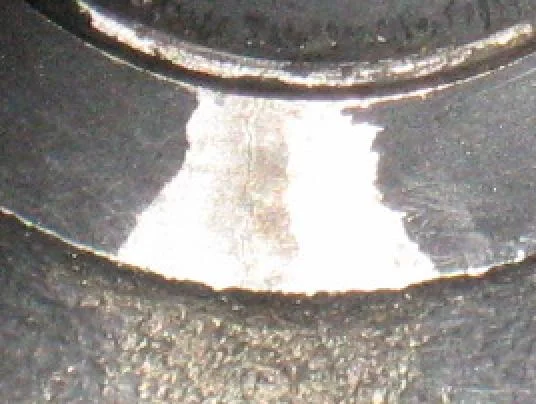

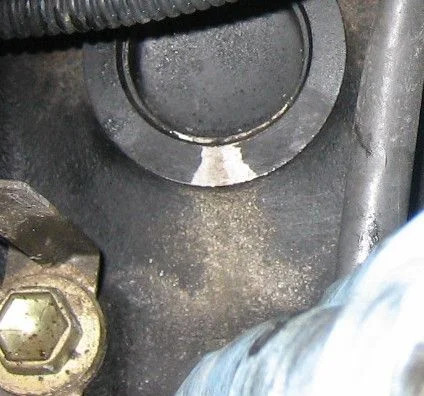

Well I really appreciate all the responses to my little Crack Thread ;p. Just so this thread has some pics (before my own before and after pictures of the repair), I'm "stealing" these pics from NewbieNate and his thread back in '06. My crack (from what I can tell) is not on the outer ring of the casting around the freeze plug like the first pic, it's directly directly below it, exactly where Nate has cleaned the crud off his block (don't think his crack extended down that far). Not sure who's situation was worse--or maybe they suck equally as bad? I'm thinking his might have been worse since it's closer to the "fragile?" freeze plug? Here is the thread reference: https://forum.ih8mud.com/80-series-tech/116636-leaking-freeze-plug.html
