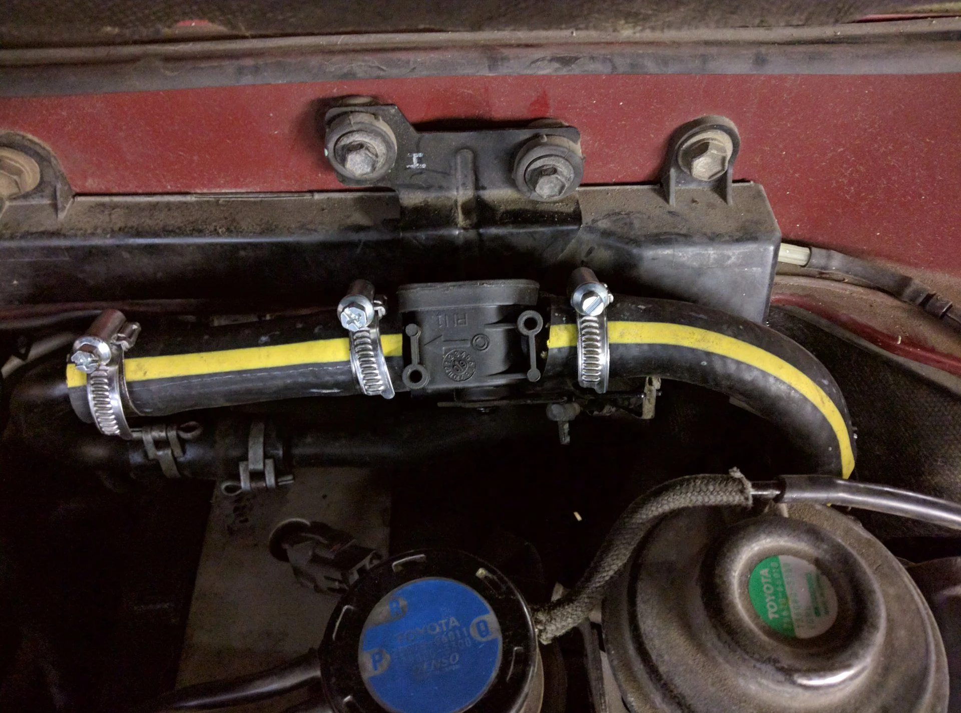

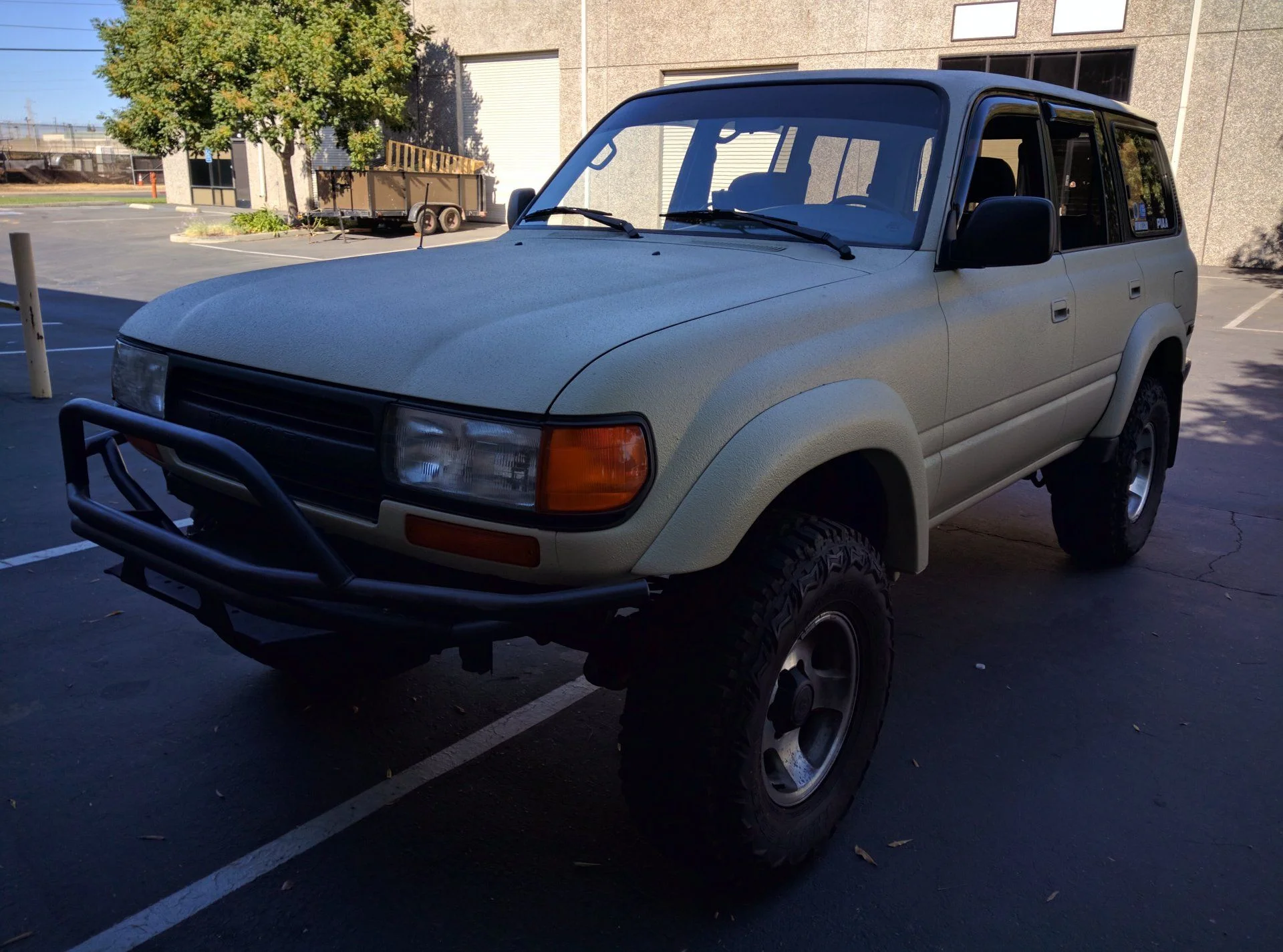

Got a couple projects taken care of today. Replaced the iffy looking heater valve and the two hoses that connect to it and also upgraded to brighter LED's for the license plate lights. I also finally got around to taking a picture of my Trail Gear bumper I got a few weeks ago.
Old heater valve, the hose that connected to the right hand side was loose. How this hasn't been leaking or explode on my trip to SoCal and back I have no idea but I'm thankful it didn't.

New heater valve with fresh Napa Gold Stripe hoses. The other hoses seemed ok so I'm leaving them alone till I do my PHH when I have more time.

New Trail gear bumper. This made for an amazing working platform to stand on while I replaced the heater valve.

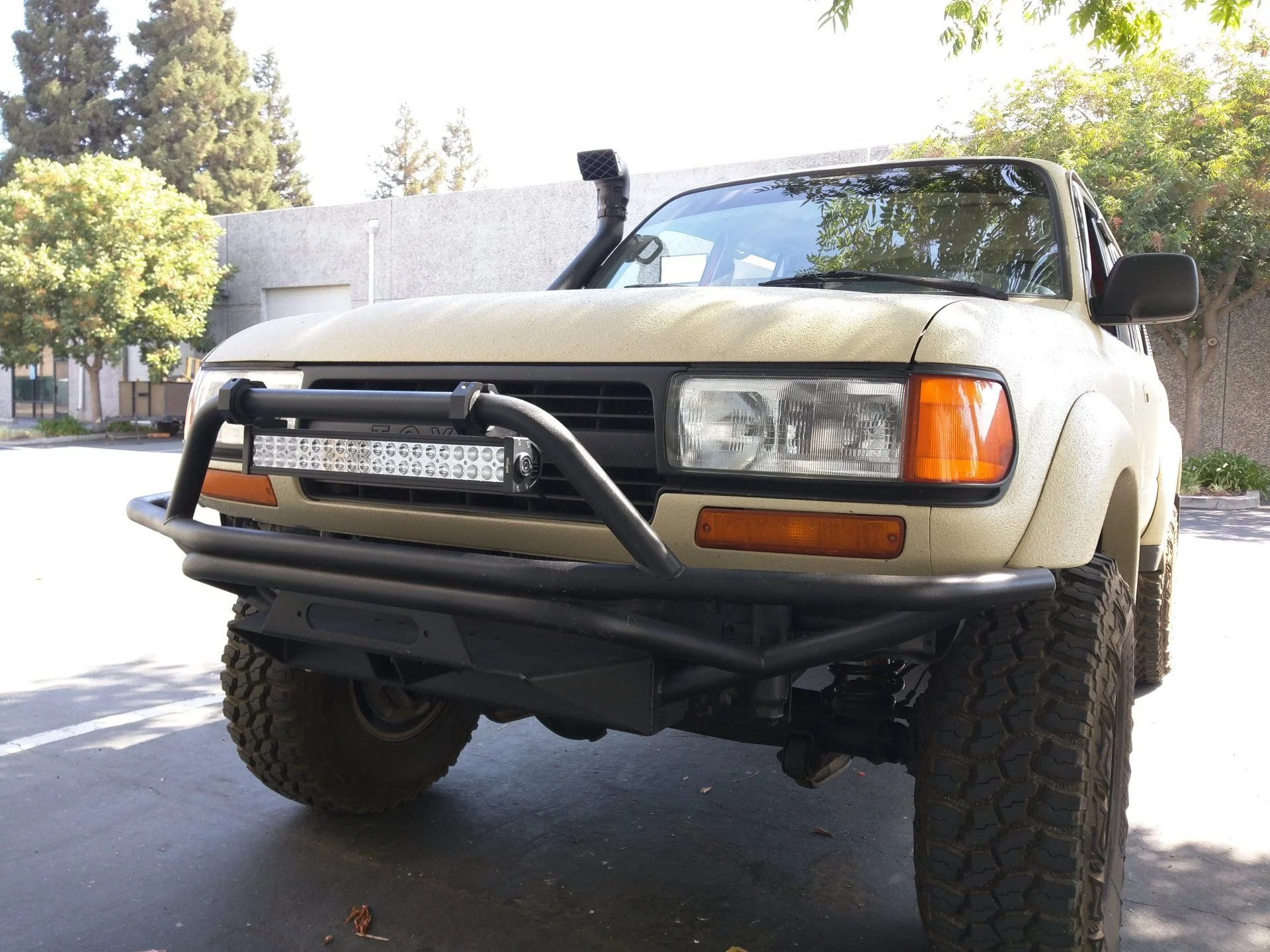

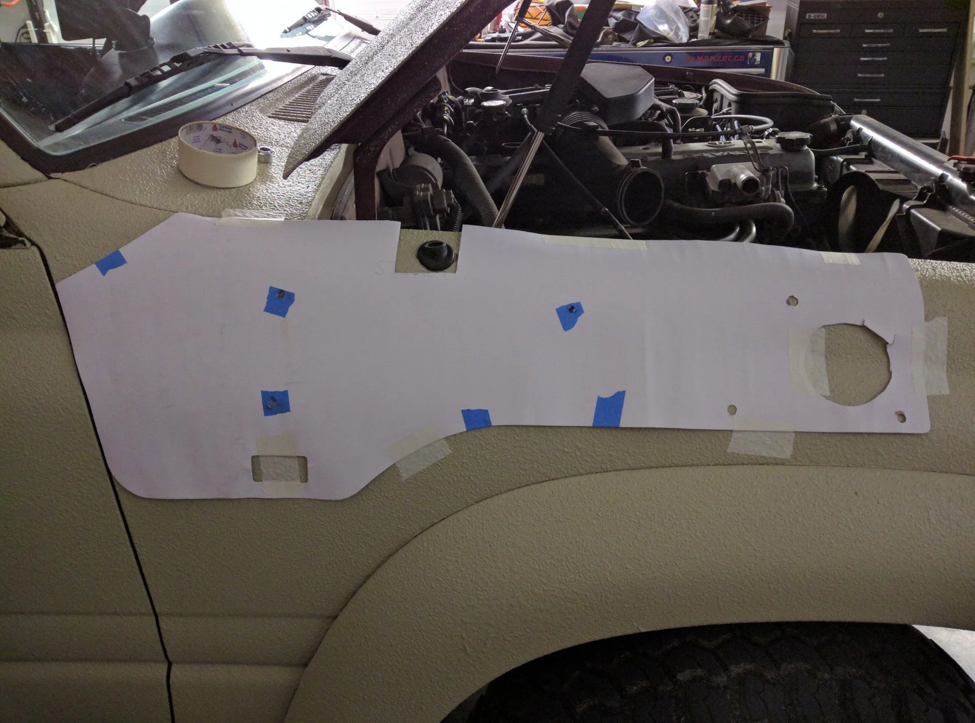

Got my snorkel installed yesterday. Took longer than I hoped, about an hour 45, but almost a half hour of that time was fighting with my rivet gun that decided it didn't want to work correctly halfway into the first rivet. For me the hardest part was the rear upper nut closest to the cowel. I don't know if it was just the size of my arm or what but I just couldn't get the nut started so I left it off. Drilling the holes was pretty straightforward, I used a step bit so I wouldn't have to constantly change bits to get the holes the right size so the snorkel would fit. I painted all the bare metal around the holes then covered them with RTV before final fitment of the snorkel to hopefully eliminate rust from starting.
Pattern in place.

Completed.
full
Dude, great job that looks pretty sexy. Especially good job on the platform fitting.

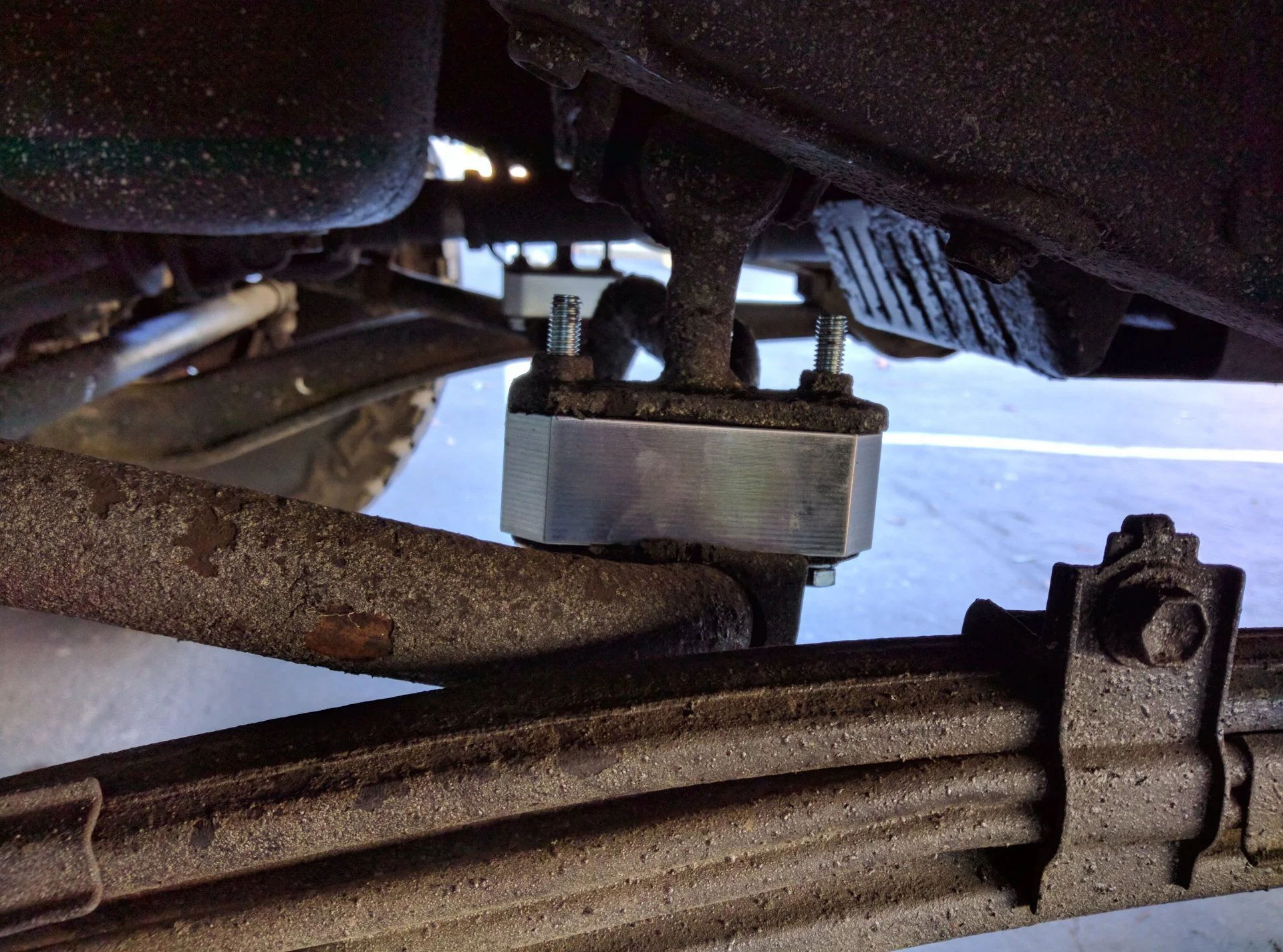

Installed my swaybar drop brackets yesterday. I got them from @Hitit66 pretty easy install, don't really notice a difference driving around but that's not why I installed them. I installed them to be able to use my front swaybar quick disconnects and to keep the drive shaft from rubbing the swaybar when disconnected. My local home depot didn't have the length bolt I wanted to use, I wanted 55mm but they only had 50mm then jumped to 65mm. I didn't want to come up short so I went with the 65mm ones.
