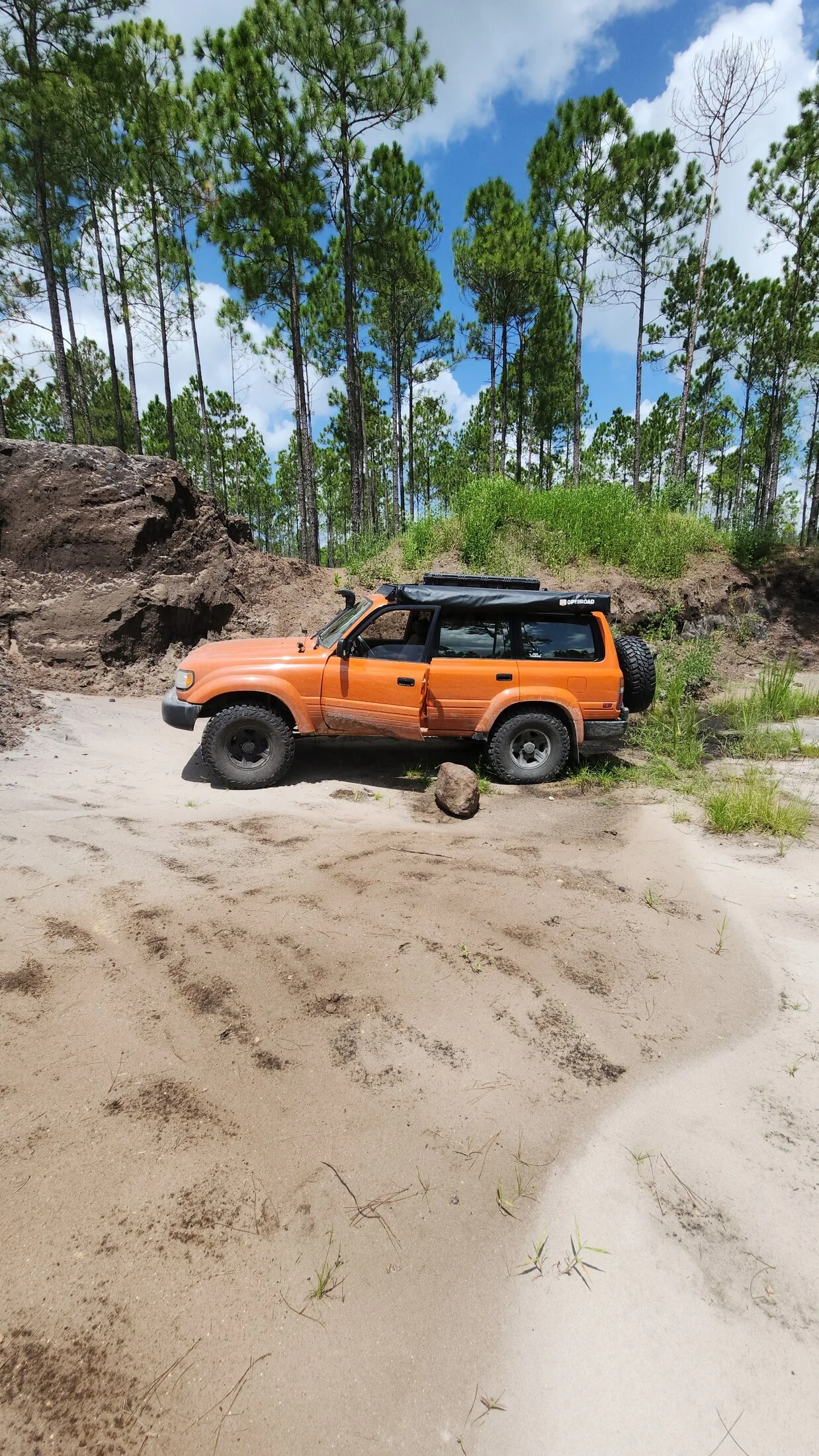

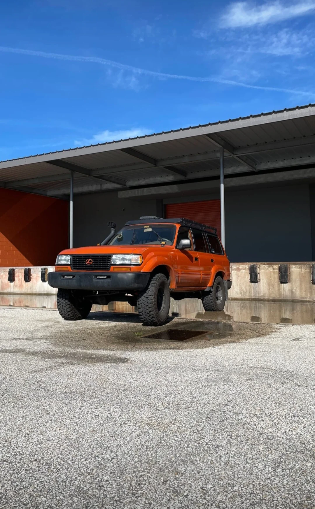

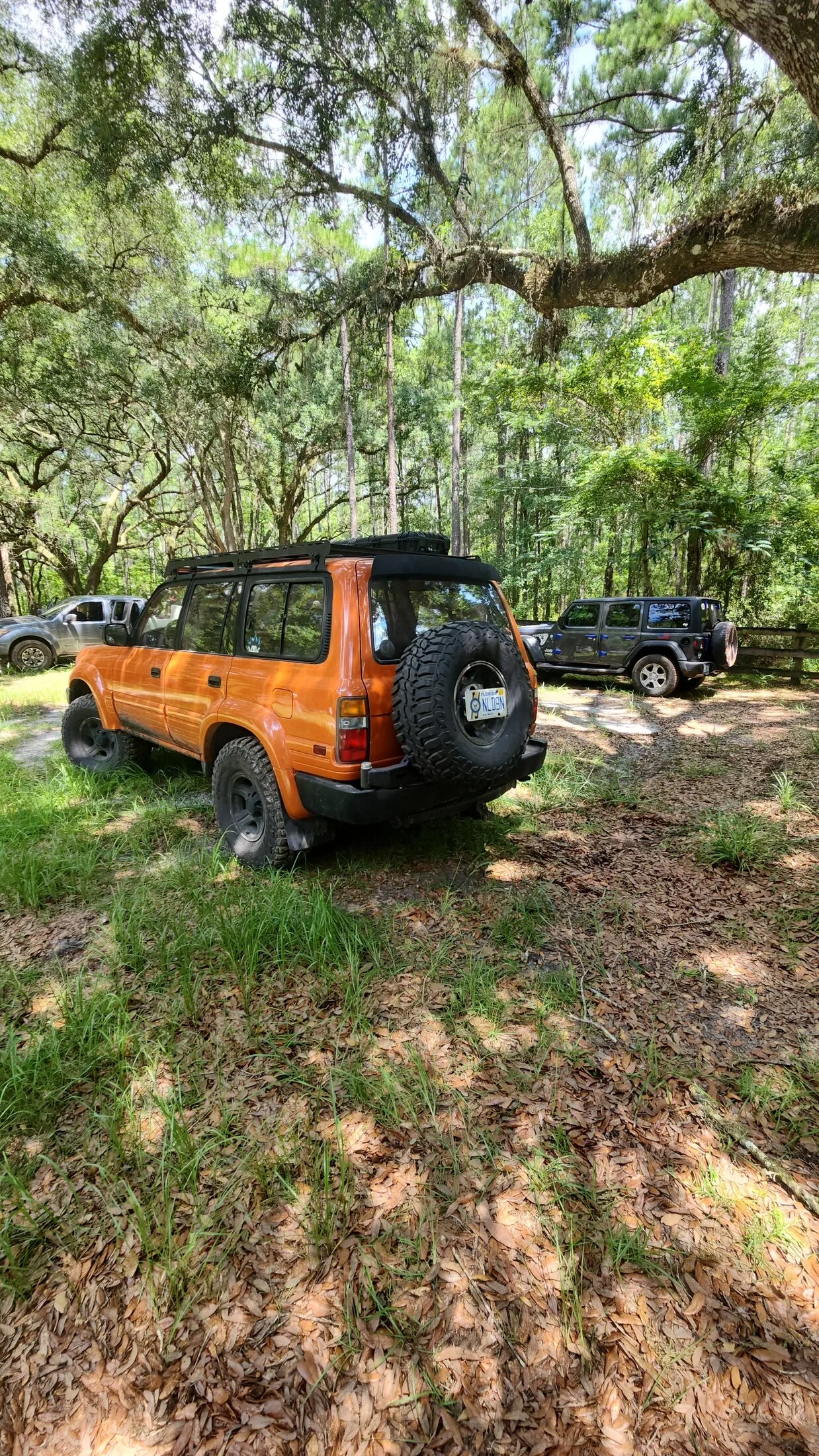

Cant stop getting conpliments:
I seriously get weird looks when I either get in/out or on the road. Often get honked at followed by a thumbs up. Oh well
Adding a 200 series next year so that I can start doing road trips with the wife and kiddos.
