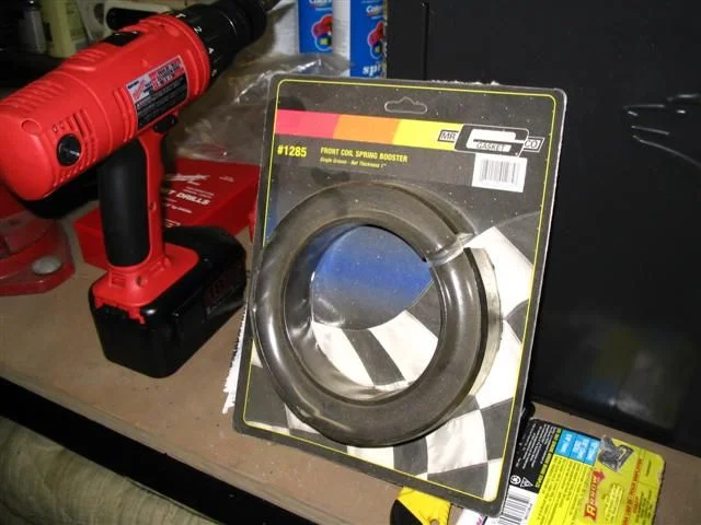

I thought i saw a set of those laying around somewhere... :flipoff2:

The Mr. G spacers worked great. You could also use MFE's 25mm spacers (not advertised, but ask them).
