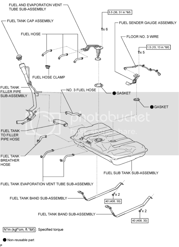

I never realized this... "It’s worth mentioning that Australian-spec Land Cruisers come standard with an 11.9-gallon auxiliary tank". Anyone have any details of where it's located and how integrated it is?
It's been discussed before. I think it squeezed in under the spare tire. I'm still waiting for someone to start importing the OEM parts to make it an "off road" only mod since its not DOT certified.

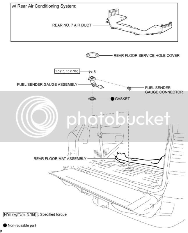

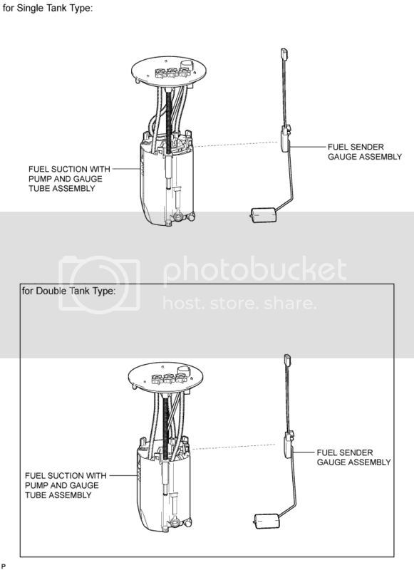

Yes, located above spare wheel. You also need a slightly different suction pump and sender unit as shown below as it sucks the fuel from the auxiliary tank via a venturi effect. Other than that the good news is that your main tank is configured and ready to connect with auxiliary tank.

Only problem is the US 200's have components installed were the aux tank goes for emissions like the Carbon canister that would need to be removed. Like DT255 you can buy a complete setup from Long Ranger in Australia, but it will take a lot of work to modify the US 200 series to fit. he discusses it in his build thread. You can find that in the last section of the 200 series FAQ
