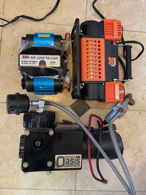

I happen to have these compressors. I have a bit of a compressor fetish 🤣 The Morrflate/Maxi-Trac compressor is quite large.
Damn man and at one time I had 3 ARB twins and an old Pep Boys M?-50. Like your style
