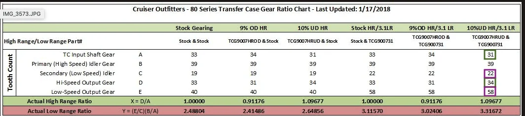

If you're not experiencing actual power loss, but just coming to terms with the sluggishness of these rigs with bigger tires, I can't recommend a transfer case regear enough. I finally regeared mine last year, after 12 years of ownership, and I feel like a fool for waiting so long. I should have done it as soon as I got the truck and put sliders and 33's on it. It's makes a tremendous difference, I couldn't be happier.
That sounds like it may do the trick. Can you give me a little info? Did you rehear it to stock or change to accommodate tires? I don’t know much about gear boxes. Ha.
Here's a great thread about it:
If you do it as a DIY project, it is not for the faint of heart. Also check out the Timmy the Toolman 4 part video series on YouTube with Georg from Valley Hybrids. I did the low and high range gears. It's the biggest improvement I've made to my rig, for sure.
