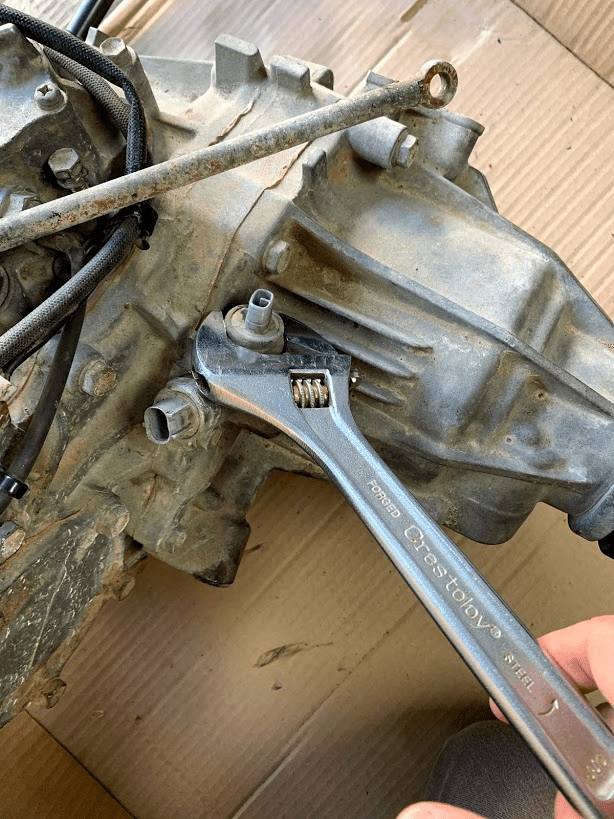

Some notes from dropping the transfer case--most of the instructions advise you to leave the front housing in place and crack the case open with it on the truck...but most of the people who have done the job say drop the tc entirely. I decided to drop the case...so far, not regretting that decision. It wasn't as straightforward as I wanted it to be, but not too bad. Pulling the driveshafts was kind of annoying as I had to jack up each in order to rotate the shaft for access to the bolt plate, but only added maybe 20 minutes to the process once I realized what the issue was.

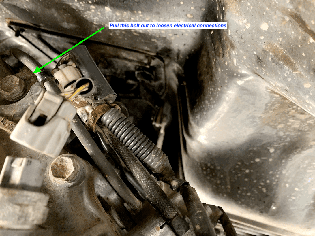

The electrical connectors on the transfer case are a bit challenging, mainly because they are bolted down in ways that aren't obvious at first glance (particularly two connections near the top of the case.)
Some pictures attached to help others.

It was at this point I found one more electrical tie-down by the diff motor that I had to disconnect.

I couldn't figure out what size that nut was (my metric sets stops at 24mm) but they came out super easy with a crescent.

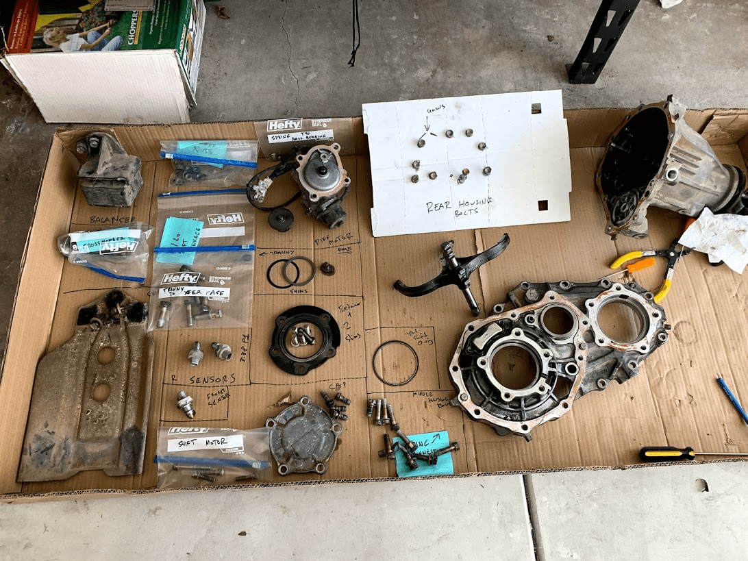

I know I may be overdoing it with the pictures but hopefully it helps others.
Pulling out the ball after the spring came out.
Separating the rear housing was simple, I made a cardboard template for the bolts since they aren't all the same length.
Also wanted to document the shim order on the input shaft.
Now on to removing the bolts for the middle section of the housing ("rear case" vs "rear extension" in the FSM.)
This is also pretty straight ahead, only thing is I noticed two of the bolts had washers on them and the rest didn't so I took a note of it. Sorry for looking like a toddler wrote the word "Extra"--my sharpie had some oil on it lol.

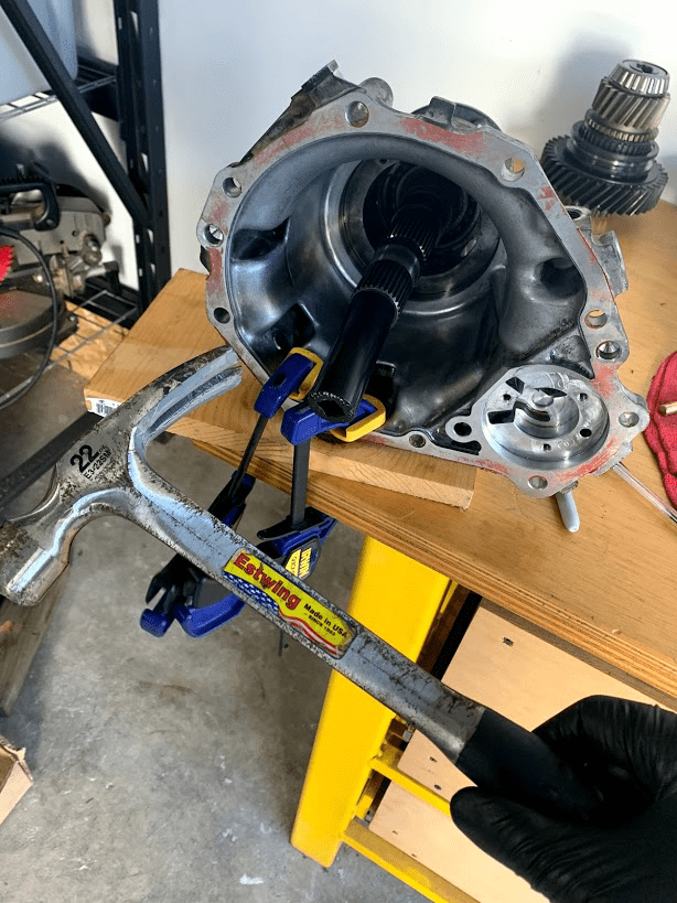

Now remove the large snap ring on the input shaft and pull the case.
And here is where I got stuck for over an hour as I couldn't get the input shaft to slip through the case the way it was supposed to. Finally after much cursing and playing with it I was able to pull the small snap ring and somehow that made it all fit through, even though I can't actually figure out how those parts relate. Thanks to @ArmyFJ for his help and suggestions.

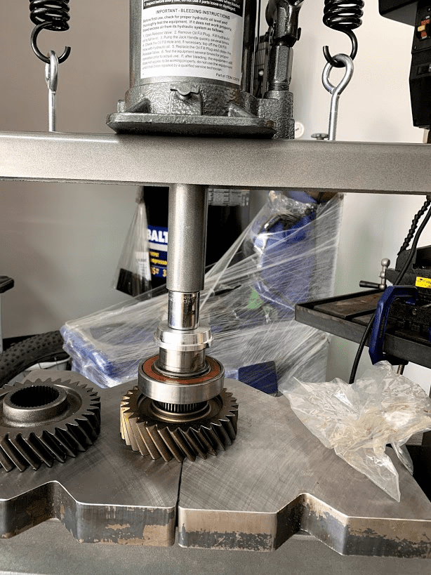

And now pressing on the new input gear (part of the 10% underdrive, this goes from 33 tooth to 31--see first post.)

I lubricated the bearings and pressed on the new gear (idler low gear goes from 22 to 19 tooth.)

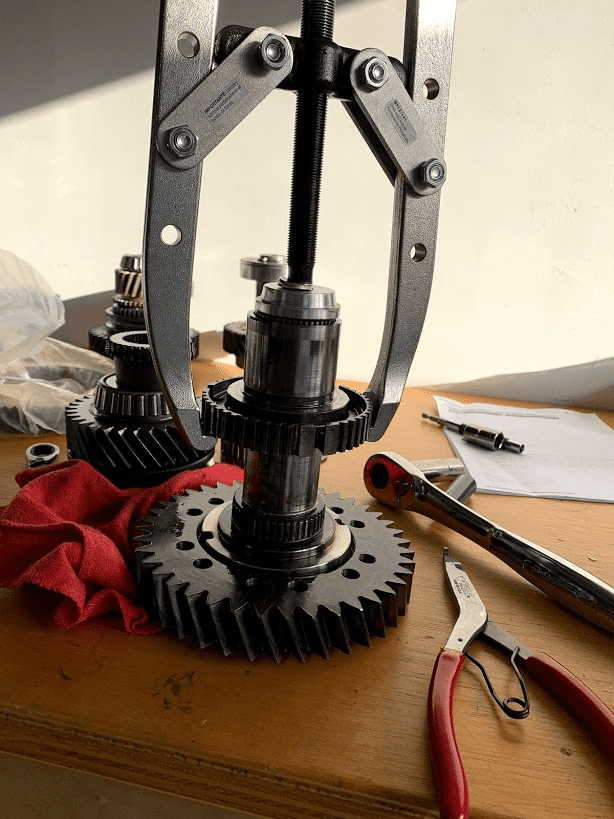

On to the jaw pulling. I didn't really like this part, but it worked OK. I think if I have to do this again I'll try to figure out how to do more on my press and less with the two-jaw, but it did work OK. One note that seemed weird to me, for this step you attach the jaws to the clutch sleeve (hold it up against the high speed output gear while you clamp the puller.)
OTRAMM shows the next pull as the low gear taking the clutch hub and gear bushing with it, but that didn't seem to work for me--or at least, it might have, but after a short while the low gear was fully loose while the clutch hub was still on tight. I decided to do a third jaw pull from the clutch hub, which took the hub and the bushing off the shaft, at which point the low gear slips off the hub easily. YMMV, just sharing that three jaw pulls vs two seemed better to me.
This was the third pull.

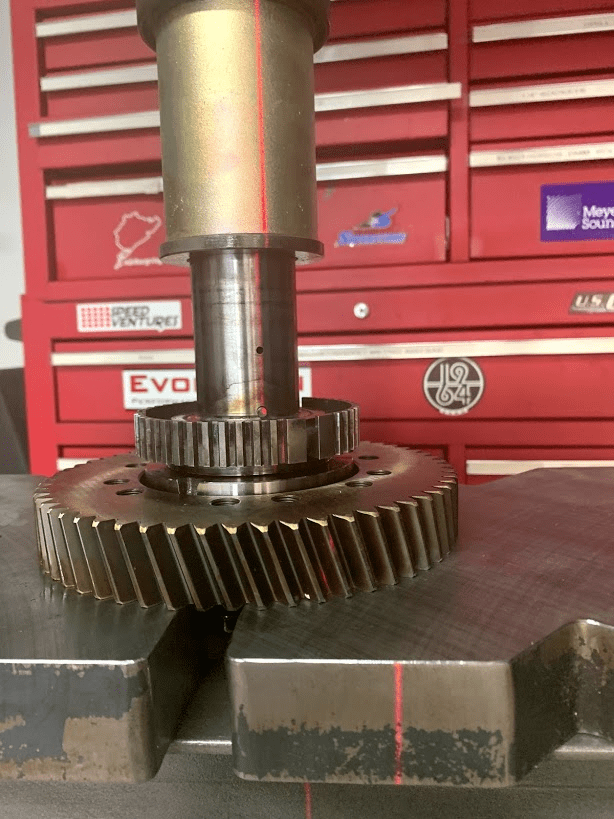

OK, on to reassembling the center diff. I put two placeholder bolts into the new low gear to keep it aligned on the spindle/hub thing ("differential front case" in FSM) and then pressed in the clutch hub. OTRAMM does this with a brass drift, he must have a magic touch as it didn't work for me. Didn't take much press pressure so hopefully all OK. I used two sleeves from this kit I bought (kinda more than I needed tbh, but with the current Covid19 situation I was trying to avoid hunting down random stuff at the hardware store as everything seems to involve waiting in line for a long time.)
With the clutch hub in place I could easily see the straight pin for aligning it to the gear bushing.
Then I used a laser level to make sure everything was aligned prior to pressing it in.
(Looking up from underneath I could see that the laser was hitting the slot for the straight pin in the bushing.)

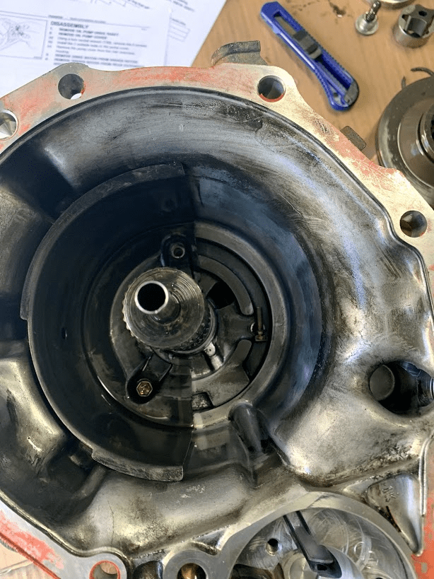

OK, mild disaster ensued when I tried to do the rear extension housing. Will show details a few posts down.
Went along OK for the most part following the FSM, only a few "gotchas."

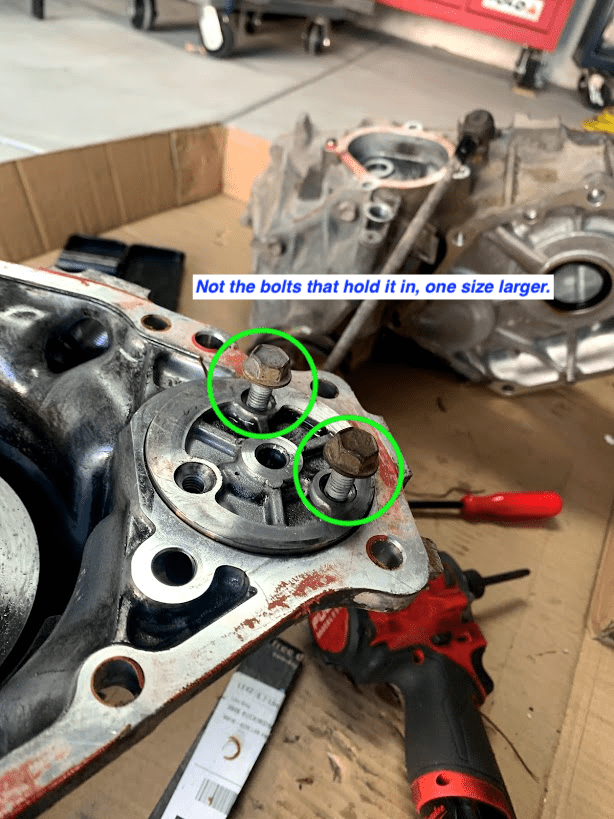

I didn't realize at first the "suitable" bolts aren't the bolts that held the oil pump cover in, they are one size larger. (14mm head)
Lock ring 1. A real pain with the pliers I had, I ended up grinding the head of the pliers down to fit more easily.
Oil slinger (?) came out easily. The pump plate behind it was a pain.
Finally got it out but took a lot of wiggling around and getting stuck, tapping it back down, then walking it back up by hand w/ a pick and my fingers through the sensor hole below.

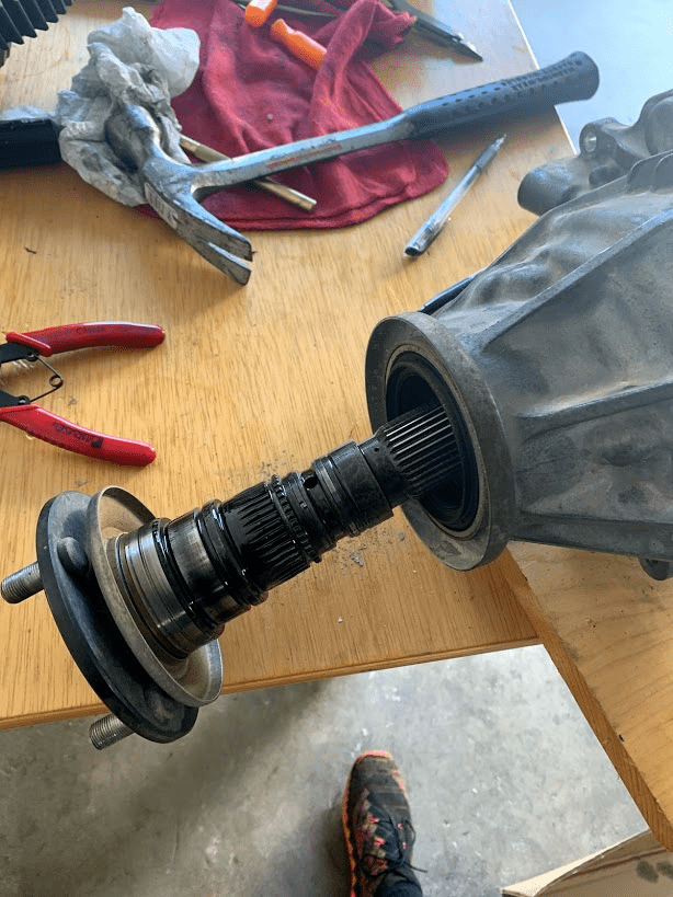

Lock ring 2--took me 45 minutes to get out. Ugh.
Lock ring 3, not so bad.
Emulating SST 09325-12010 with a 19mm impact socket, seemed to work fine.
Shaft free
New seal and bearing ready to go in.
Lock ring #4 (screwdriver removal as per FSM)

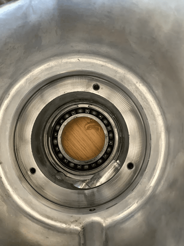

Ready to press out the old bearing. Here's where things went south.
It seemed pretty hard, then "BAM" and it looks like I took out a piece of the housing. I'm not sure if this was seized up or if I used one size too big on the sleeve for pressing (looked right but maybe I caught the edge of the race instead of the bearing)? Aargh.
And then this happened. :cry:
